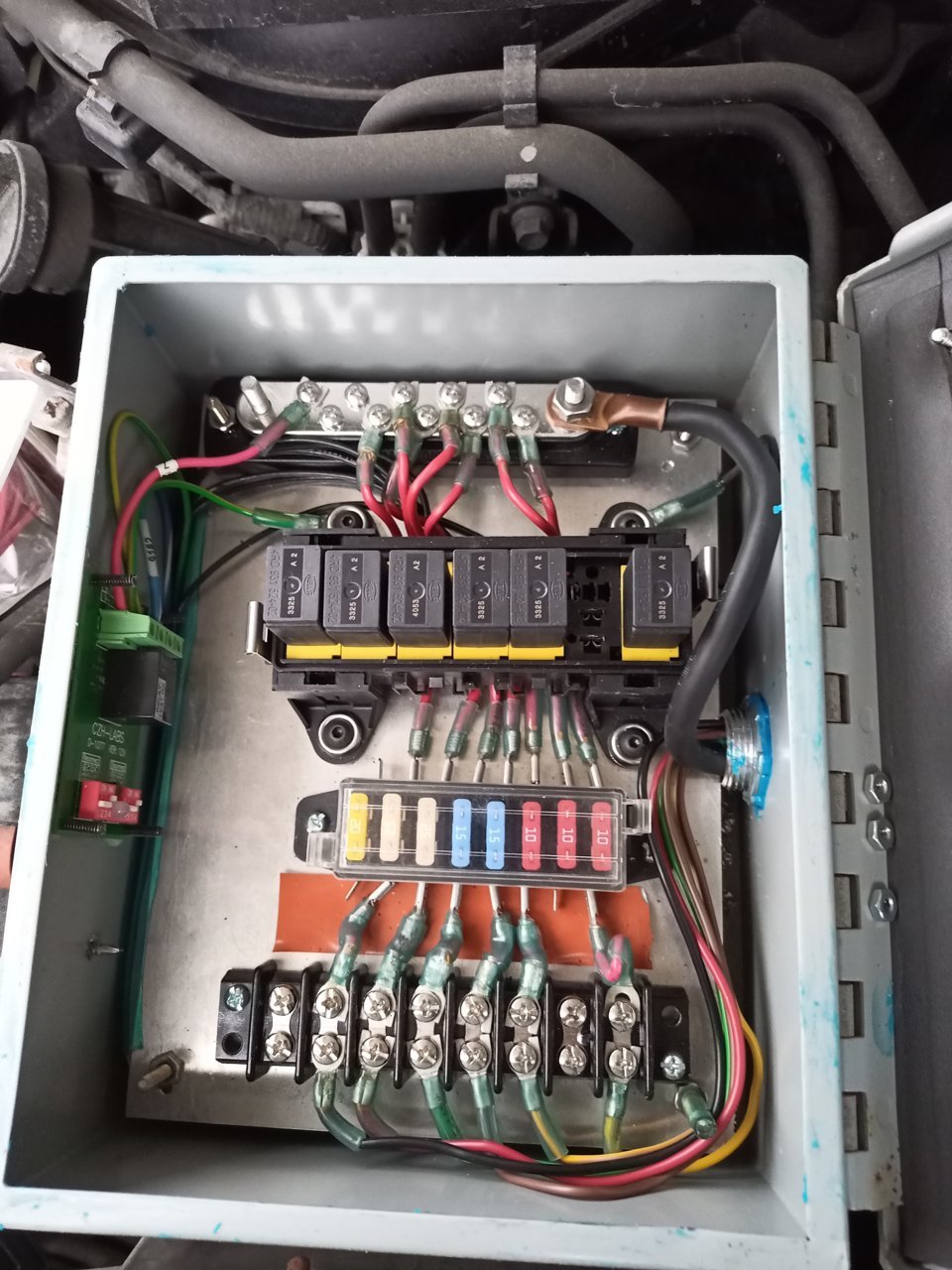

    It took 3 years to die. I have it supplying power to my switches, that in turn switch relays. If all my switches were on I might be pulling an amp through that board.

    If that’s the case then I’d treat it like a weak fuse and carry spares. The rating seems to be mistaken. I like how you implemented it.

    I have it set up so I can bypass the chip if it dies in an inopportune moment. . . Thank you, I spent a few days talking with the electrical engineer I work with about how best to set up my panel.

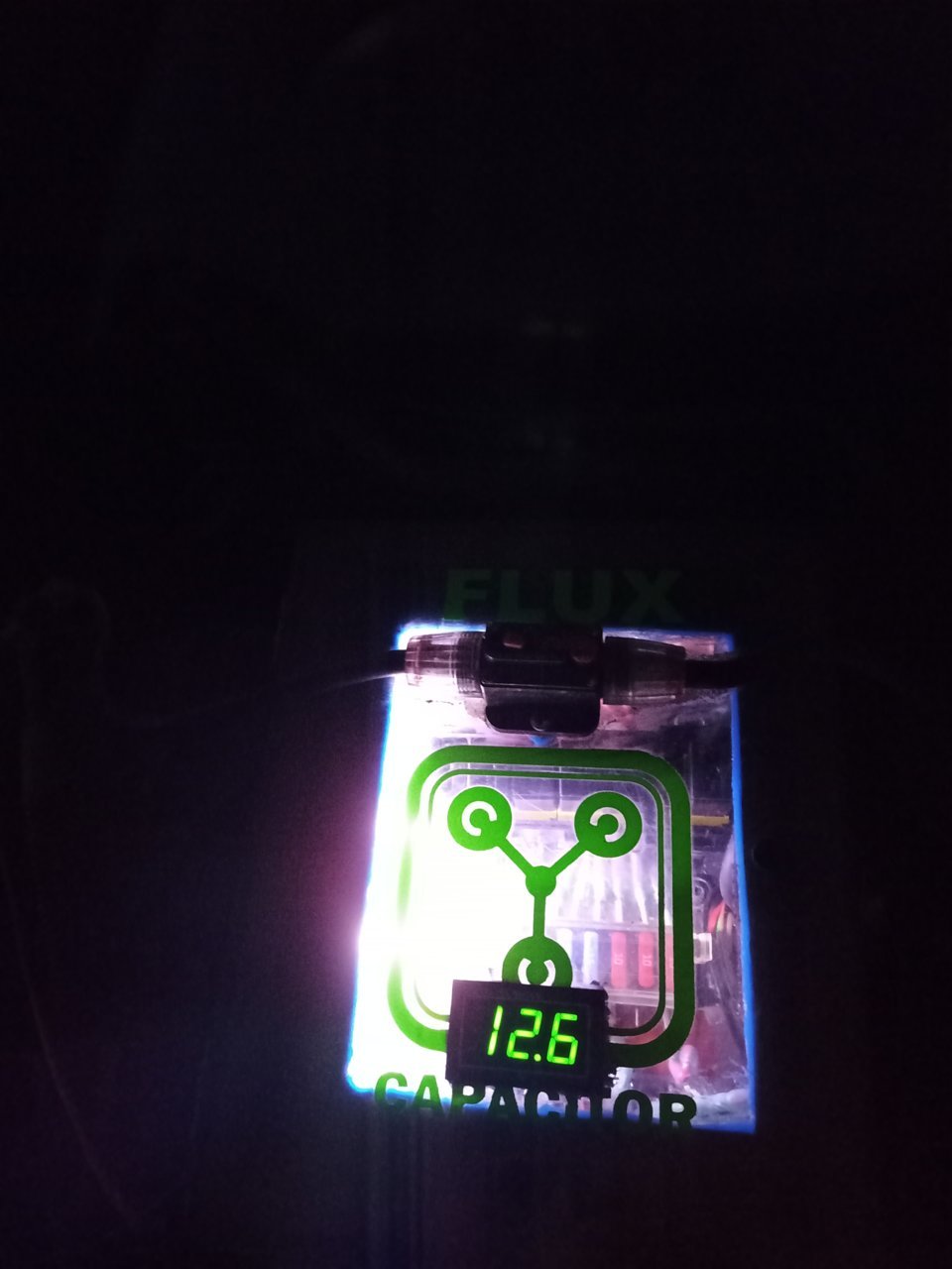

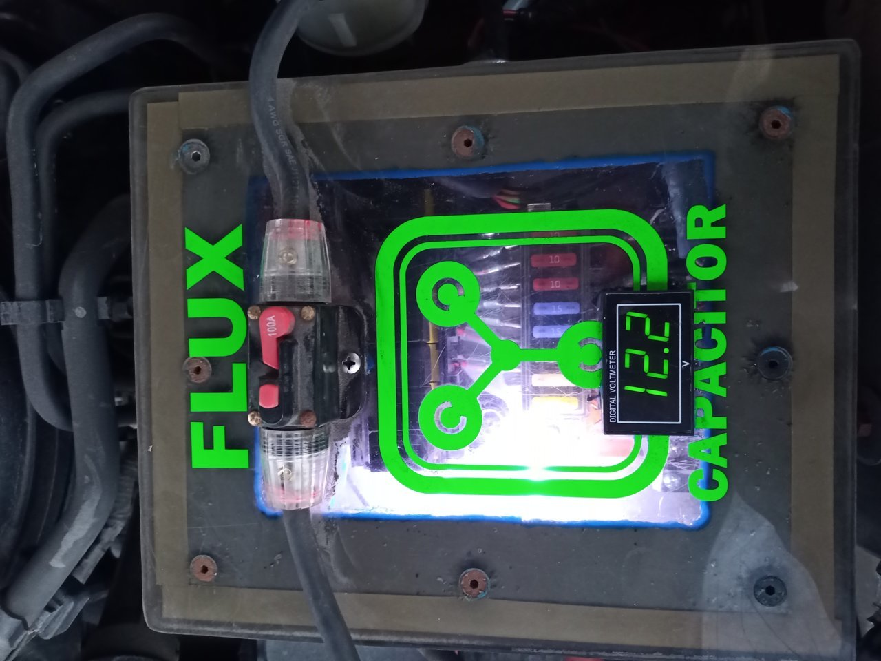

    IMG_20210225_174638.jpg new chip installed along with some cosmetic up grades. Interior lighting and a volt meter.
