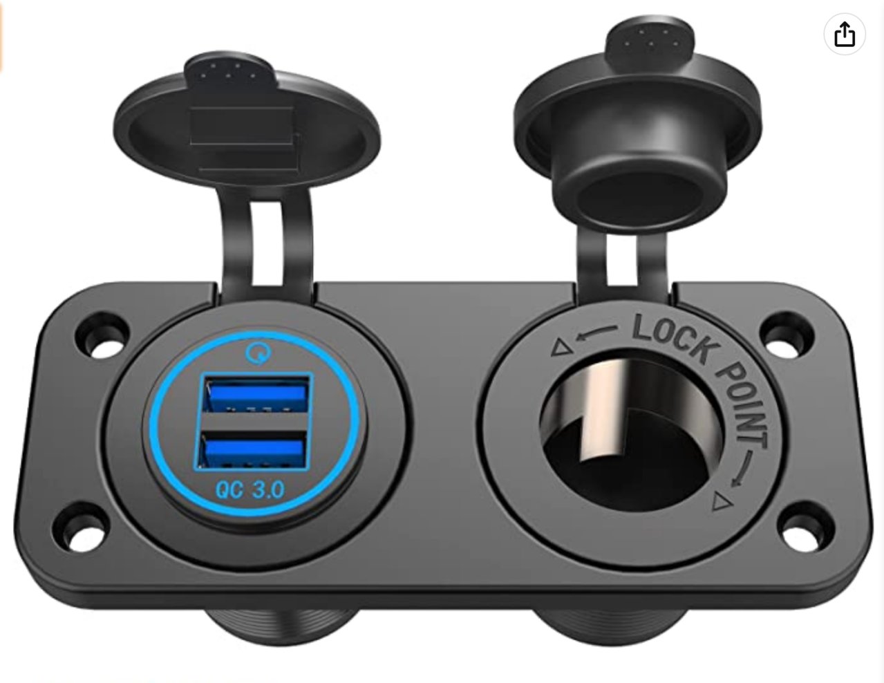

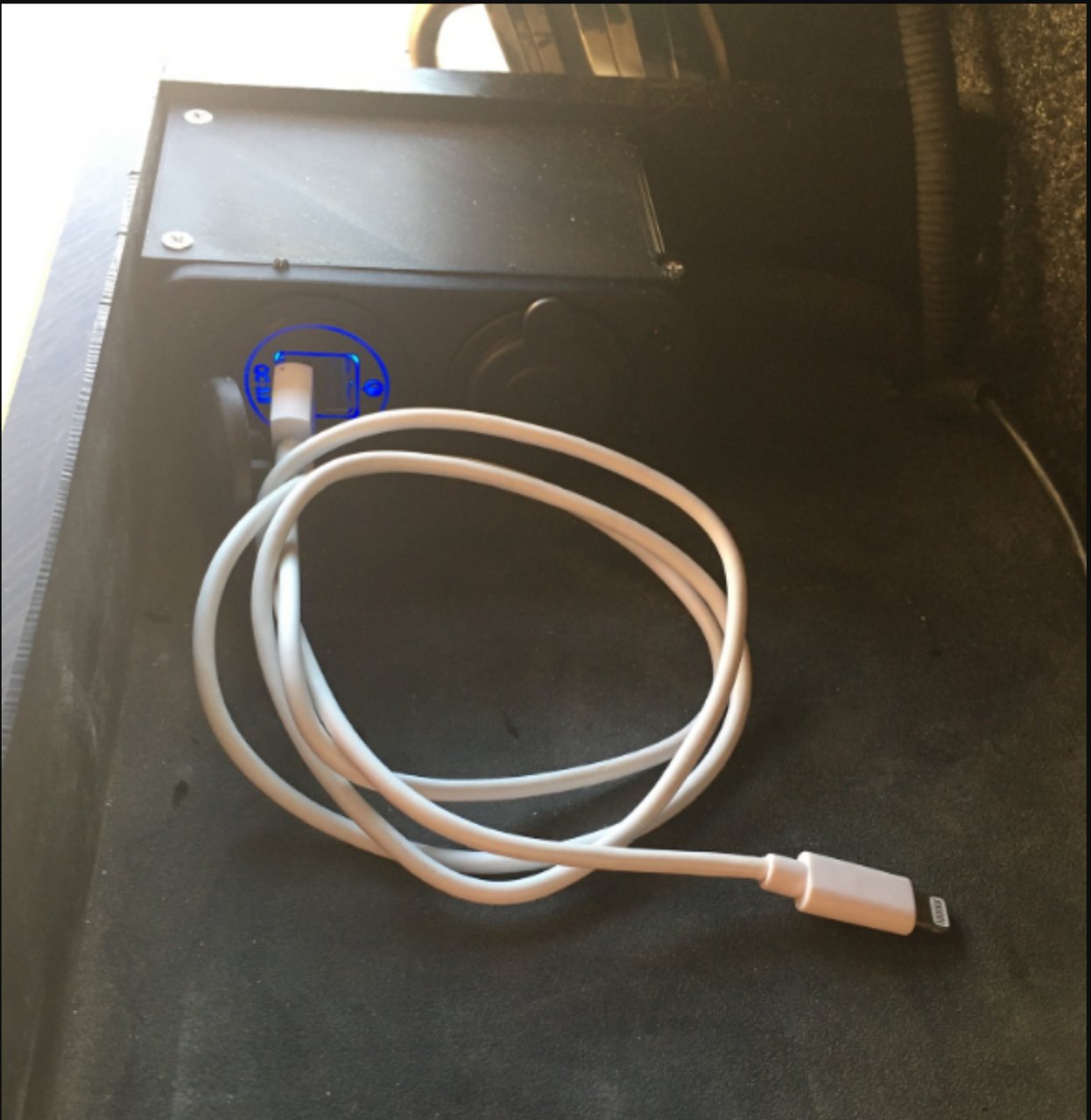

    I made a small box for the 12v cig outlet and two USB ports using this part from Amazon
    https://smile.amazon.com/gp/product/B07RHY97ZZ?ie=UTF8
    It is mounted at the end of the side shelves near the tailgate.

    Do you think your side cutout boxes might have enough depth to clearance a USB/12v outlet?
  4. Feb 1, 2023 at 5:34 PM
    #1704
    switch
    switch Well-Known Member
    Oct 12, 2009
    #24216
    499
    Norther California
    2022 Tacoma Access Cab

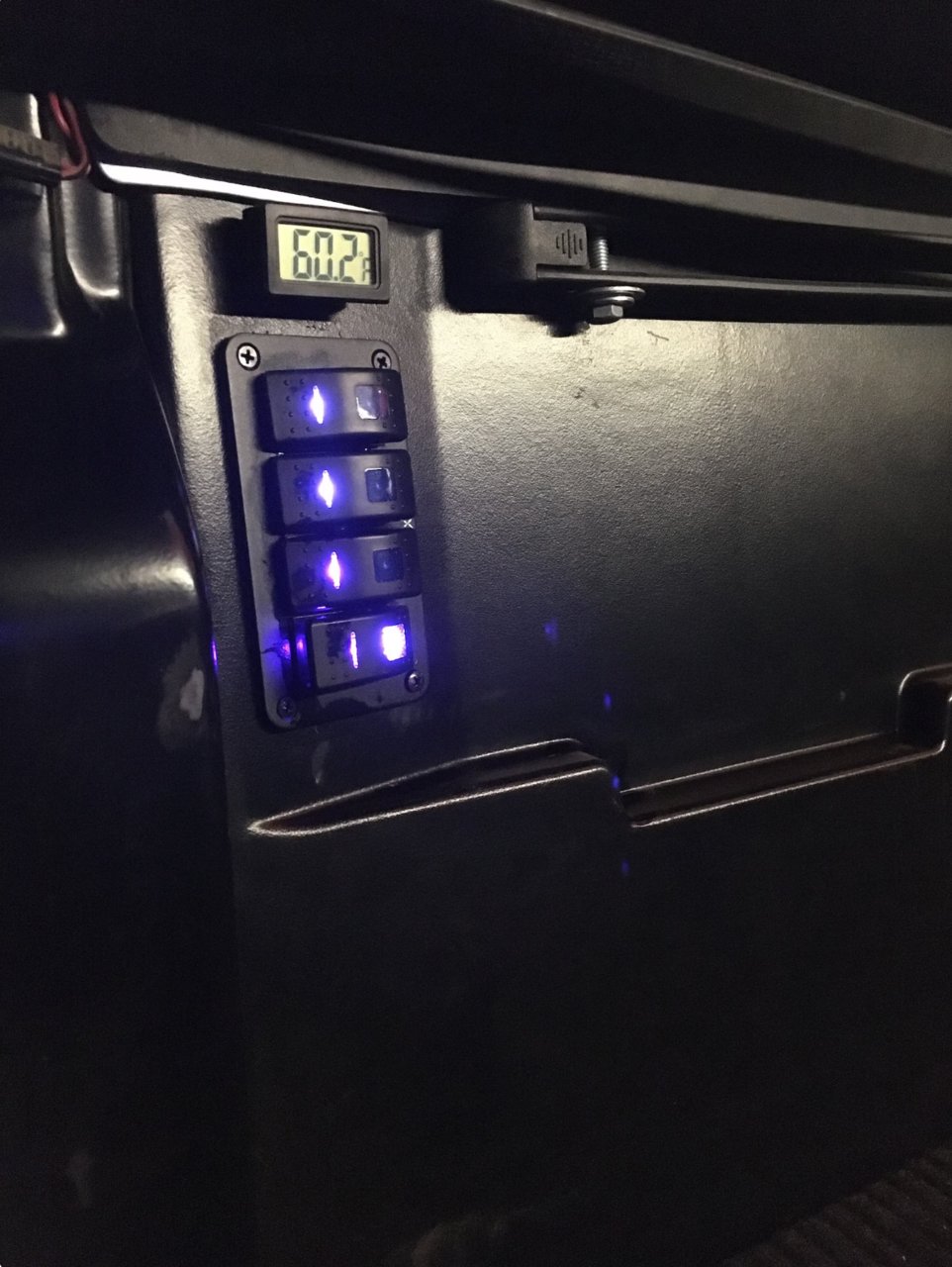

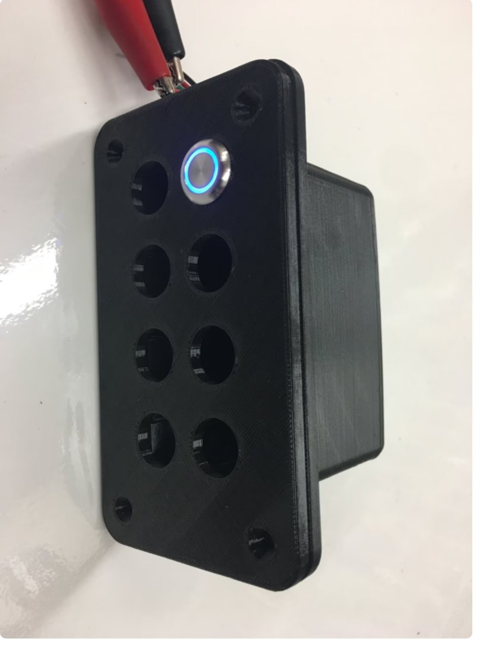

    You mean my Truck Bed Switch Mounts?
    They are deep enough but the the screw holes would be in different locations. Take a look at XFC's product page: https://www.amazon.com/stores/FXC/page/02077541-70F7-46CD-953D-25F9508E8FF4
    Do you also need switches? They might have something that would fit better:
    This would fit directly
    I is possible I could modify my 8 switch plate:

    Yes, those are the ones. Thanks.
    I was thinking of cleaning up all the wiring w/ your aux panel, and then using the switch mounts as space for usb, 12v, and a couple of 3 position switches.
    Unfortunately XFC doesn’t have the right combinations in your switch mount form factor. Wondering if I might be able to make a solid cover from ABS, etc and just cut openings as needed?
    Thanks again!

    Yeah, a custom ABS cover would to the trick.

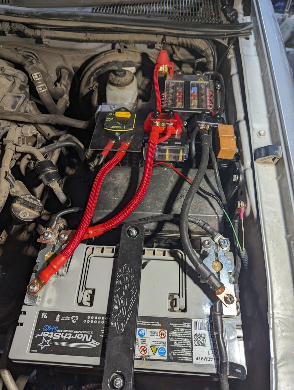

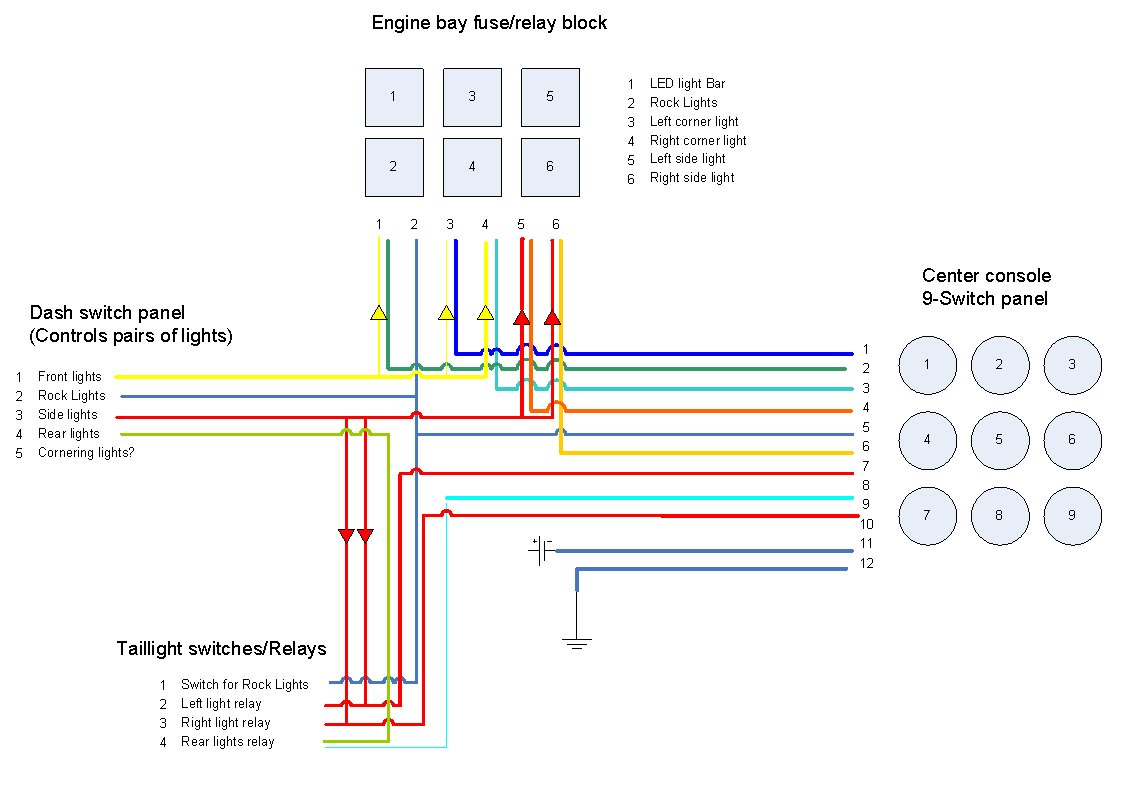

    When I started adding electrical accessories to my truck, I didn't have a "master plan" and in hindsight that was a mistake. I could have saved some time and materials if I had mapped out what I wanted and built to that plan. The problem is that may "needs" evolved over time (which is just to say I didn't plan ahead).
    From my last build, I knew I would need a fuse/relay block in the engine bay. So I did that. But then I realized that many of my cab accessories could be powered from a fuse block located inside the cab rather than using up precious engine bay fuse/relay positions. So I added a fuse block inside the cab. As I looked to accessories in the truck bed and on the bumper, I realized I needed a fuse block in the taillight also.
    I've posted about these various projects separately but I think I should try to summarize my entire electrical setup as it stands to date:
    I have three fuse / relay locations:
    1: Engine bay fuse /relay block
    LED light bar in bumper
    Cornering lights
    A pillar lights
    Rock lights
    2: Cab fuse block
    Power to switch panels
    Compressor
    USB plugs
    3: Taillight fuse block with three external waterproof relays.
    Side lights on ARE truck cap
    Rear lights in bumper
    Lights inside ARE truck cap
    USB plugs
    12V cigarette plug
    DC/AC converter
    Here is a functional diagram that shows how the switches work in each location.
    I need to make a diagram that shows accessories that are powered directly like the air compressor.
    Note that the above is just a schematic to give you a general idea of what control wires go from one place to another. An important point are diodes (triangles in the drawing) on the circuits from switches that control multiple lights. For example the wires from the Dash Switch Panel for the Front Lights and Side Lights each have diodes to each relay they power to prevent back flow of power from switches that control individual lights.

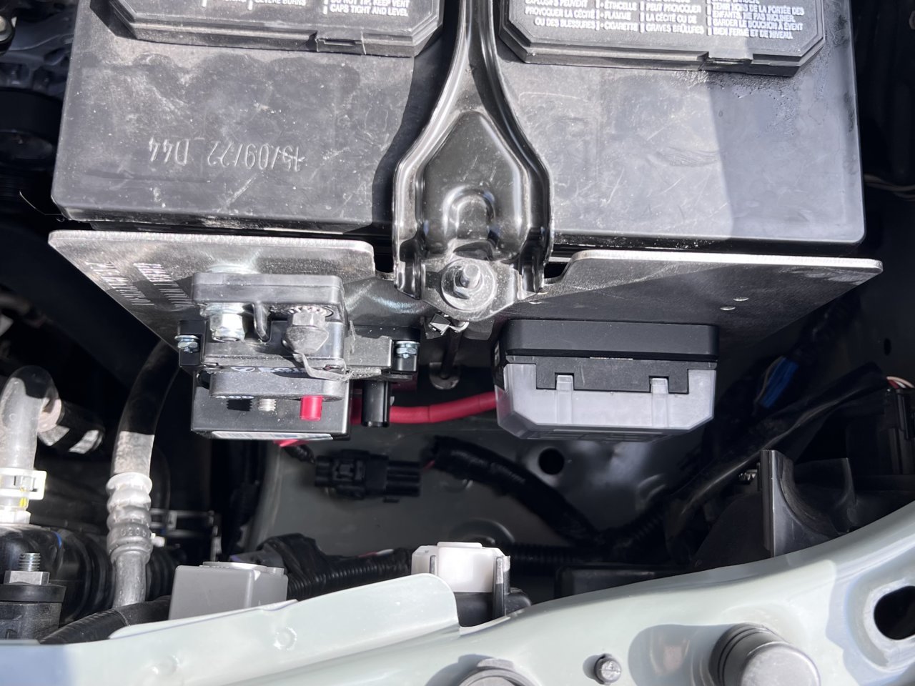

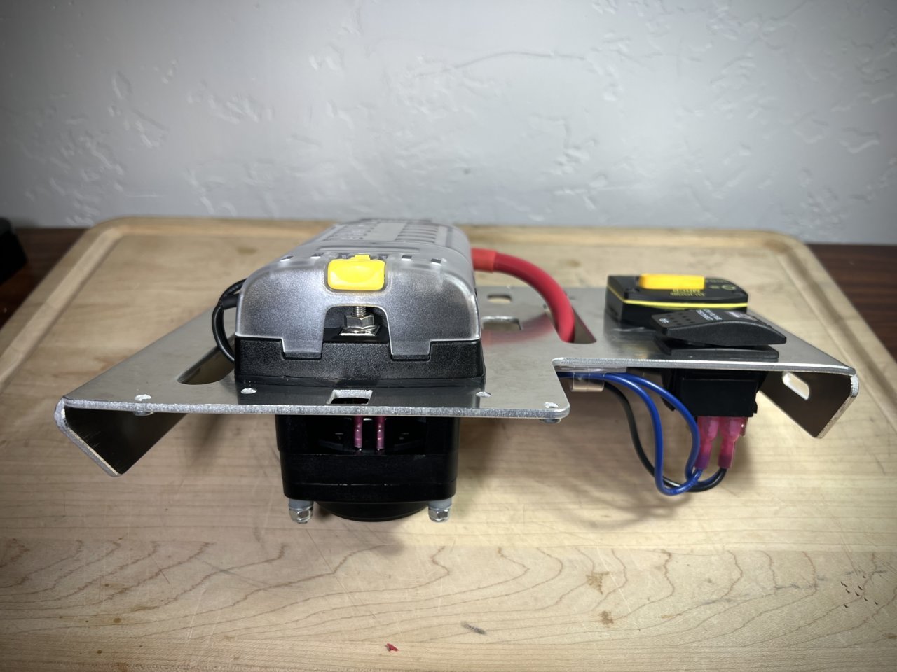

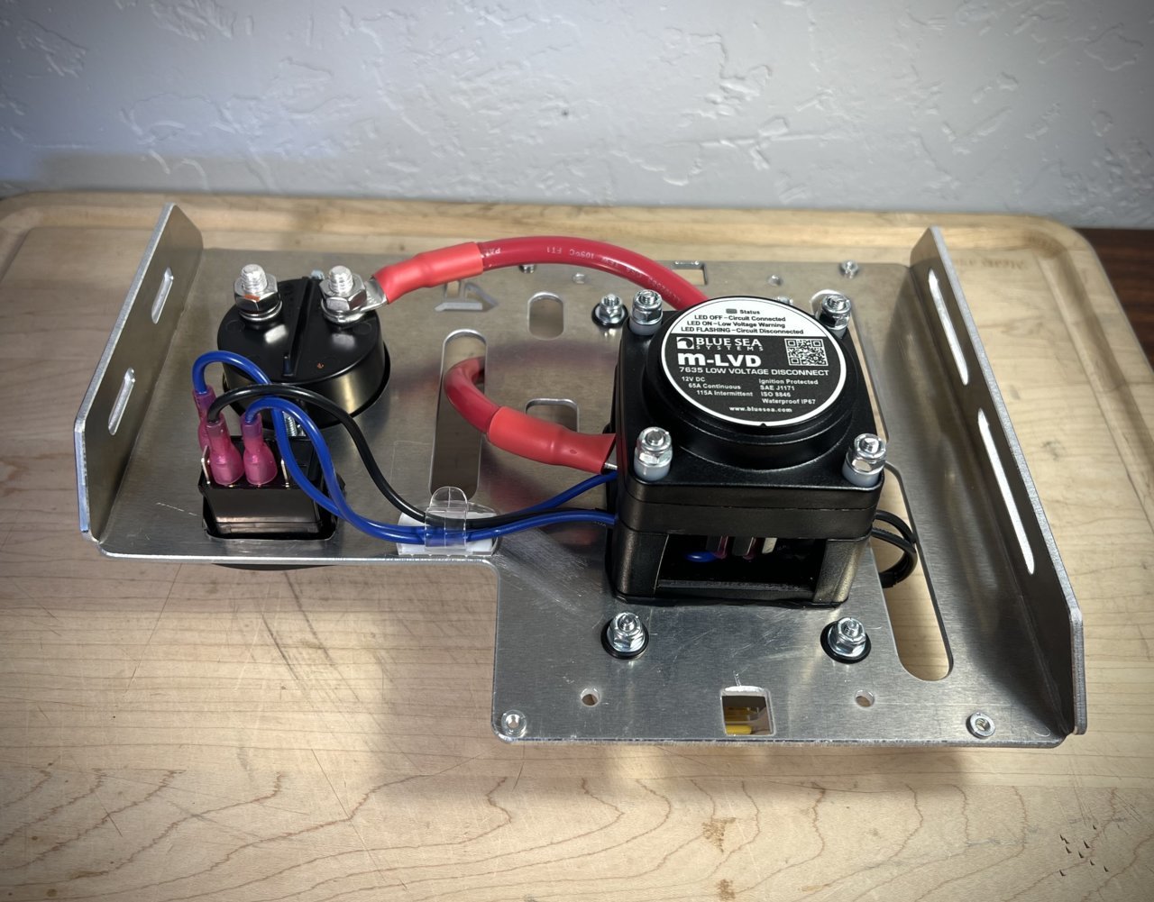

    Here’s my take:
    I used the PowerTrays sPOD Source SE (https://www.powertrays.com/products/spod-powertray) and modified it to fit what I needed. Power and ground are supplied by 4 AWG marine grade wire and tinned copper lugs.
    Mounted below the main fuse block is the Blue Sea m-LVD Low Voltage Disconnect. (https://www.bluesea.com/products/7635/m-LVD_Low_Voltage_Disconnect)
    The m-LVD will disconnect at a user set threshold between 11.3V to 12.1V. It’s rated for a continuous 65A, with intermittent spikes up to 115A.
    The factory fuse box lid can be opened, but just barely. It’s a snug fit. This has been a fun thread to read through. Thanks for the inspiration.

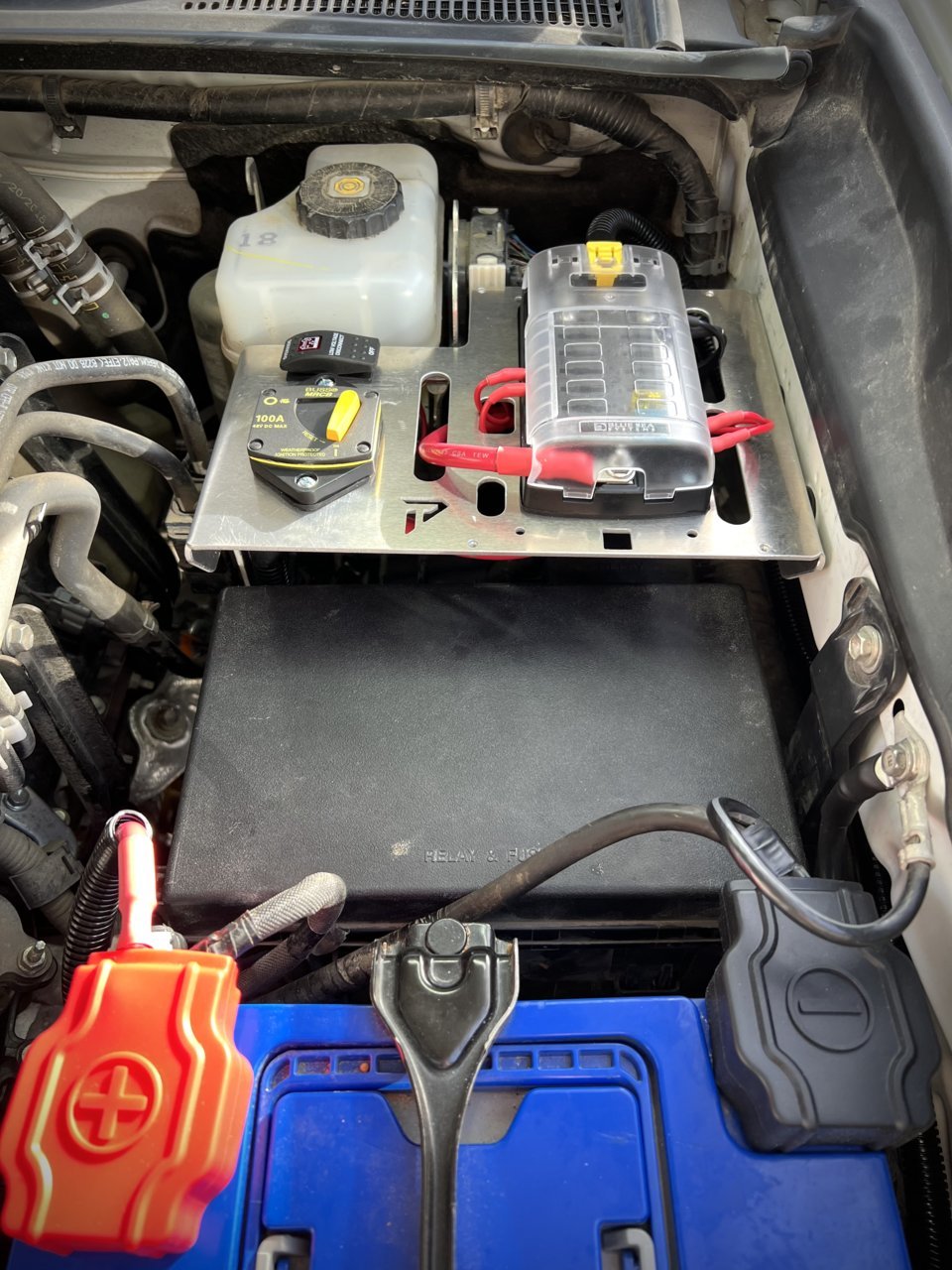

    Main breaker, 6 slot fuse panel, and automatic charging relay that will feed my second battery in the bed. The second battery will feed the rest of my 12v accessories that will also a smart fuse block.
    Here it is installed

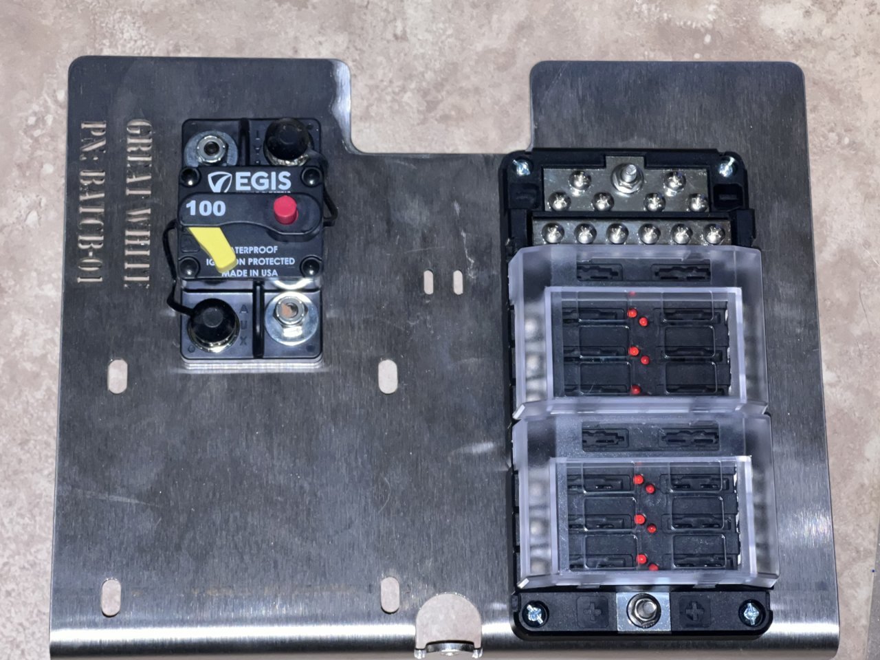

    And another configuration of a circuit breaker, 12 slot fuse block with a grounding block.

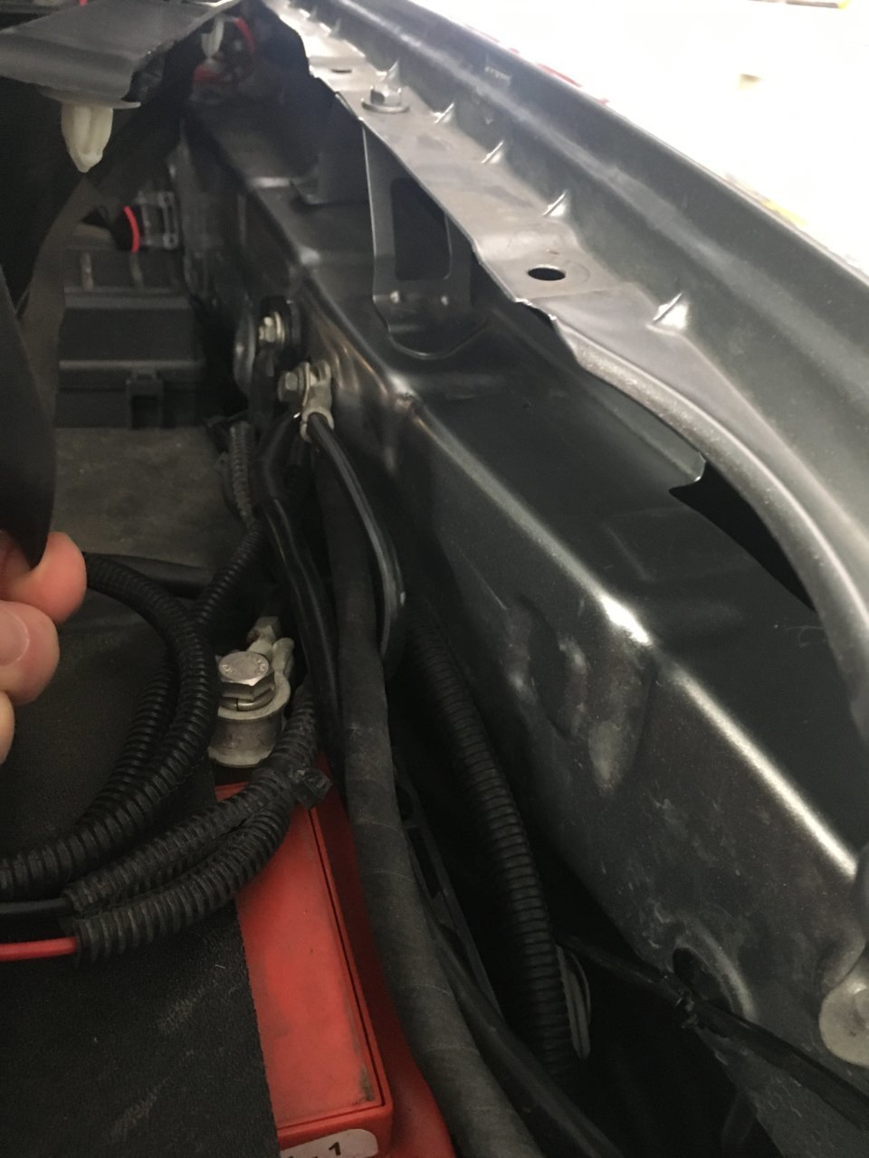

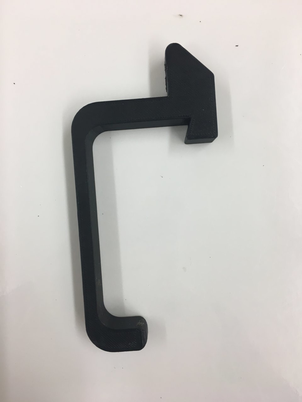

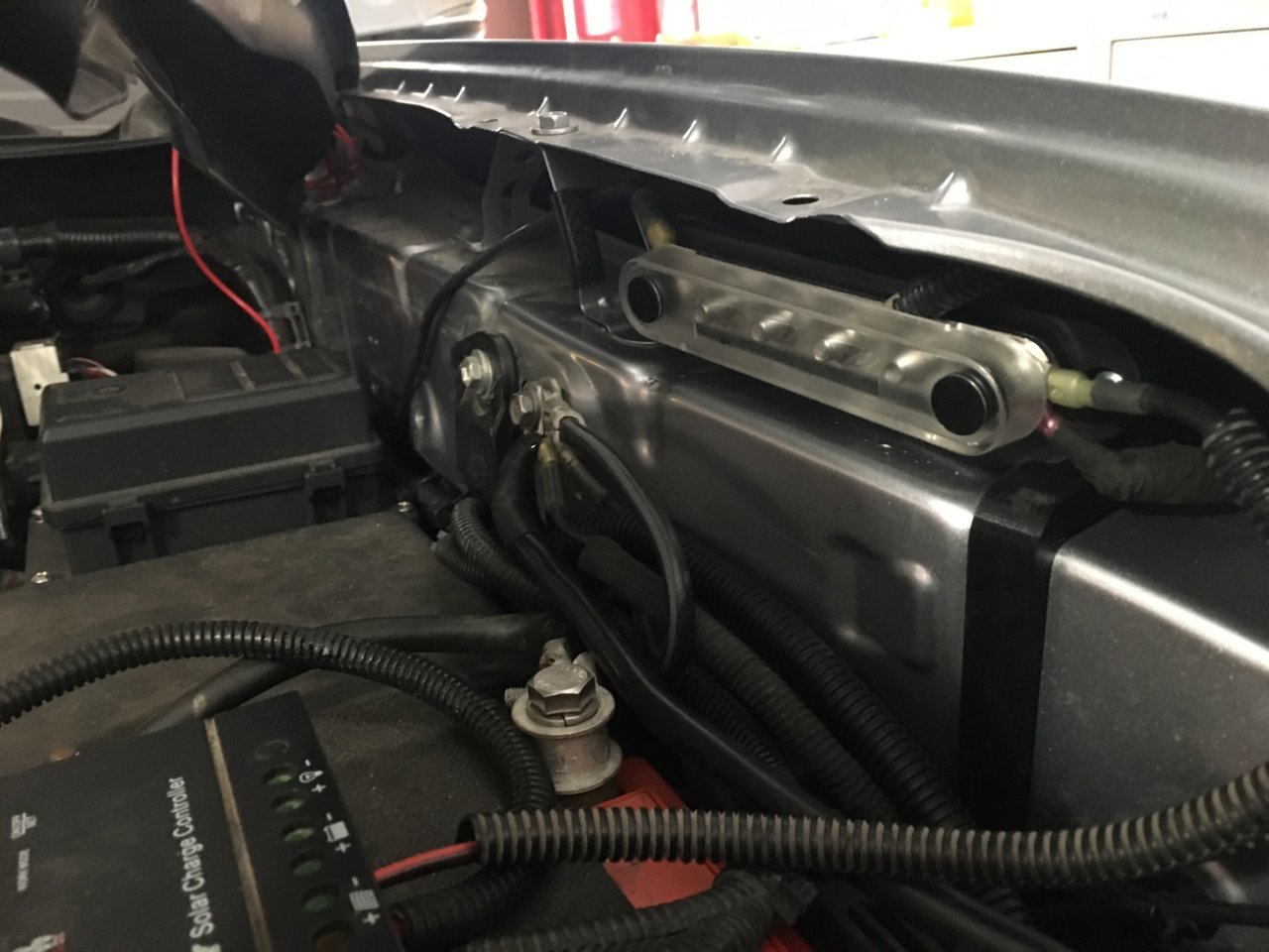

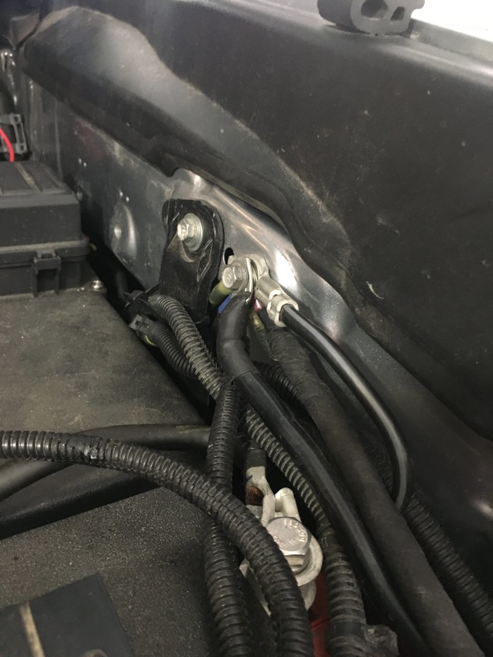

    Today I worked on the other problem I created by not anticipating all of he electrical mods I was going to do. The factory ground point next to the battery was becoming a little crowded.
    I was looking for a place to mount a negative bus bar and settled on the area next to the battery behind the plastic.
    With no easy way to drill holes in that location I designed and printed some mounts that would snap onto the body.
    The bus bar mount has two parts. One end fits the angle of the sheet metal tightly:
    The other end wraps around the frame and snaps into place:
    Here is the bus bar mounted:
    I wasn't able to move as many wires as I would have liked because it would have been a lot of work to redo parts of the harnesses, but I got half of the ground wires relocated, which is good enough. More importantly I have more ground positions for future projects.
