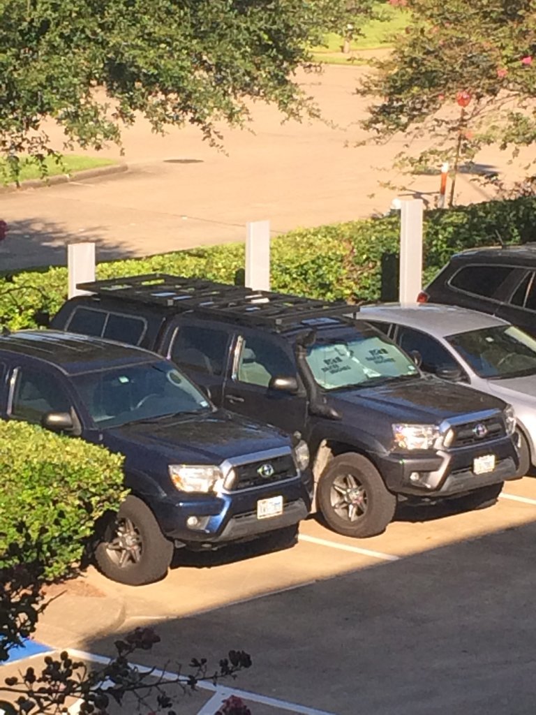

    Roof rack complete except for wind deflector

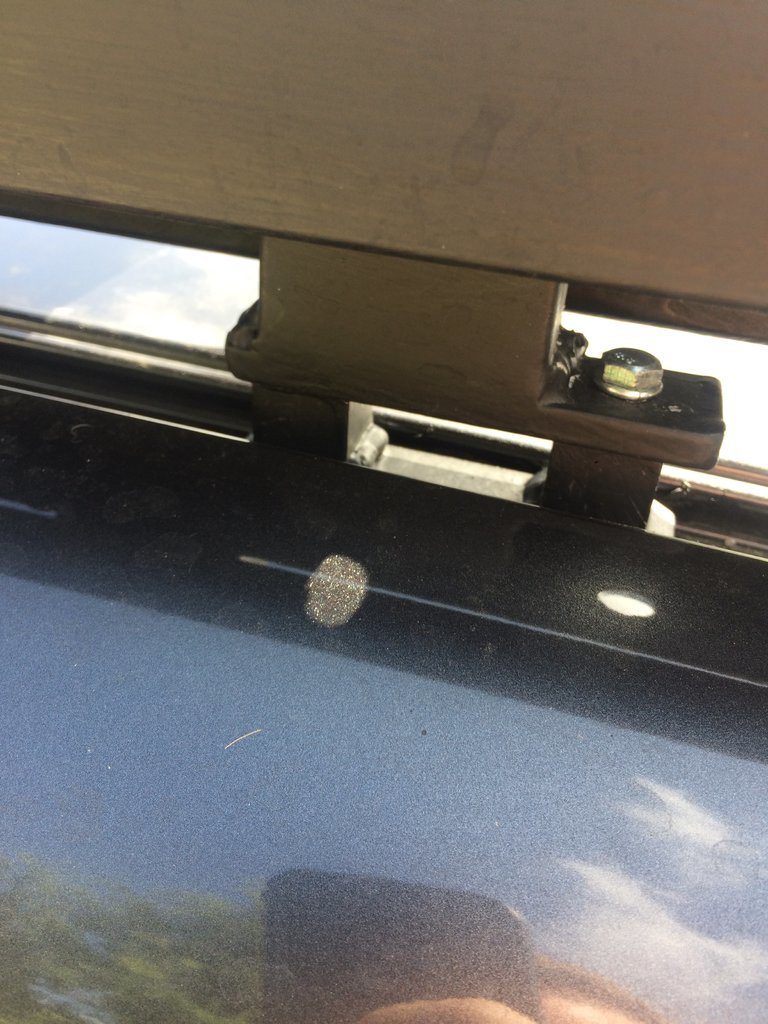

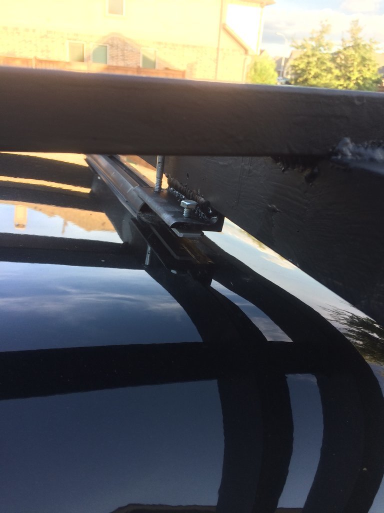

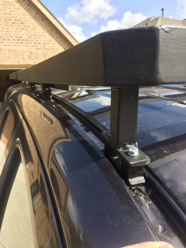

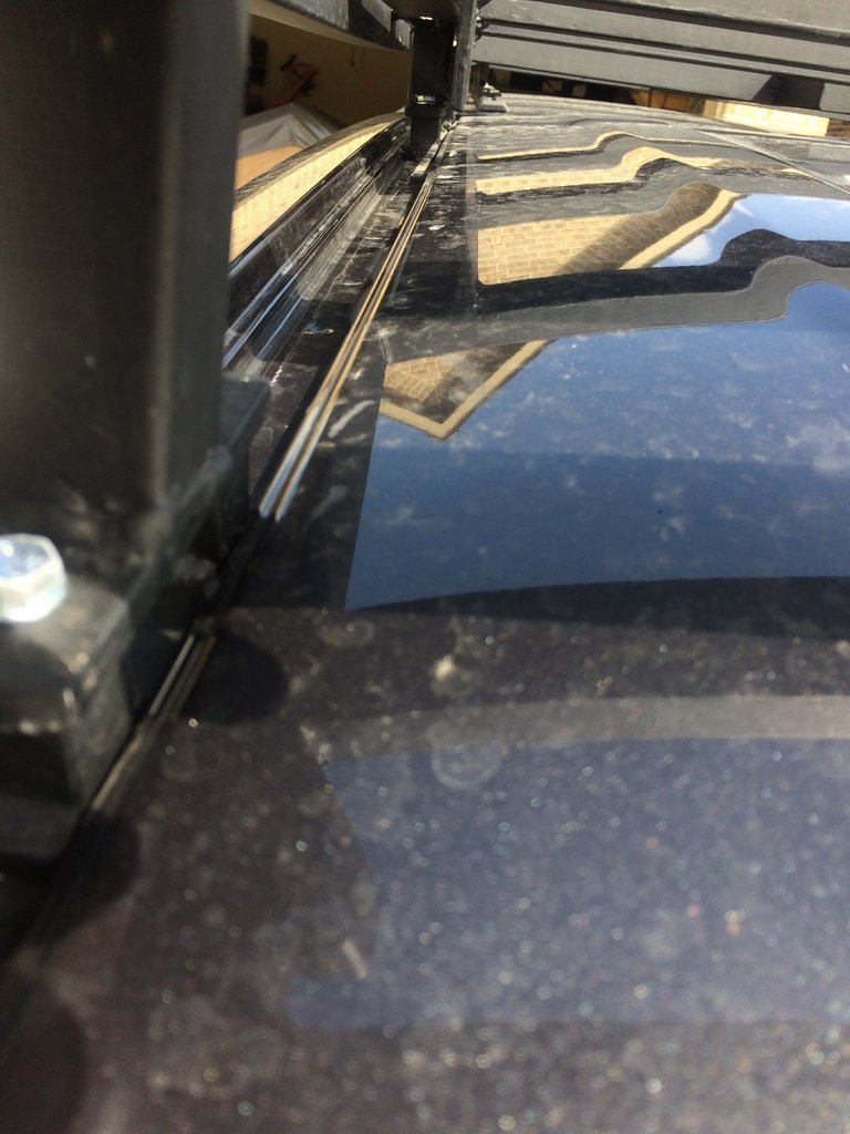

    That looks great. Got any shots of where it mounts to the truck roof?
  9. Jul 23, 2017 at 8:20 AM
    #109
    Garfish307
    Garfish307 Well-Known Member
    Mar 24, 2016
    #182243
    394
    Steve
    Katy, TX
    2014 Tacoma 4x4 Texas Edition
    Flux Capacitor

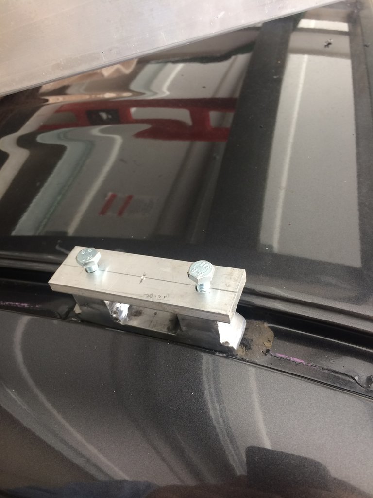

    Yep. You'll see that I put some urethane sealant that I had left over from my snorkel inStall. It's the windshield black sealant.
    I have not had a chance to trim the weatherstripping and reinstall yet.
    And to the shell:
    This is how I made the mount:

    Looks like you did 3 mounts for cab rack. Did you rivnuts for the center mount?
  11. Jul 23, 2017 at 8:35 AM
    #111
    Garfish307
    Mar 24, 2016
    #182243
    394
    Steve
    Katy, TX
    Flux Capacitor
    I just put the one bolt on the center mount..no rivnut.and I left the other side of the mount blank. I considered putting a key between the top and bottom of them out but then I decided I would install it without and see if I had issues with the bottom turning. So far no issues... you guys are going to embarrass me with my aluminum welding skills or lack there of... this is my first project for welding aluminum and there was a bit of a learning curve .

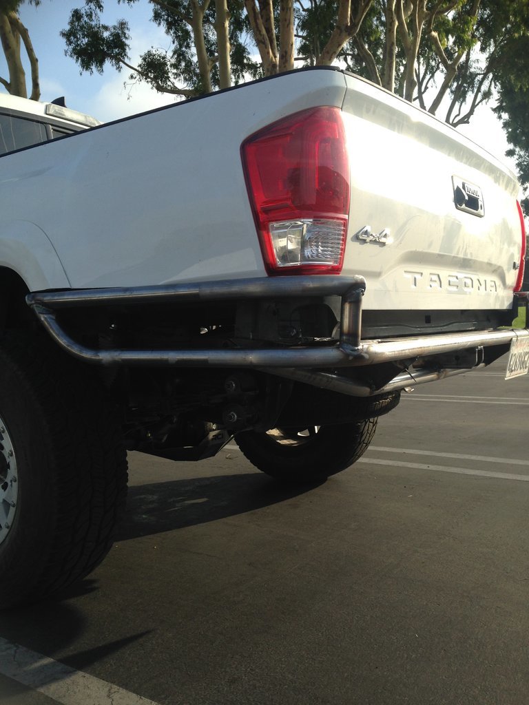

    Bumper and high clearance IFS skid build completed.

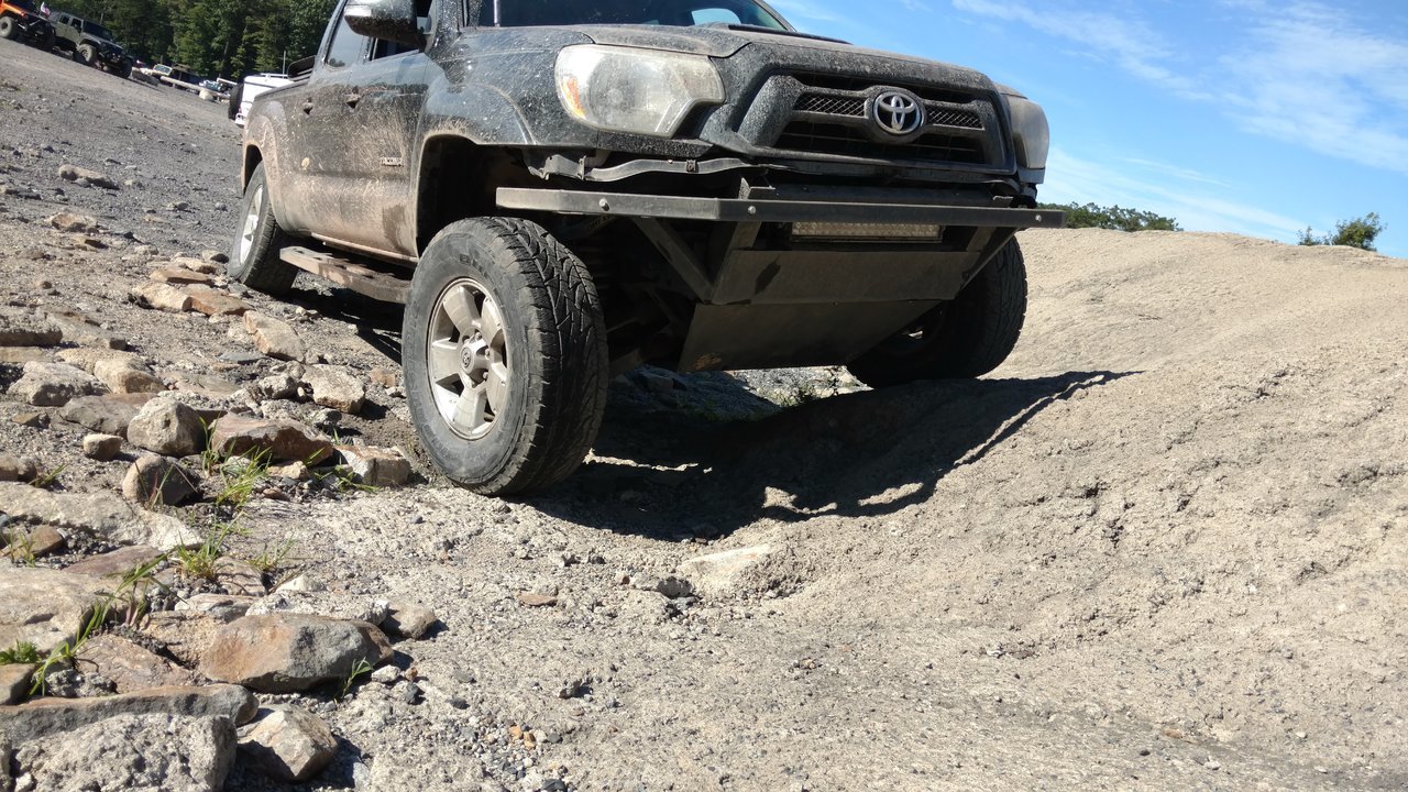

    It's not finished but a good start

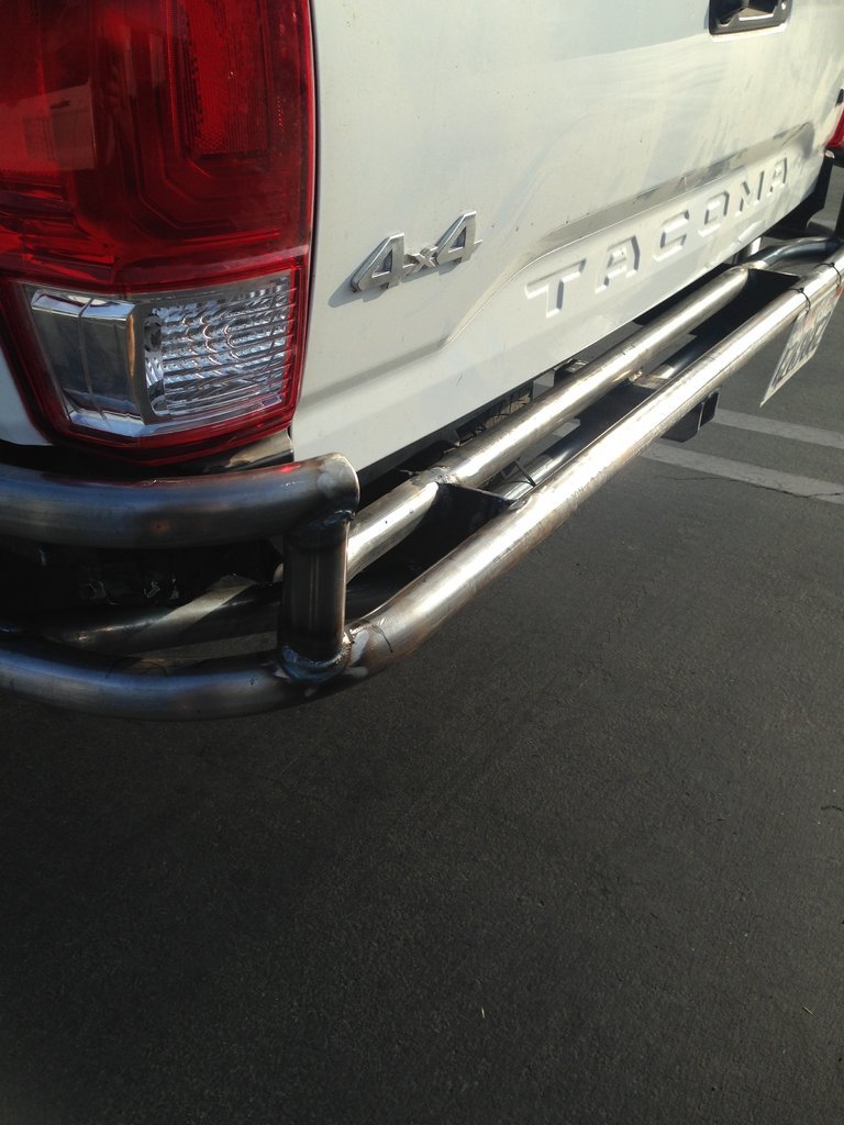

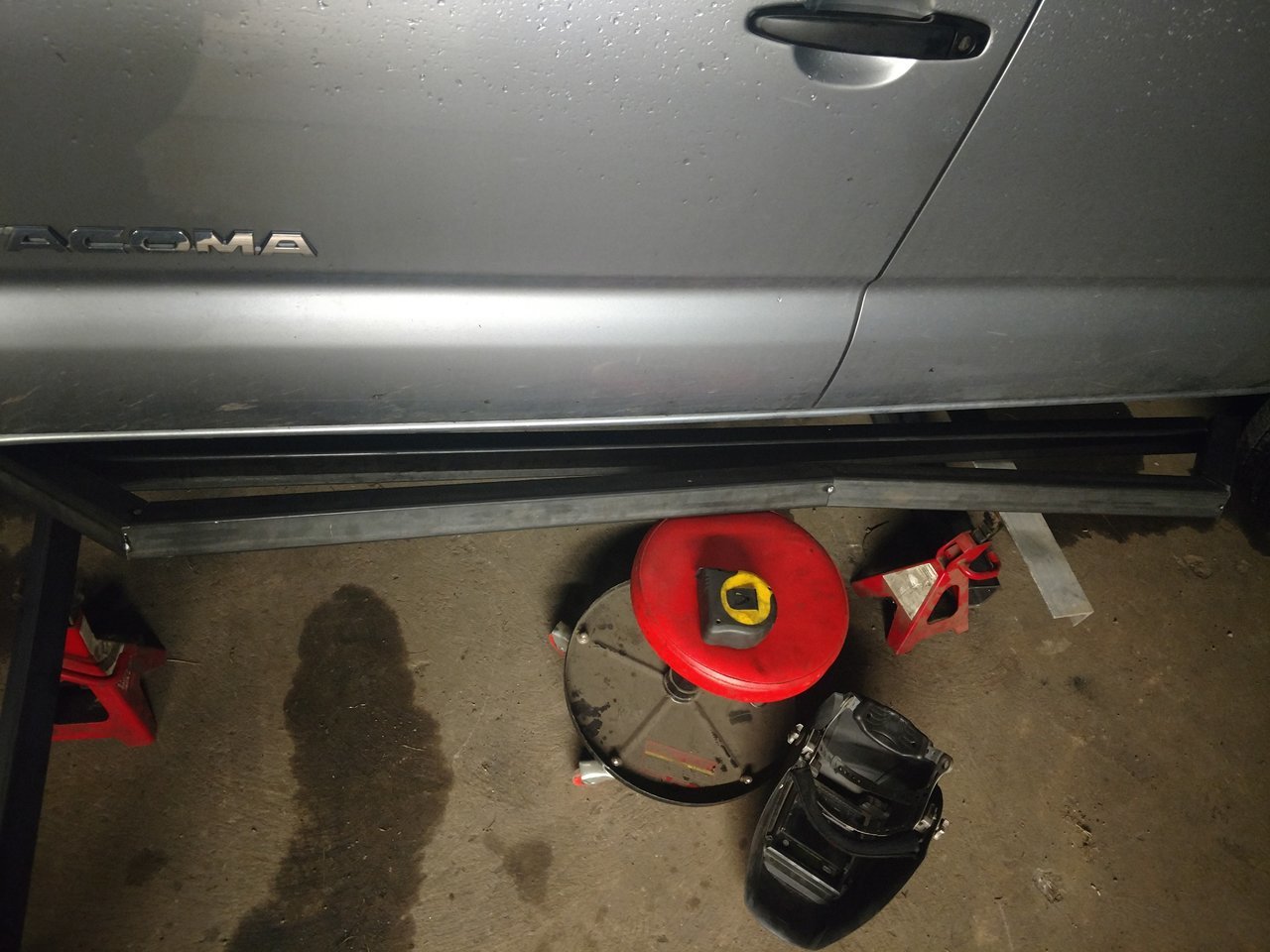

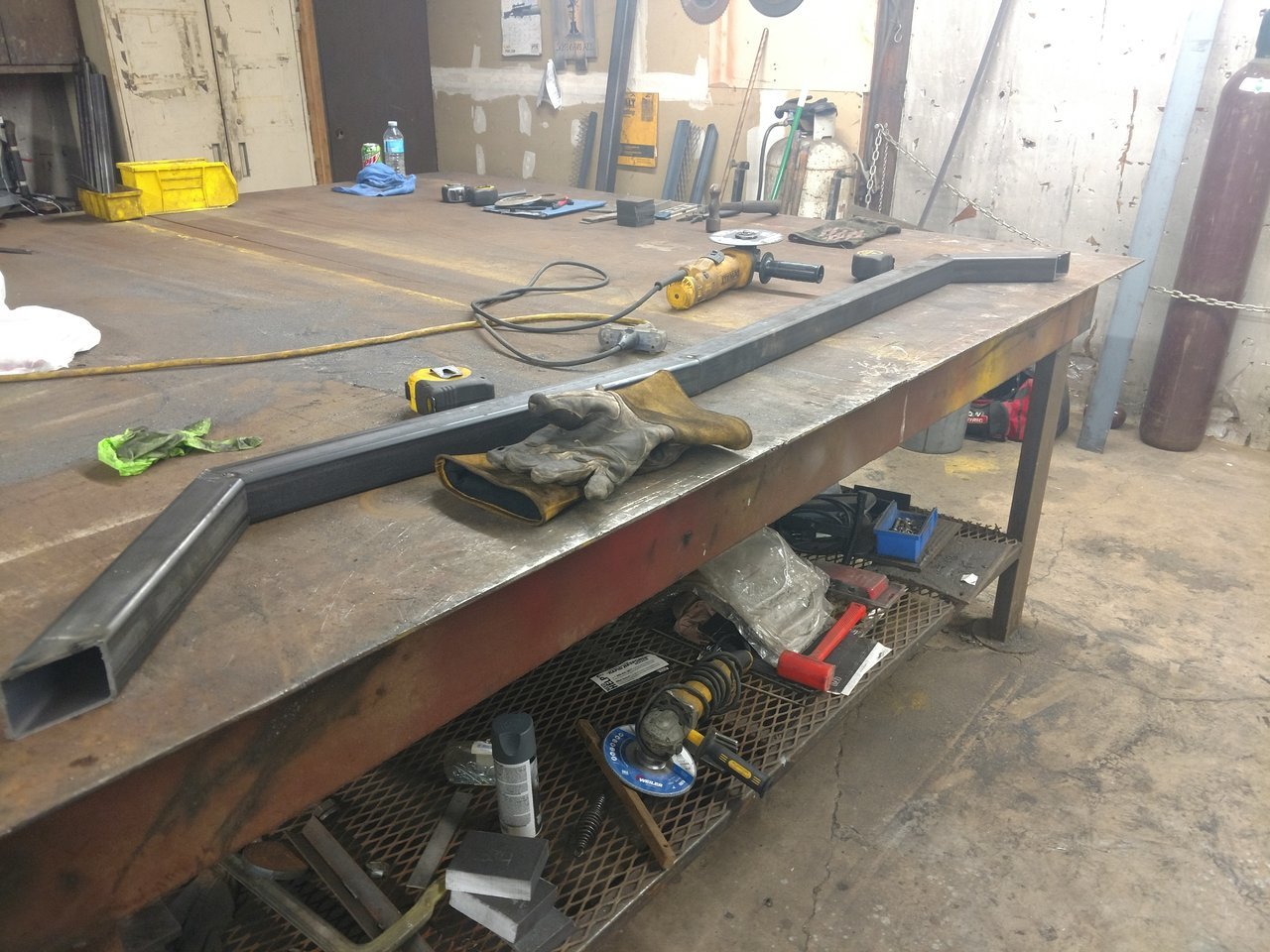

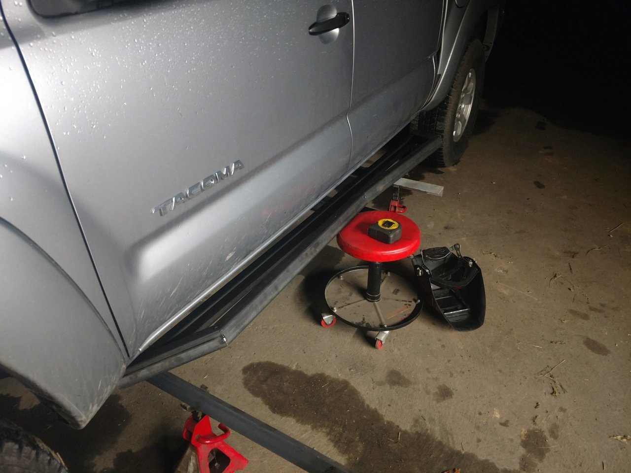

  20. Aug 23, 2017 at 10:33 AM
    #120
    Skell
    Skell KORE
    Nov 11, 2016
    #202121
    1,083
    Tony
    NE PA
    2015 DCSB, grey
    custom car grill, KORE sliders, light bar, KORE bed bars w/ tire and high lift mount. MOBTOWN front IFS skid.
    Beginning of my rock slider build! 2x2x.125 tubing
