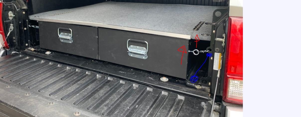

    I'm installing some turnbuckles and working on the "Sides" of my platform.
    Did you turn buckle the back side as well?
    I'm looking into ways of creating a mounting point in the back of my drawer box, without taking the box apart to access the inside. I see what you used in the front, I might screw two of those into the back

    I used a bolt and nut through the hole where the factory tie down D rings attached. I counter sunk the bolt head to sit below the drawer track. But if I need to remove the box, it would require some work.

    Kind of jealous you got real slide mechanism. What kind of carpet is that? I need to put carpet on mine.
    Also, do you really like your anchor point the way you have it in the front with turnbuckles? That was my initial method because I was able to reuse stock mounting point in the bed, but think about it.
    If you hit a bump the box is free to go up. I will be attaching down to the bed so its getting pulled to the bed. Something to think about.
    Blue is how I will mount mine. I'm changing it from how you have it rn.

    I see you already have a mounting point. In your case, even easier.

    You’re totally right. I thought of that last night too actually and I’m going to change it. My thinking was that it’s easier to get my hand into that compartment with the turnbuckle the way it’s pictured, but structurally it’s smarter to run it downwards.

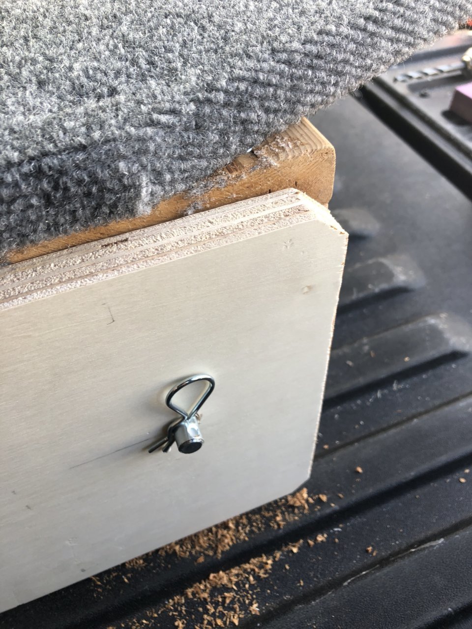

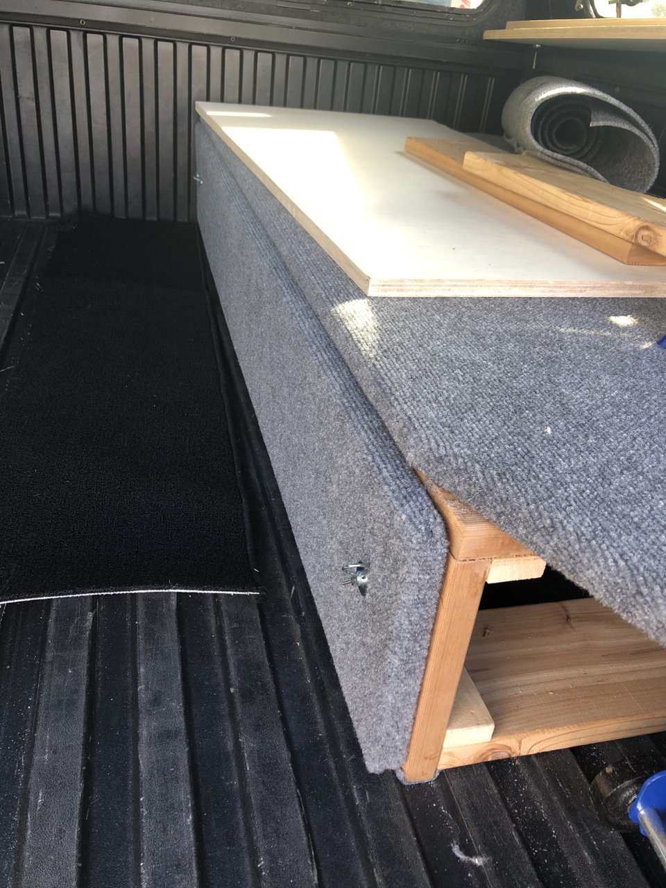

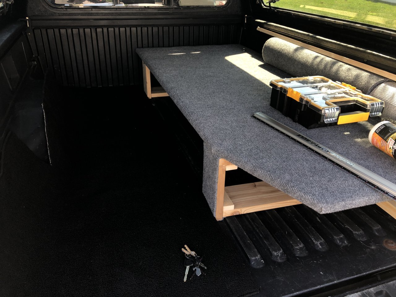

    I just finished mine! Heading on a road trip soon. Want to be able to roll a bike into the left and maybe a surfboard under the platform...
    Its two rectangular 1x6's and a 30" platform set about 8" high (used the notches on the side of the bed). The feet sort of hook into notches in the tray to keep it from sliding.
    3/4 plywood platform keeps it all in place using pins from home depot with rings on them - cant recall proper name. Then used studs(?) and cotter pins to hold the side in place just so things stay tight when I'm driving etc.
    Pretty stoked! My goal was to be able to remove it without tools if need be.. my only bummer is the studs aren't flush. I'm sure it will be modified soon!
