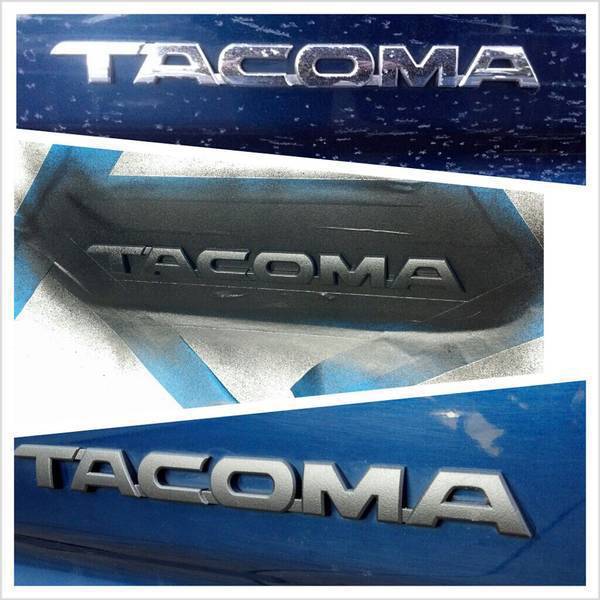

    No i didnt. heres a pictures of what i did. Also go check out dipyourcar.com. they will walk you through all that is needed to know about plastidip.
    My truck badge before, during, after:

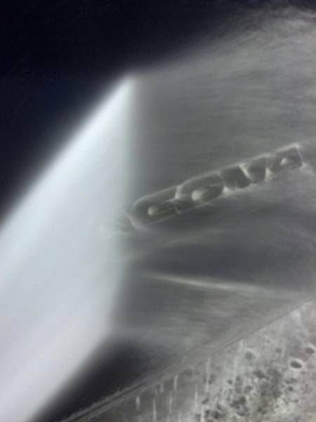

    Looks good everyone. Here's a little pressure washing. No lift, no discoloration. I love the stuff.

    How did you keep the plastidip of your paint in the O and A?

    You just spray the whole thing. i gave my badges 5 coats. after it is completly dry, use a tooth pick to peel an edge inside the 'O'' and 'A'. ive found you have to go a little light in these spots with the dip. if you go to heavy the dip will bond to the door and the badge and the gap between the two will not "self-cut" the way it is supposed to.
