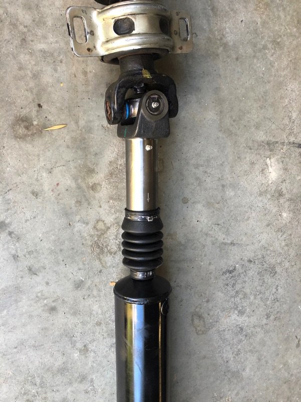

    Dana/Spicer is stock on Tacomas. My local shop stocks Neapco and side-by-side I'd call them equivalent. My essentially new Spicer 5-1330-1X u-joints fit the Neapco 1330 series yoke perfectly anyway so they could retain them.
    I got a vibration after rebuilding with new u-joints and a carrier that turned out was due to loose slip yoke splines and that's what they replaced. The shop does a lot of work for oilfield equipment and trucks and they prefer Neapco for whatever reason.
    The yoke ears are a little thicker and the casting and machining are a little nicer on the Neapco than the Spicer. But I don't know that this isn't just that the OEM parts are usually made to a contract and price point where replacement catalog parts might just go through a few extra finishing steps or something.
    BTW, to the original point, the OME carrier bearing drop/shim for me only introduced a vibration in the front shaft between the carrier and transfer case. Took them out. Did put in axle shims to match angles, which rotated the pinion 2 degrees up.
    Took time to get DS aligned left-right through carrier so it's straight from pinion to t-case flange. I get mild vibrations under hard acceleration from about 20 to 30 MPH that's probably mostly axle wrap, which the shims will make worse. But they corrected the cruising vibrations. I also filled my carrier bearing rubber voids with urethane and it's a fairly solid block now. Not quite a full poly bushing or solid carrier but stiffer than it was out of the box.
    I can live with the vibrations I have, which are worse when I'm not packed for camping. Fully loaded things quiet down. I also have OME CS047R packs with an extra leaf, so they are stiff and fairly tall. I also need to rebuild my rear shocks (FOX) so I might also have a little bit of underdamping going on.

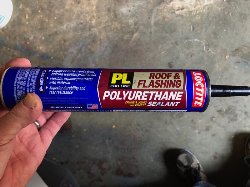

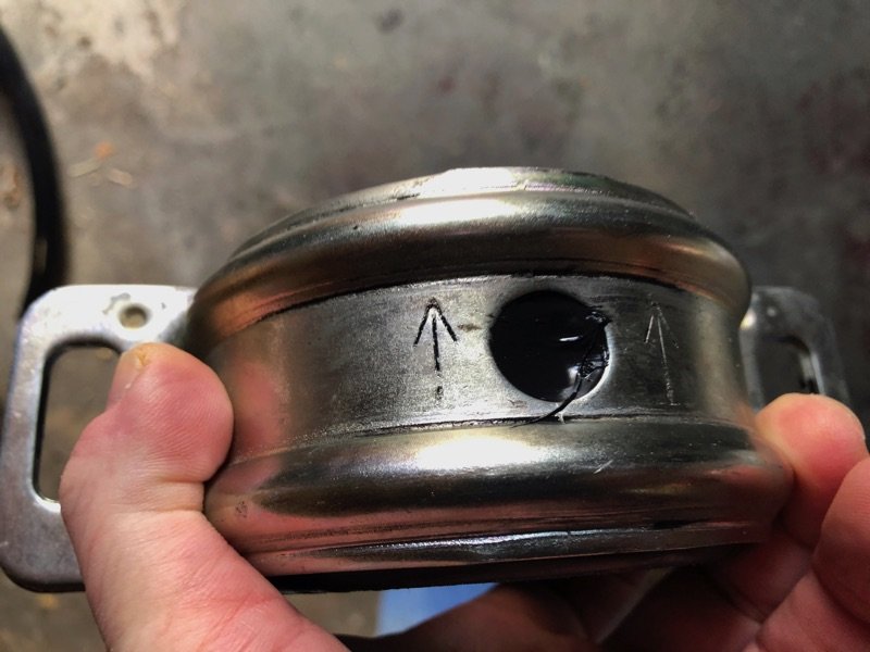

    IEDLS makes carrier bearings that use a polyurethane isolator instead of rubber.
    https://www.iedls.com/
    https://www.tacomaworld.com/threads...uy-iedls-polyurethane-carrier-bearing.421410/
    Some people have tried a pillow block instead of a bearing in a semi-rigid isolator. This is not an option for 99.9995% of people who aren't willing to do a lot of custom work and willing to essentially engineer the rear power transfer system. I'm not sure it's even wise to do or how long the pillow block would live in this application.
    https://www.tacomaworld.com/threads/carrier-bearing…-alternatives-and-solutions.419706/
    The poly option might be worthwhile, never done one so I have no first hand experience. What I did was use a new Spicer carrier and filled the rubber voids with the roof flashing urethane you get at the hardware store. My reason is to hopefully make the carrier last longer is all. From a vibration standpoint leaving it stock probably would be better.
