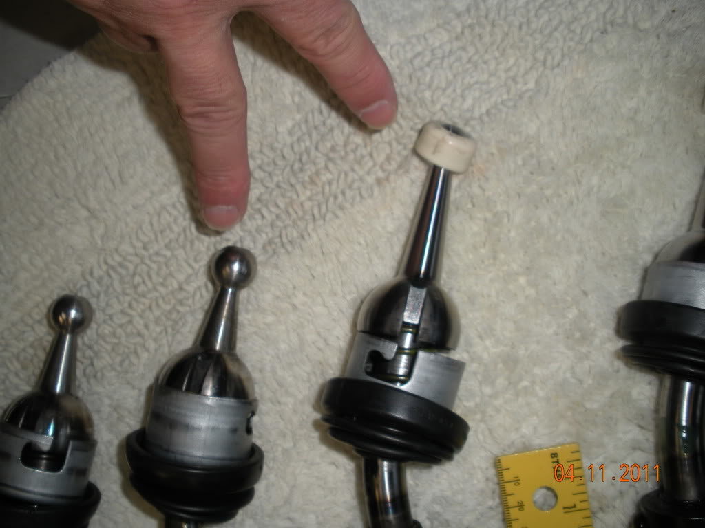

    So it was definitely the shifter mechanism and not the tranny itself? If so, that's a big relief. Do you happen to have a picture of the worn out one? I bought my TRD shifter used, so there's a chance the guy lied about the milage on it. I'm gonna start by replacing the nylon bushing and see what that does for me.

    Picture on the right is a TRD SS (longer tip) Left is stock OEM. The one on the right has the tip bushing that is replaceable. Both the OEM and the TRD uses the same bushing. The URD SS uses the same bushing as well.

    Correct and it shouldn't have been the tranny, as the mechanism shown in the pictures below you post, they were all loose and eaten up....the first thing my mechanic said was "shifts like new" ! Good luck , jeff

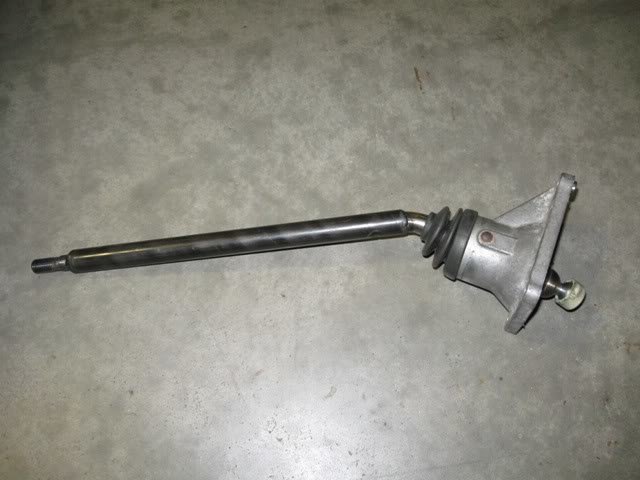

    That was the trouble with mine a few years back:
    Ended up cutting the whole assembly apart and welding in a chromoly tube. MUCH tighter and no issues since.
    (yes it's installed backwards in that pic. I realized it when I went to install in the truck. :eek:)

    Hollow or solid stock chromo? That looks interesting. Other than weight and length, did you change the angle? I would totally make one up if I was still working in a fab shop. :)

    Hollow, thin wall, and the angle is the same. Length is...eh, I'm not sure how the length is relative to stock. I just cut it where it felt natural.
    It's actually lighter than the stock stuff and has held up to my abuse, which is saying something. :)
