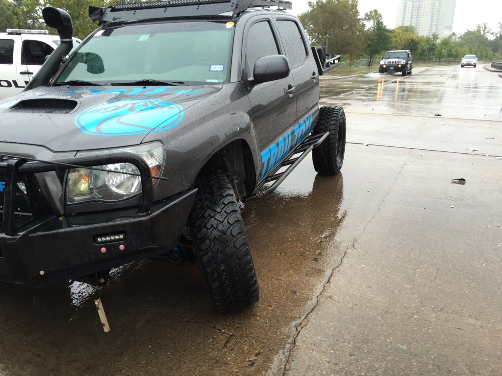

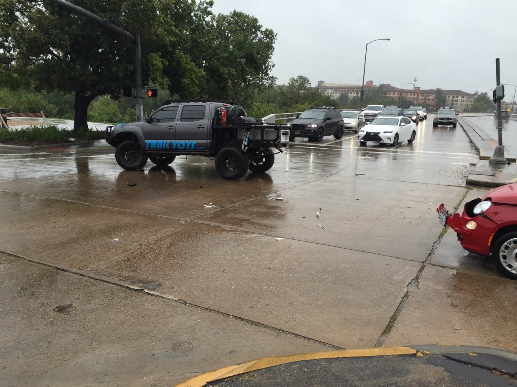

    Welp, it was bound to happen sometime. Old man turned left on a green and didn't stop for the red in the middle of the intersection. I didn't see him until he was in my tire. The damage looks minimal, besides the wheel, tire, and obvious cam tab. Still to early to have it torn down to see what else was damaged.
    Thankfully no one was injured. Hell, his airbags didn't even go off.

    Dang man glad your ok, looks like a pretty simple fix. Time for those upgraded TC cam tab mounts though.

    I had a similar impact to my truck a little over a month ago (but mine was parked). Looked like nothing was wrong with mine at all so I drove it right home after finishing up with the emergency guys. Got it checked out the next day and you'd be surprised... lower control arm, wheel bearing, both ball joints, tie rod end, rim, and steering rack were all damaged.

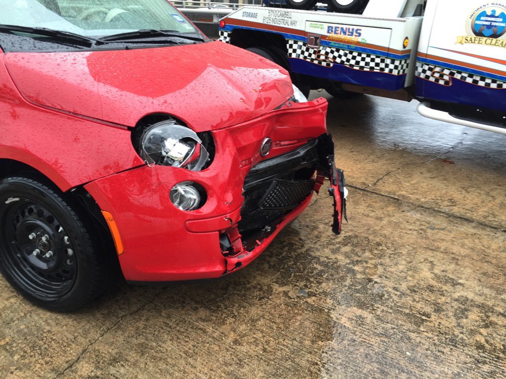

    So first, glad you're okay. From the distance, your truck didn't even look damaged.. not like his little FIAT or whatever it was.

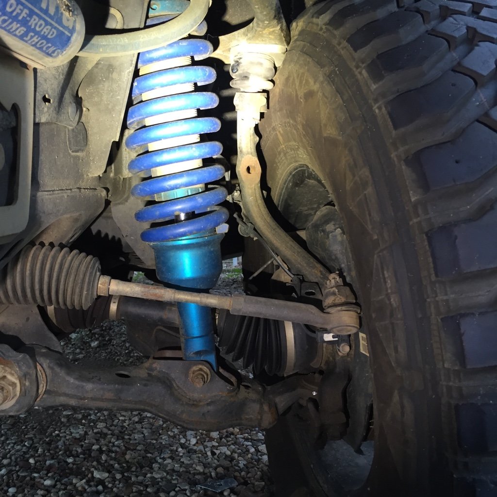

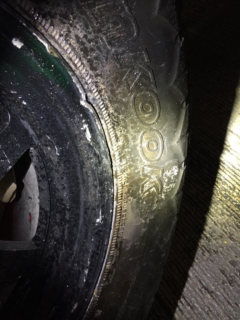

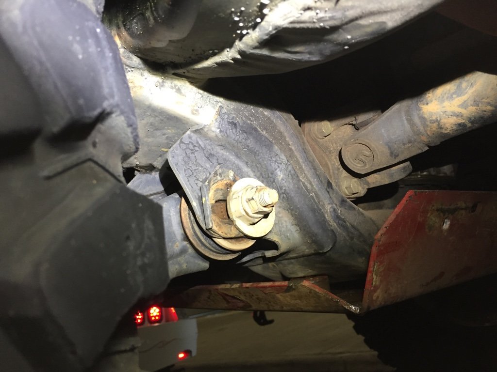

    Ok, so I'm considering taking a check from the insurance company and fixing the truck myself. I'm going to use this post to keep track of what I think needs to be replaced, what I actually replaced, and what it all cost.
    What I know is broken/damaged:
    Spindle (possibly bent)
    LCA cam tabs (Rear cam bolt pushed through tab)
    Konig Countersteer TypeX (lip bent and torn)
    315/70/17 Hankook Dynapro MT (slashed)
    What could be damaged:
    Steering rack
    Wheel bearing
    What I'll be adding:
    TC LCA Cam Tab Gussets
    Here are a few more pictures of the carnage. :D

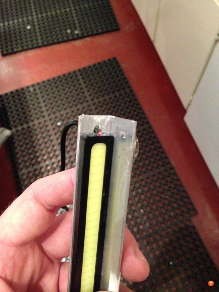

    How did you wire these man? I'm not very good at understanding how to wire 8 lights together :/
  17. Nov 3, 2015 at 1:24 PM
    #1517
    Large
    Large Red
    Sep 10, 2011
    #63268
    22,457
    With 1 switch or 8 switches is the first question. Secondly you would wire them in series if you want to power multiple lights with 1 switch.

    So for one switch and 8 lights then I just connect all positives together and then connect that to a inline fuse and then to the battery? Or to switch?
  20. Nov 4, 2015 at 9:01 AM
    #1520
    SMKYTXN
    SMKYTXN [OP] If it can't be overdone it's not worth doing Vendor
    Mar 11, 2011
    #52810
    14,040
    Nathan
    Houston
    11, 4dr, TRD Sport, 6sp
    DCFB
    I ran a dual conductor wire around the perimeter of the frame and tapped into it where I had a light. So I had a single power and ground connection in the engine bay. All of my accessories are tied into an NSA, so I had it easy.
    If you're using a standard switch, you'll do the following:
    - Hot wire from the battery
    - Fused before the switch
    - Ran to the switch
    - Wire from switched side of the switch to rock lights
    - Ground all lights to the frame
    Hope that helps.
