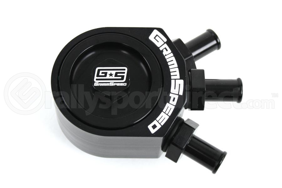

    This is an ingenious solution that Subaru owners have. Takes the place of your oil cap. Something similar adapted to ours would only need an inlet and an outlet I would assume. Breather line from head goes to inlet, outlet goes to intake manifold. Oil dumps back into head if there is blowby or an extreme angle.
