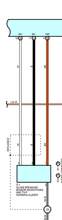

    Nice DIY project with your new upgraded alternator, awesome job!!! You probably saved yourself a lot of $ doing it all yourself. :) I only remember reading about the older Toyota MR2's alternators giving a higher output while being a direct fit for our tacos. Glad you found a nice alternative!

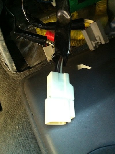

    So I spent a full day searching the insides of my dash and under the steering panels looking for the factory wiring that goes to the LED/GBS empty plug. In reference to the CustomTacos pic, it shows that the batch of factory wires with the unused plug route to the right under the steering wheel where it snakes into the white wire clip holder but then "turns left" and then the empty plug is taped up.
    Do you remember if your 04 DC taco had the factory wires and empty plug in this specific location or were you able to find the empty plug elsewhere? :confused:
    I found a thread where the OP was trying to do the same thing: I can't find the empty plug thread
    My next attempt at this will be to look at the wires from the source, the alarm module, and see if I can identify the LED/GBS wires using a PDF wire diagram I found on the internets.
    UPDATE:
    WOW, you are spot on describing the factory wiring. Here's the wire diagram I found that backs up the wiring you did: :)
    ScreenShot2013-05-13at104814AM_zps9a1919_974304c2cb0b00d71f193db56dc71e822c3a0ee5.jpg

    Wow, it's been so long :(... but I do remember that they were near the center console and not under the steering wheel. Without disassembling my dash, I did pull on it and I think the wiring origin is right behind the radio area. But I can't tell for sure without ripping it all apart. If you still can't find it, I will investigate further... just let me know cuz I don't want to rip apart for no reason.

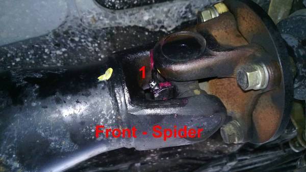

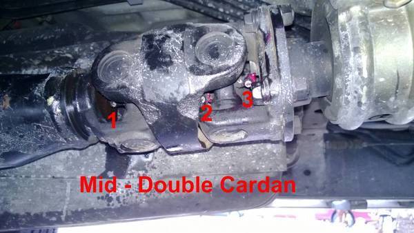

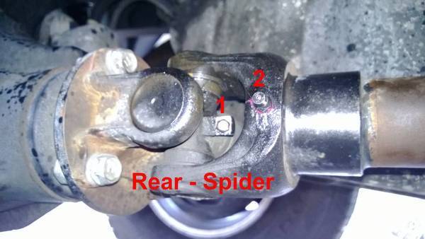

    This is covered in other threads, but is something I've been much better about doing... greasing the driver train. Here are the Prerunner zerk locations:

    So I went at it again and found the unused plug!!! :) Center console area behind the radio, just like you said, you have a good memory :D. I wired up a 12Volt LED to the brown and black wires and the LED alarm status works great! I'll probably run the LED's in parallel since the aftermarket one will be far towards the windshield (so I can view it from outside far away) and keep the factory LED powered close below near the front of the gear box where the two dummy covers are. I couldn't find a vertical GBS/LED module but did find a used horizontal version, but it didn't come with the wire harness. For under $20 im not gonna complain. I'll need to test and figure out which of the 4 pins to tap into at a later time.
    I also read somewhere about I guy who did the same mod and wanted to test the glass break sensor (the mic) to see if he hooked up everything correctly. He used the end of his metal key and tapped on his glass window loud enough to activate his alarm. This also allowed him the ability to adjust the sensitivity. It looks like there is an adjustment knob control somewhere located on the keyless/entry alarm's brain (behind the drivers kick panel) to make the adjustments. You probably already know all of this, but just in case.
    Anyways, thanks again for all the help and pointing me to the right direction, I almost gave up on finding this unused plug below! lol!! :)

    :thumbsup: Glad you found it. It took me awhile as well since I originally thought it was under the steering column too.

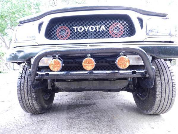

    Thanks for the positive feedback. Nothing wrong with a Prerunner, good all around truck. I won't argue that it is more capable than 4WD... just that some people don't need the 4WD capability.
    Here's some more pics of my budget baja mod:
    I had some extra mesh from the Satoshi mod and zip tied it into the lower radiator opening for protection. You can see it between the fog lights in the last pic. Overall, real happy with the results (although would like a lot better with a set of KM2's on her :(). Cost me about 5 hours and several cans of primer and spray paint. All the other stuff I had. Even remounted the stock bumper lights.
    Recycled some of the removed plastic lower fascia for a windshield washer protector.

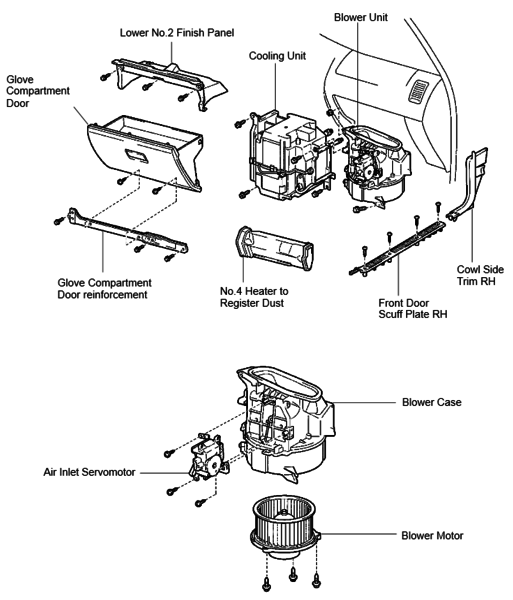

    Squealing blower motor... solved.
    Over the past few days, my interior fan blower motor has started squealing. It is especially evident when on highest setting. I decided to take it apart, clean, and grease it. Take of glove box, remove 3 mounting screws, gently pry off fan blade wheel, remove 2 cover bolts and gently pry off black cover. Cleaned the windings with compressed air, cleaned fan wheel with degreaser and water, lubed the spindle with bearing grease. Checked the brushes and they had plenty of life on them. End result, no more noise! :D I wouldn't say it necessarily blows harder, but it is very quieter now and squeal is gone.

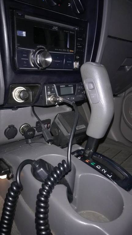

    CB radio install. Nothing fancy, it has been done and written about before.
