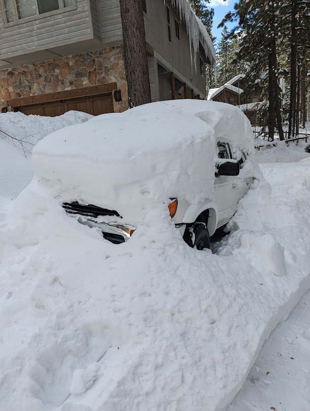

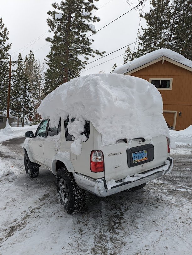

    Looks like a Vegabond camper hidden underneath :burp:

    That's exactly what I thought when I got it out.

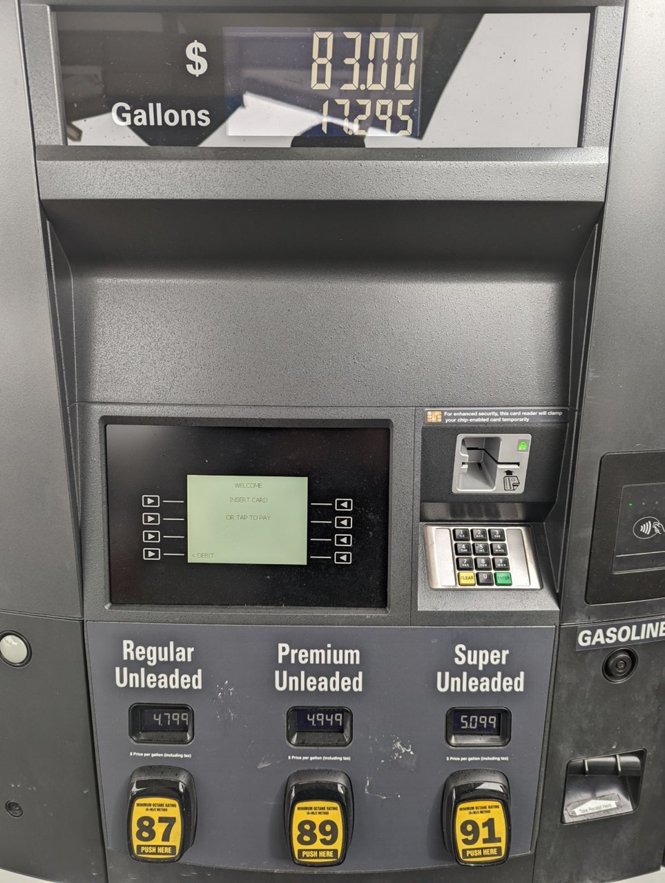

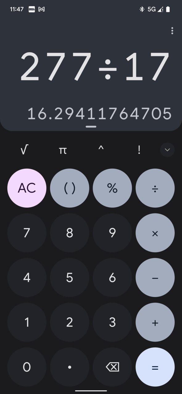

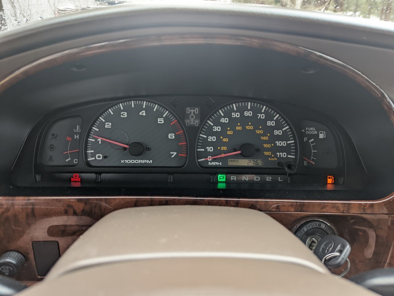

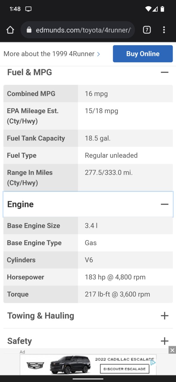

    16.2 MPG spot on with what Edmonds estimates.

    Dang you have a center lock X

    Yeah that’s where my wife’s is - between that and 14 for mostly traffic tanks.

    Yeah I just wish it had the rear locker also. I am going to add one at some point.

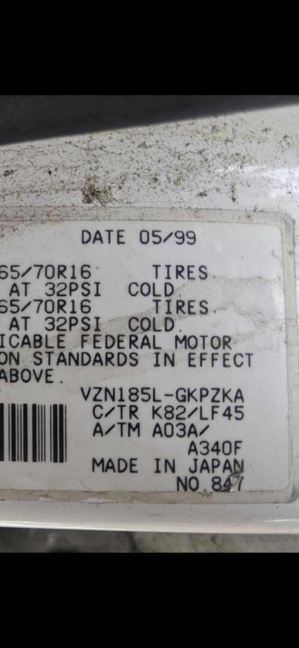

    What ratio is your truck?

    He should have 4.10; with the e-locker it would've been 4.30

    Yeah 99% sure it has 4.10s If I can find a 4.30 parts truck I'm going to do the swap.

    Ah, didn't know if all Limiteds were 4.30 or not. It would have been a decent ratio for cheap if I could have found an open 4.30
