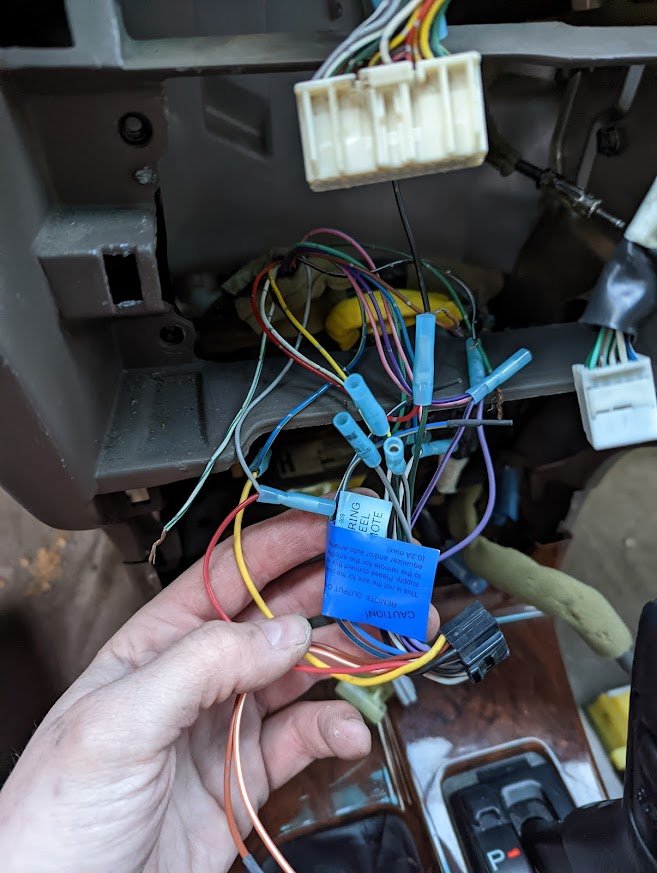

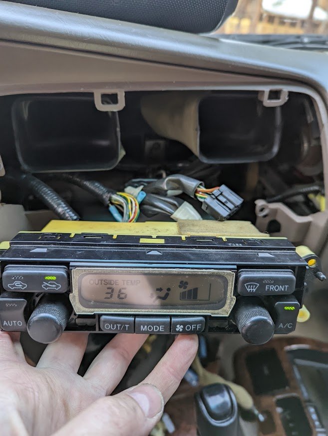

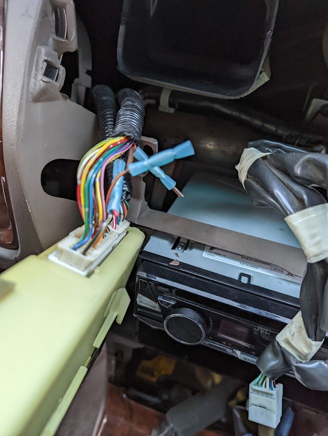

    Got a little motivated to work on my radio issues today, Thanks @Kwikvette.
    Started with the climate control unit. Opened it up cleaned all the buttons and dials and replaced the bulbs. Works like new. Also noticed a few random wires cut in for some reason. Should have given me a clue what I was going to find behind the radio.

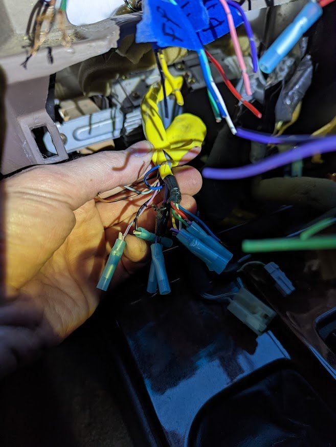

    Of course the harness was all hacked up. I expected nothing less.

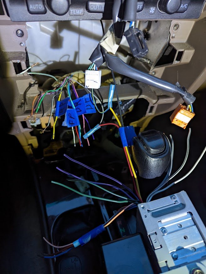

    Spent a little of time cleaning up and identifying what wires go where.
    Turns out there is a factory amp behind the dash, but it looks like that was all hacked up also.
    I got everything back together and wired to the proper locations. This should be sufficient for a little bit till I get a better radio.

    ya gotta love that kinda mess...

    97 2/4wd, 2014 DCLB 4x4, 99 T4R Limited (sold) 2024 4runner TRD Pro
    All because someone wanted to save $12 on a oem harness connector.

    Northwest Indiana/Chicagoland
    yup. honestly.. when a car comes in with issues an we see that? its not even worth fixing it.. because they go back and do it again
    we quote the whole harnesses.

    Damn, at least your mess didn't look as bad as mine!
    Good to hear it's better now.
