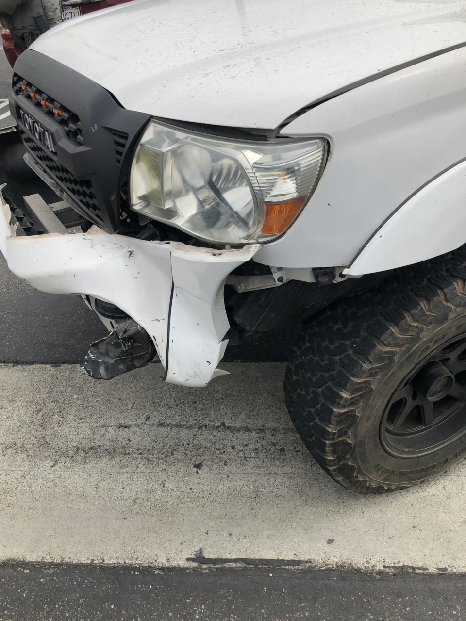

    Damn that’s rough. Mine wasn’t as bad but still enough for me to get the fab bumper B0AD38CC-3AE8-4F65-9A29-34AFDBA58598.jpg
    tcjacado[QUOTED] likes this.

    If that beam is hollow and open on the ends, just put some 3/8” bolts and locknuts, with some clipped washers on it and be done with it.

    yep, just drill out the rivets and swap the brackets and install new rivets you’ll be good to go. And yes you’ll use that tool again.
