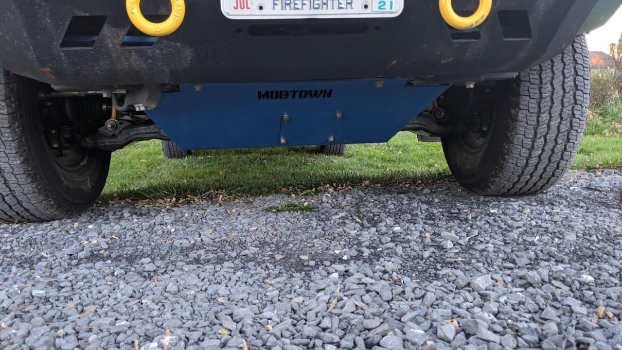

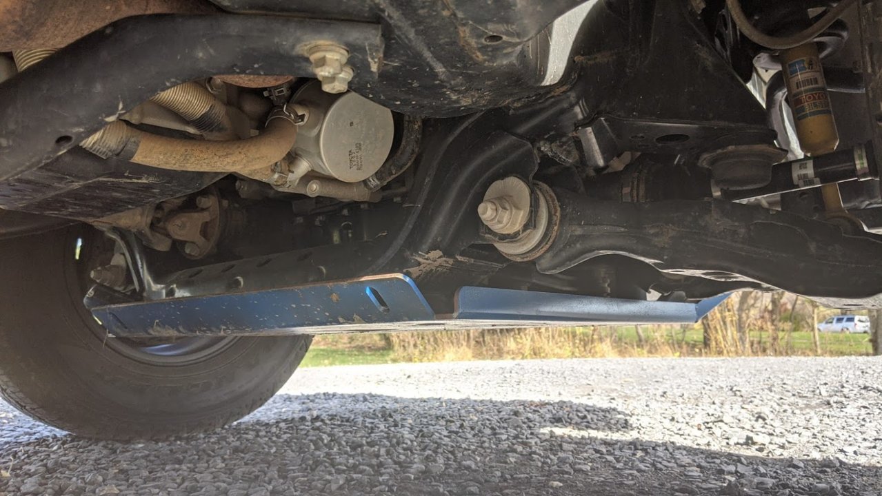

    Can you show some pictures of this post install? I am considering this same paint job and want to see if you can see the plate from the front and sides. Does this skid extend further back than the stock one - it looks like it does to me. This is my SR5 stock plate.

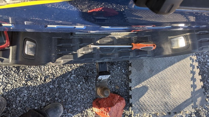

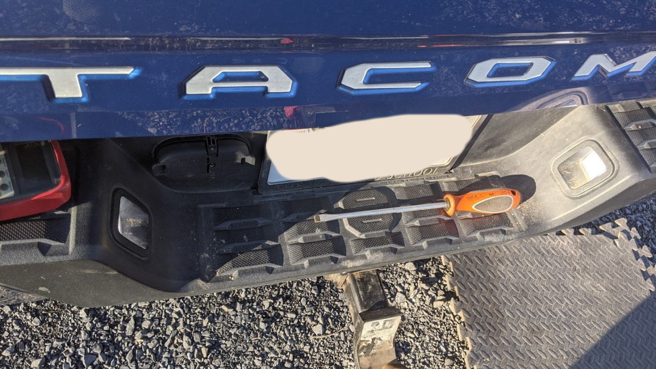

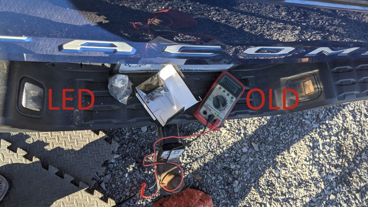

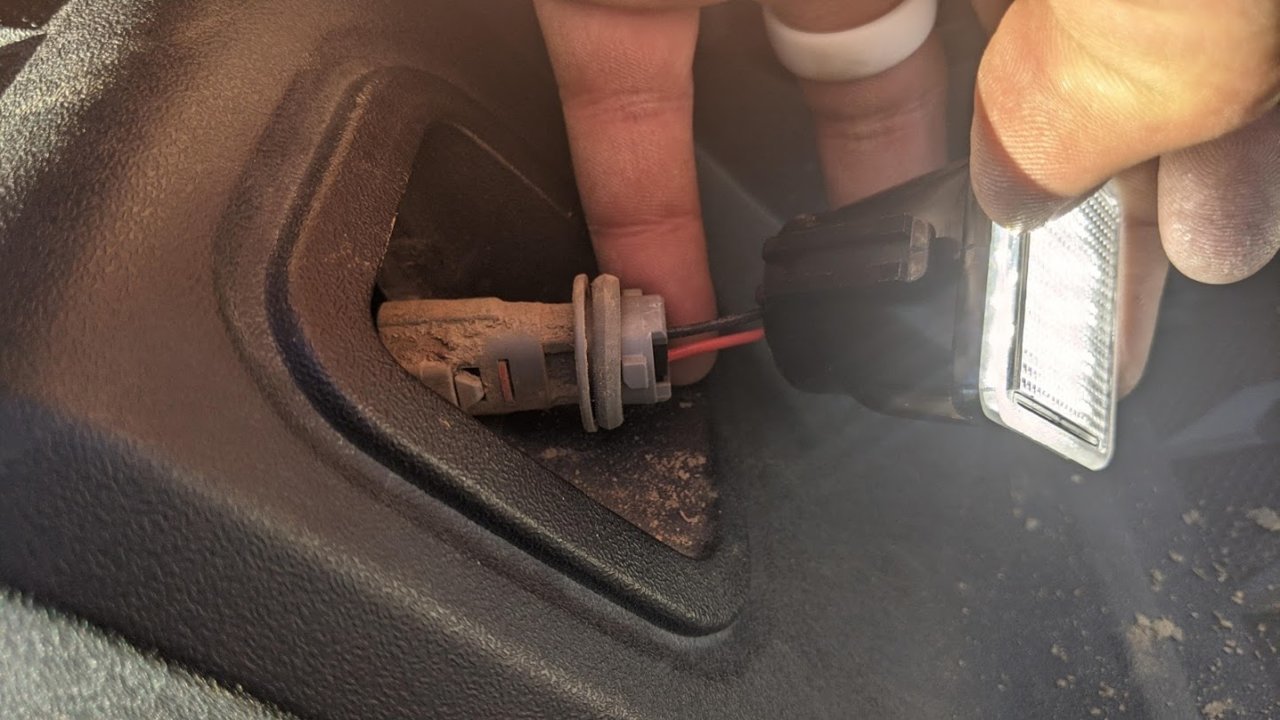

    had grabbed these LED tag lights some months ago for sale for cheap for around 12 bucks shipped and never got around to putting them in:
    install took 10mins and was super easy with the biggest flathead screwdriver to squeeze the clips to pop em out.
    Definitely bright in full sun on the drivers side compared to the old stock version.
    might be too bright for evening backup jobs in reverse

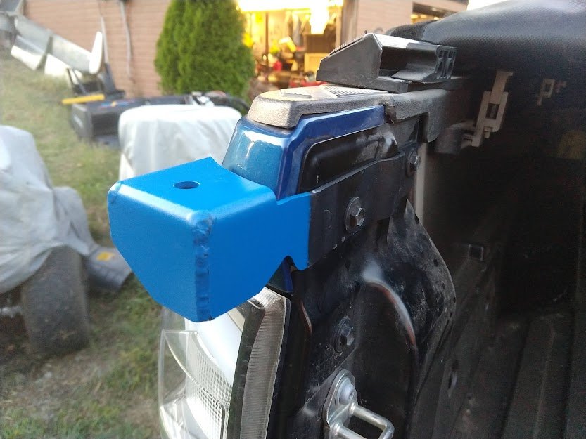

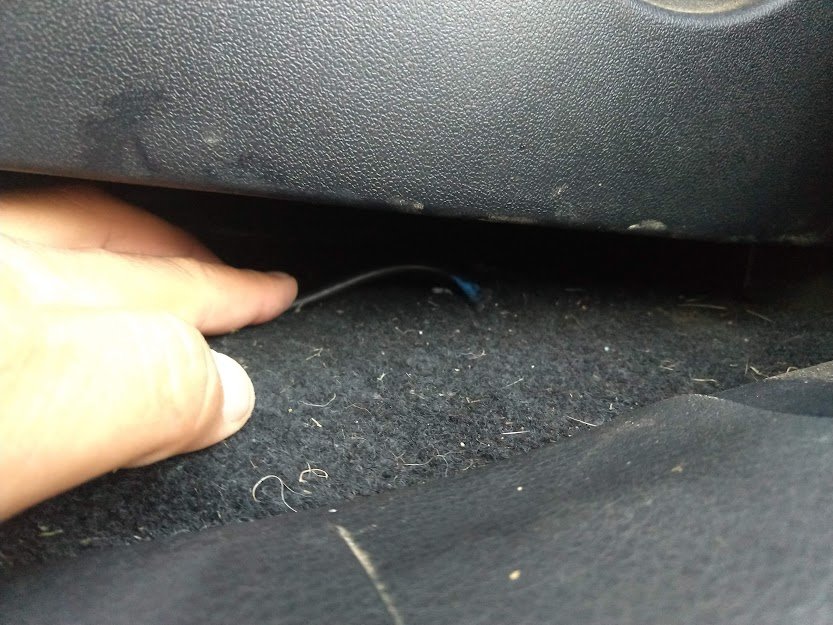

    Never mentioned mentioned the CB radio with the firestick antenna:
    AL9nZEUiZsHEtiQvbwLSZ19nOw2Jo2G_8y1ur5_b_f1eff956aa3fb2ae9fe0e6217e16383127616143.jpg
    painted in some blue color that was as close to blazing blue as possible

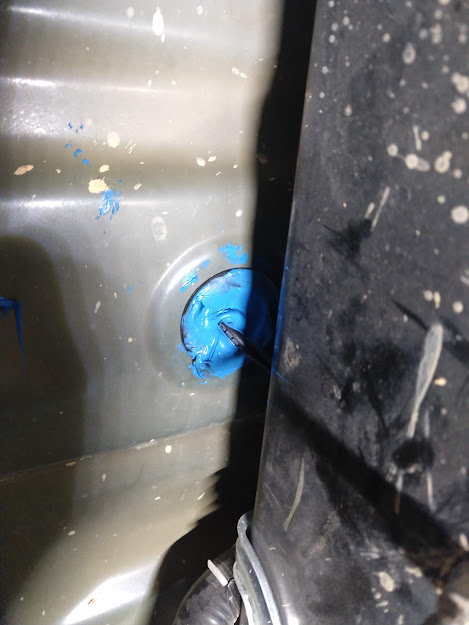

    ran along frame rail and the grommet coming through on the drivers seat:
    AL9nZEUcE-yzA-oPH-wIkv64YWu3IZU9tdn73dsW_56e8033542a5b897a6d161564a8455d833bb48f5.jpg
    resealed with RTV:

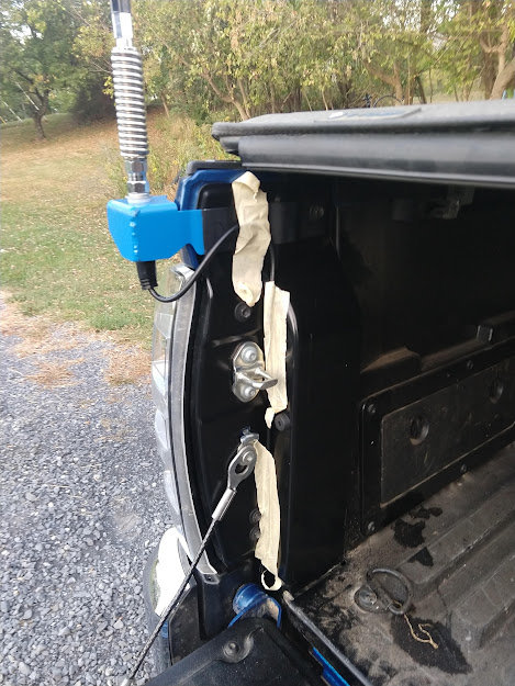

    Coax cable routed along gaps in tailgate and taped to get it to hold shape for the 1st week:
    AL9nZEUx9Y_AfenLFBzsN06F39s0zYz22qitmZtf_7adb0b87d8e2130cac2a2cd476580ba6f90729e3.jpg

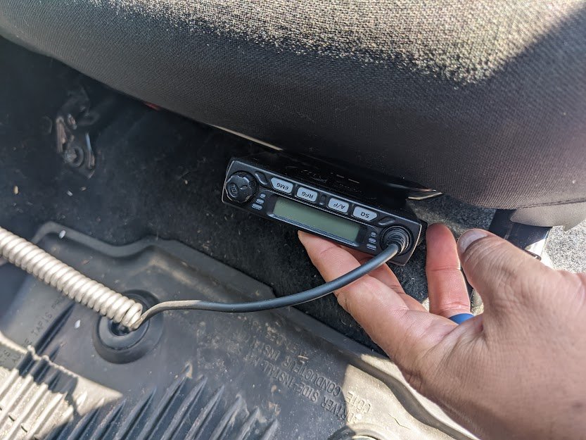

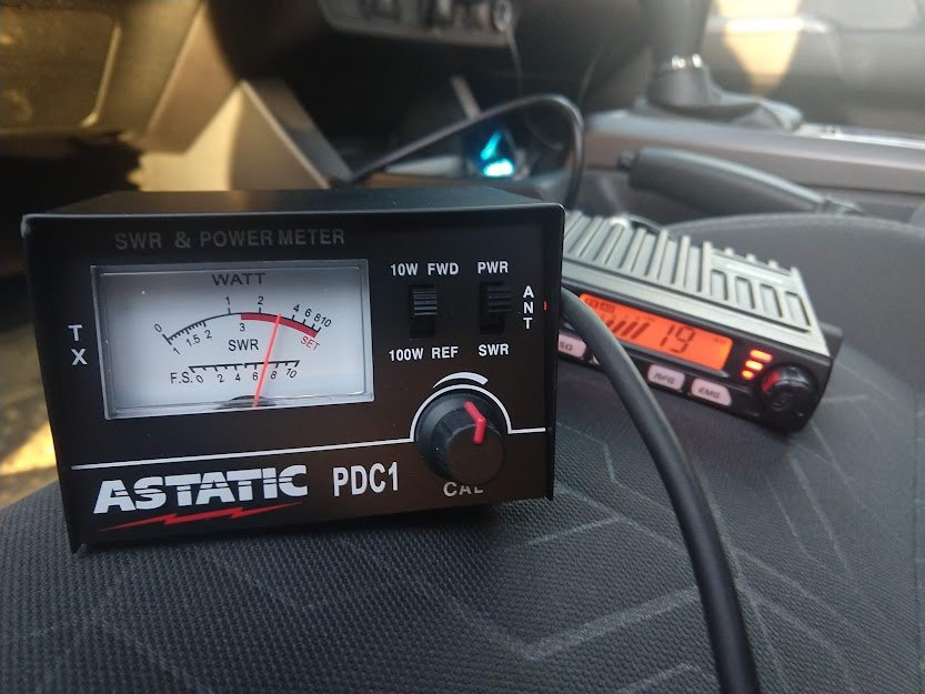

    slightly modified Anytone SMART CB (Albrecht 6110)
    AL9nZEXPkOK-3THUp_yeF5HtkJGaN3qb4zLB1X4N_79ddf3e66a4a0fd9f9d35cb3d841a9adb0a60462.jpg
    currently had been hiding under the seat and will need to get relocated once modified to go from 4/8W to 20W

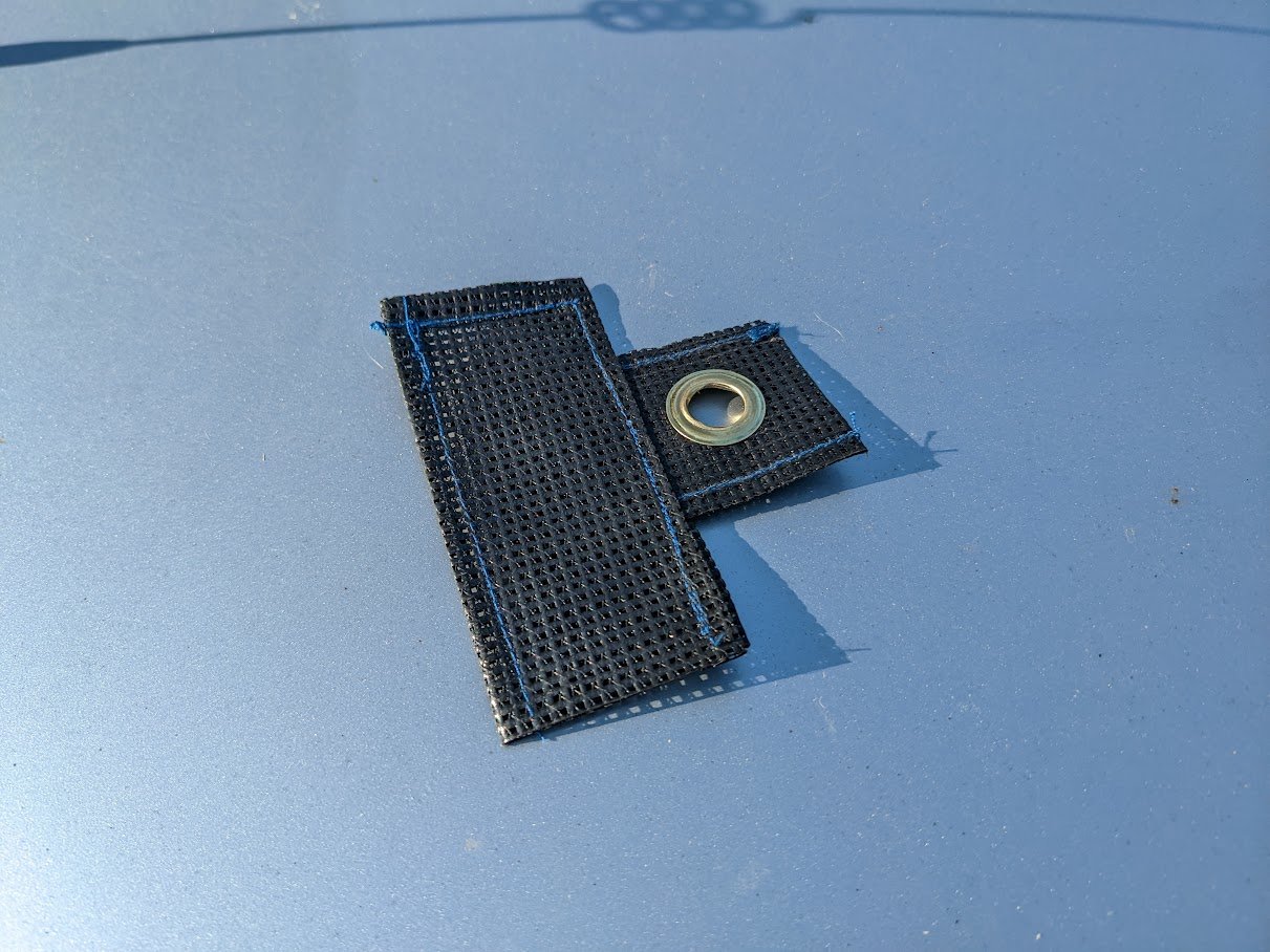

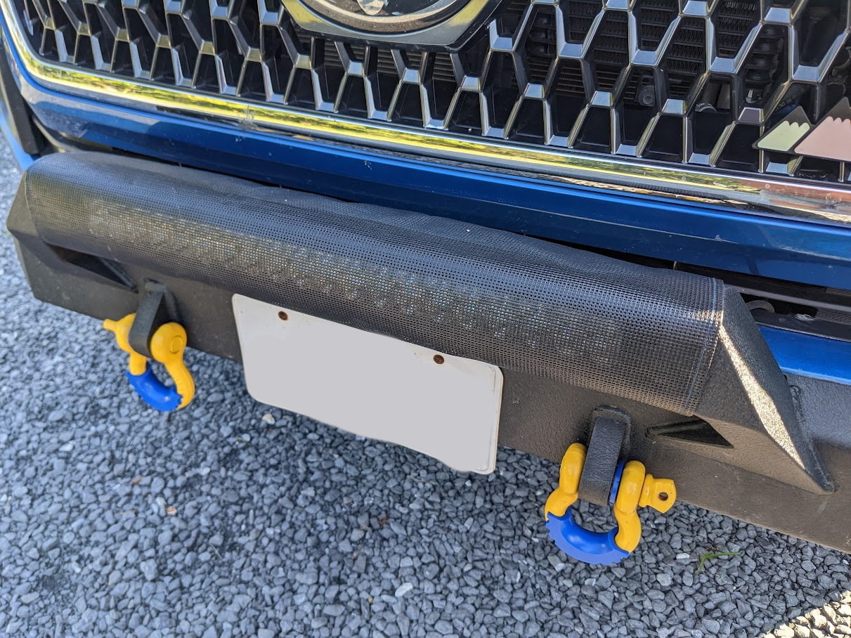

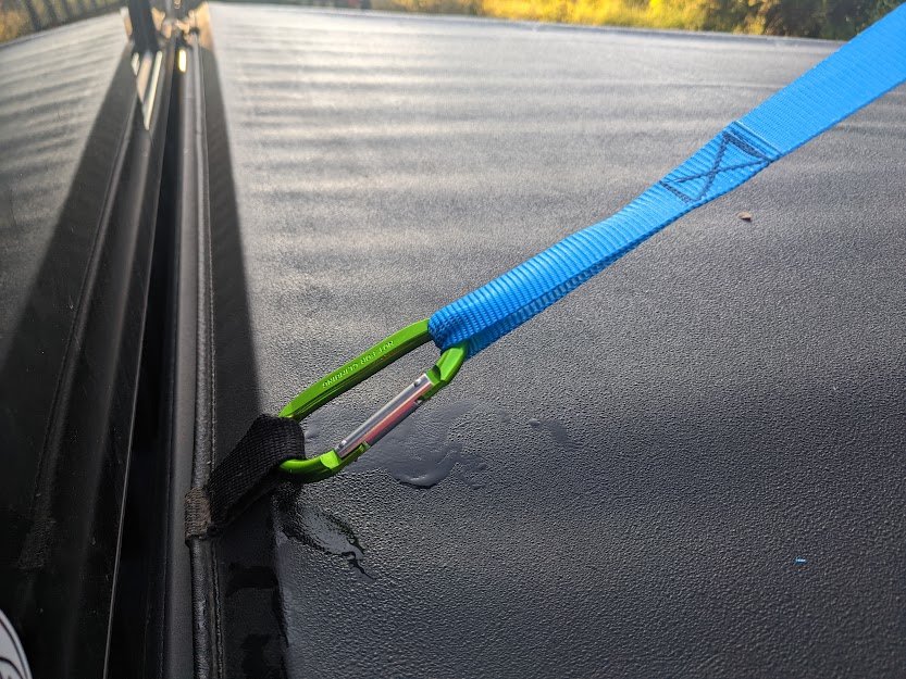

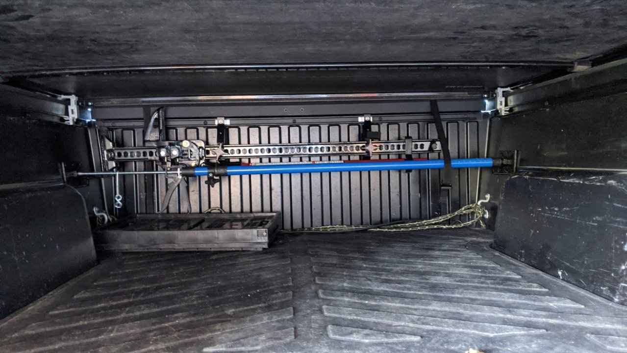

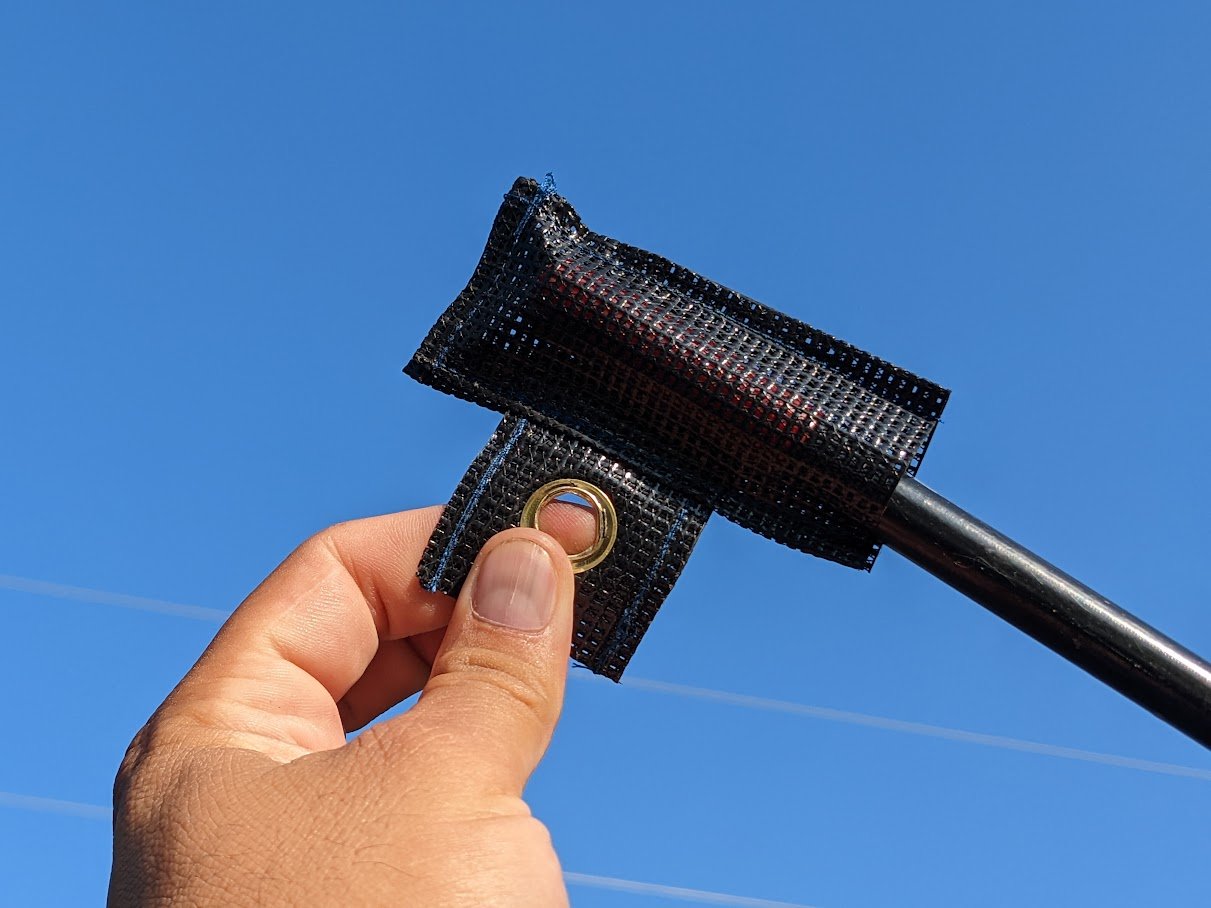

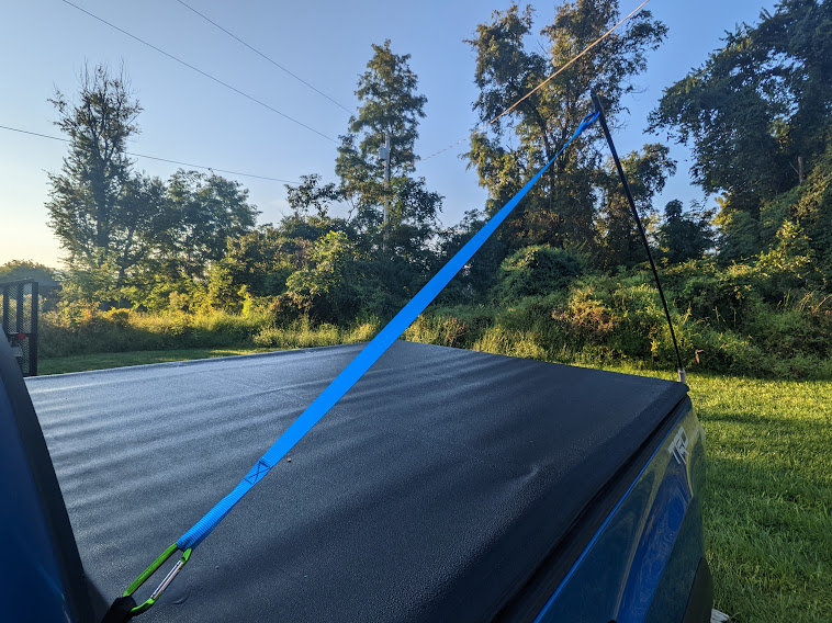

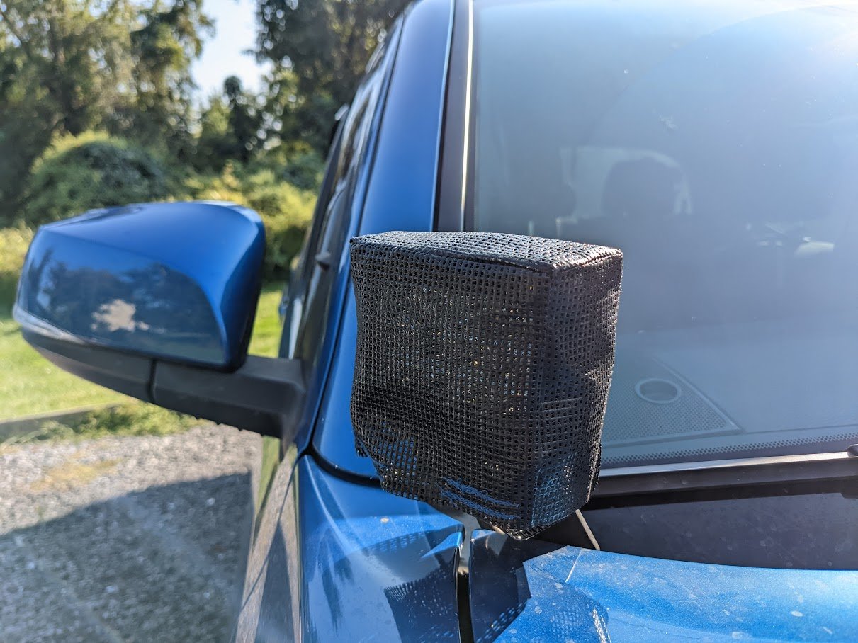

    Replaced the fabric aux light covers with some outside pool chaise stuff which is weather and UV resistant and allows for usage without removal:

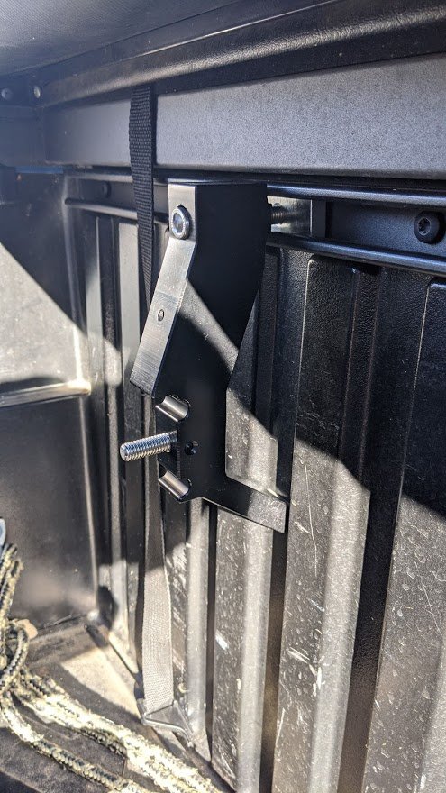

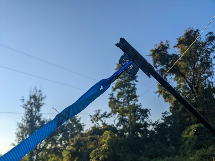

    Also had the wifey set up a L shaped firestick antenna cover/lanyard holder for heading in parking garages to reduce the height and the banging of the antenna on the roof:
    This allows either tie downs or a webbing strap with carabiners to be tied to antenna and hooks in bed to reduce antenna height.
