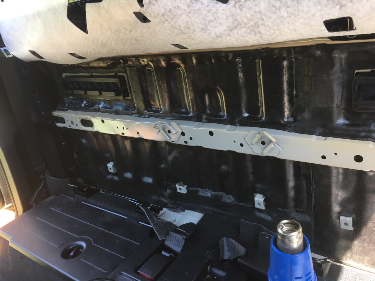

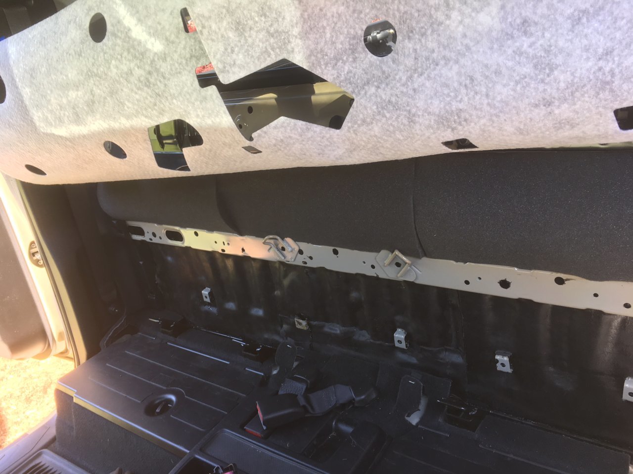

    6763CA1A-9972-4F4A-81E2-D23147134981.jpg C396DBA4-EA20-49C0-B11B-549CCCB74A91.jpg 9ACDFBB3-6767-4D38-9D2C-C77710DFB7BA.jpg
    This is what I used, between the pad and the foam it did help reduce the road noise.
