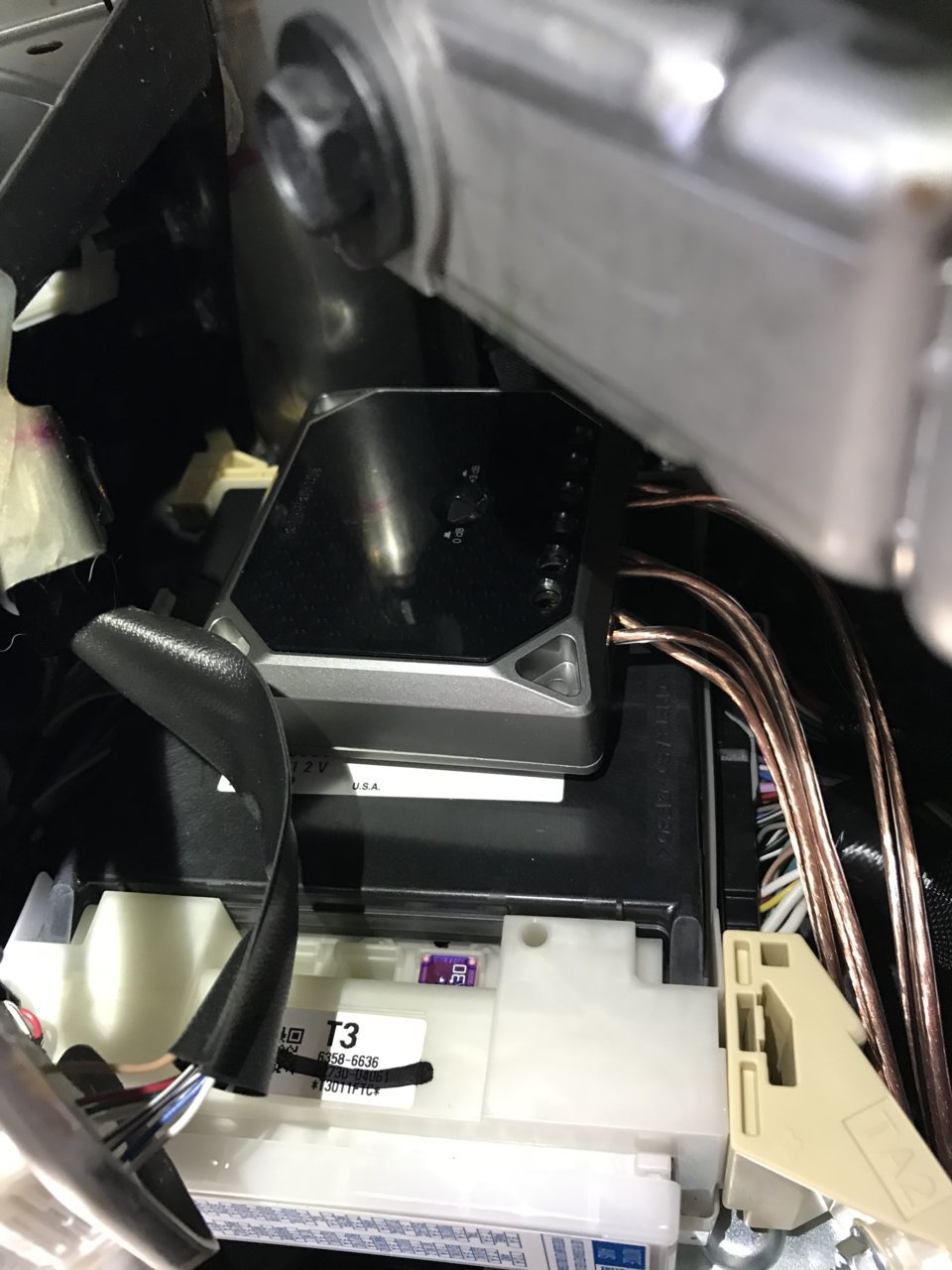

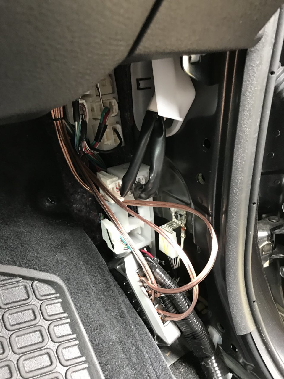

    @Falconsfan @myamada1230 Sure no problem.
    On the driver side, I originally had it mounted behind the kick panel on the flat white piece with all these electrical harnesses with some double-sided foam tape. Doing that gave me some significant interference noise, lots of whining from the tweeter. So I moved it up and mounted the crossover up under the dash on this black electrical box(?? IDK what it is, but its flat and out of the way. Says Denso on the side).
    As for the passenger side, its a lot less "nice". I just have it behind the kick panel between the carpet and body of the car. It's wedged down in there pretty well and doesn't move at all so :shrug:
    The hardest part of this whole thing was wiring at the tweeter/dash point. Not much room/wire to work with at all. But all I really did was use the ********* video for tweeter install to figure out which wires in the factory harness are input and output. They sell a harness for like $25 that can plug into the factory harness and run wires down behind the dash for a crossover, but I'm impatient and didn't wanna spend the $$ for something I could manage on my own. I just took some speaker wire and wired the IN +/- down to the input on the crossover, the OUT +/- to the woofer output on the crossover, and just wired the tweeter on its own from the crossover. Because space and wire is so limited at the dash, I had to use twist-on wire connections to tie everything together. Not a solder, but the best I could manage and it has worked flawlessly thus far.
