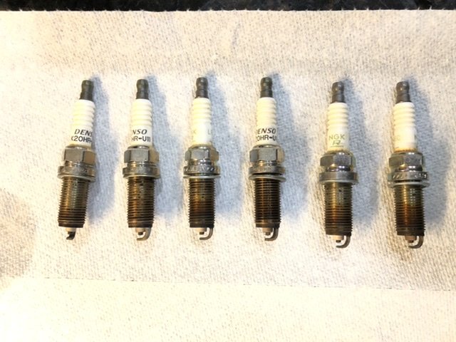

    I bought her at 32K from a dealership, didn’t know what the spark plug interval was then, didn’t see it in the service records. Anyway, from what I see it looks like these were the originals. How bad do they look to you guys?

    They don’t look bad.
    They are OEM, 2 different plug types.
    Factory Spec calls for 30k changes intervals.
    Looks like you did a fine job. :thumbsup:

    Yeah, I don’t know if you noticed.
    But you have 2 different plugs pictured above.
    That’s normal from OEM.
    I too went with just 1 type.
    Hook78[OP] likes this.

    Ha now I’m following. Didn’t notice at all! I wonder if they were grouped on each side of the motor. Weird.

    Yes, 3 from one head.
    3 from the other.
    Best guess is, the heads were assembled at different places?
    No one seems to really know why?
