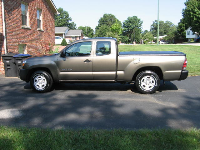

    Here is my little girl "Belle." My wife named her after Taco Bell. Here she is with the Nexen 235 70R 15's. IMG_3012.jpg
  12. Aug 27, 2017 at 4:47 PM
    nd4spdbh
    nd4spdbh Well-Known Member
    Oct 7, 2013
    #114055
    14,520
    SoCal
    13 DCSB TRD OR v6 Auto
    Proper lil truck. Such a shame they killed off the 5 lugger. For those that wanted good mpgs, and a low truck bed it was the best ticket out there!
