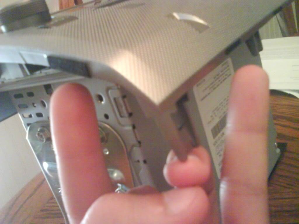

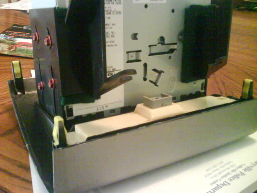

    Anyone else have a squeak issue with their dash kit? Mine Is a scosche. I had to pull it out and put felt tape on all contact points.

    I made a thread on this a while back. Definitely worth your time.

    After that it's not made a sound since.

    I had the same problem and used IS's advice on squeak reduction, but I used some of the loop side of some Velcro instead of felt.

    ^Nice! Use whatever you have laying around. It's all good.
