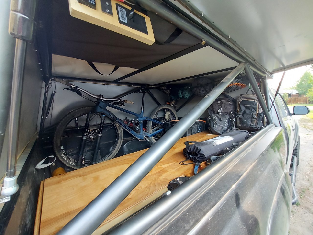

    Packing pretty light, but happy with how everything's fitting and that I have some open bed space. Just need to toss my clothes in and a few other things.
    All set to leave tomorrow. :thumbsup:

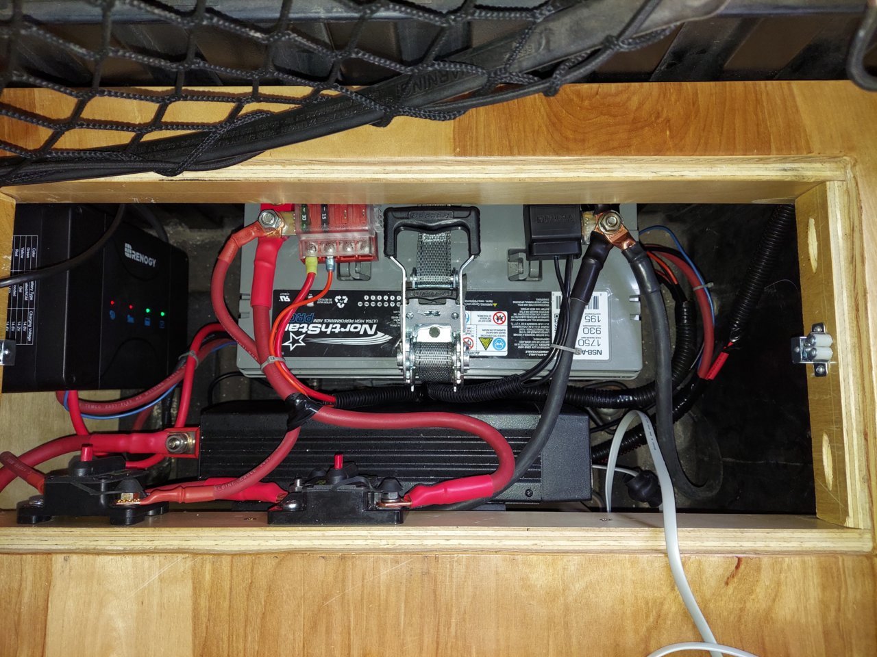

    What are the two breakers you have here for and sizes? I see one going from the DCDC to the house battery, is the other from the starter battery to the DCDC, or is that going to the inverter? If the later, do you just have it fused at the starter battery going to the DCDC? Did you use the ING 12+ wire?
  19. Dec 13, 2021 at 9:20 AM
    #159
    Squeaky Penguin
    Squeaky Penguin [OP] Nothing Ventured, Nothing Gained
    Apr 5, 2012
    #76340
    10,058
    Brett
    Steamboat Springs, Colorado
    '01 4WD, SR5, TRD & '13 TRDOR AC
    Lots of dust and custom dents, Check Build
    There's a 50amp breaker under the hood that feeds the DCDC. Then a 40amp in the back in between the charger and 2nd battery. The 2nd breaker in the back is for the inverter. I did use the ING+ wire and tied it to a fuse tap under the hood, but don't remember which one, just something that would only be on when the truck is running.
