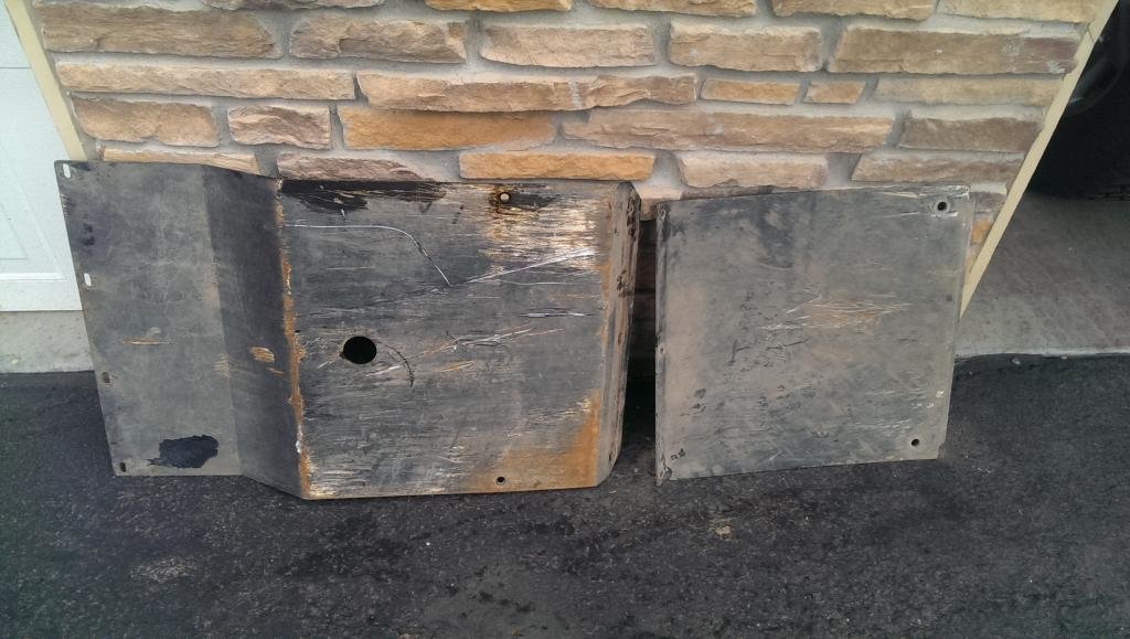

    Also, pulled my skids off for the season. They got some use for sure. All-Pro's idea of a transmission 'skid' I think is scrap metal. The IFS skid could use some modifications too, there's a nice little bend after the rear mounting bolts. Want to come up with a rear crossmemeber and a more solid skid from the IFS skid past the transfer case.

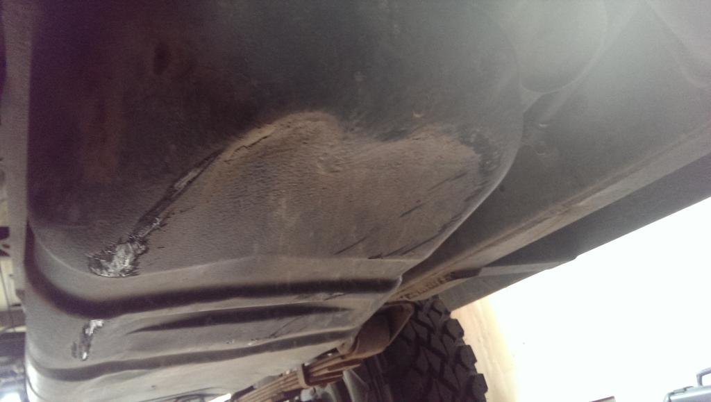

    Also for good measure, hit my gas tank on Chinamen's :bananadead:
    Maybe I should finally get around to getting a real gas tank skid.
