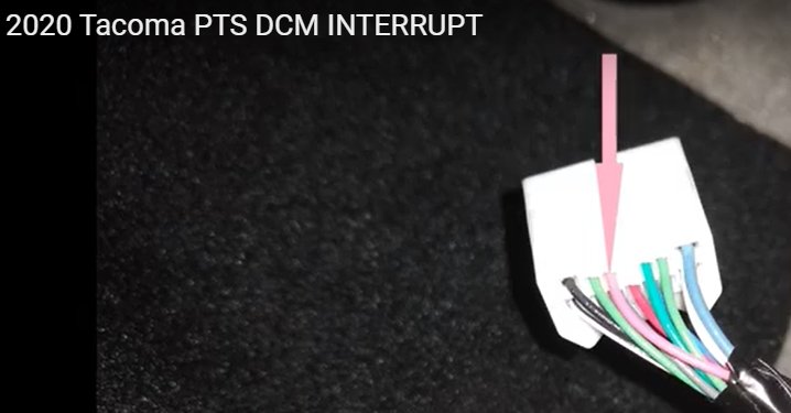

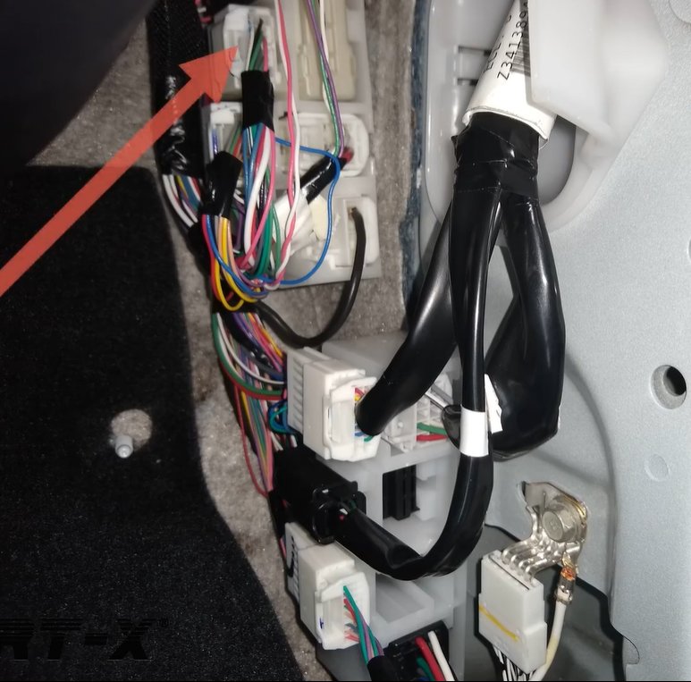

    N2 remote. I’m pretty sure the 2020 N2 also requires a splice...and I think that startx is out of NJ, they just sell their stuff on Amazon, their words.
    I don’t think I have the premium and I tried the fob lock trick like robmotive did on YouTube with no success.

    I installed the 2016 - 2019 version of this on my 2018 DCLB OR, and it's been working fine for a year now. I don't remember needing to splice any wires. I'm pretty sure it was just plugged into an existing cord, then you had to follow the directions to program it. Overall, it was very simple. For me, it was a great option, but some people prefer the cellular versions so they can start it from a far distance with their phones. A 50-ish ft distance with my fob is all I need.

    I purchased and installed the Start X from Amazon. It's labeled Start-x but it's appears to be made by Fortin. Fortin is a Canadian company that makes electronics components. From my research more than likely all the remote starts you see are Fortin products that are repackaged. https://fortin.ca/en/. Start-X, MPC and others. I did have to cut one wire but it was on the drivers side. It stops the tire pressure monitor light from staying on. That was the only difficult part because you do not have much wire to attach the bypass wire to. But I did it without much trouble. Just nerve wracking cutting a wire on a brand new truck. I also installed the hood safety switch so the remote start won't work if the hood is up.
