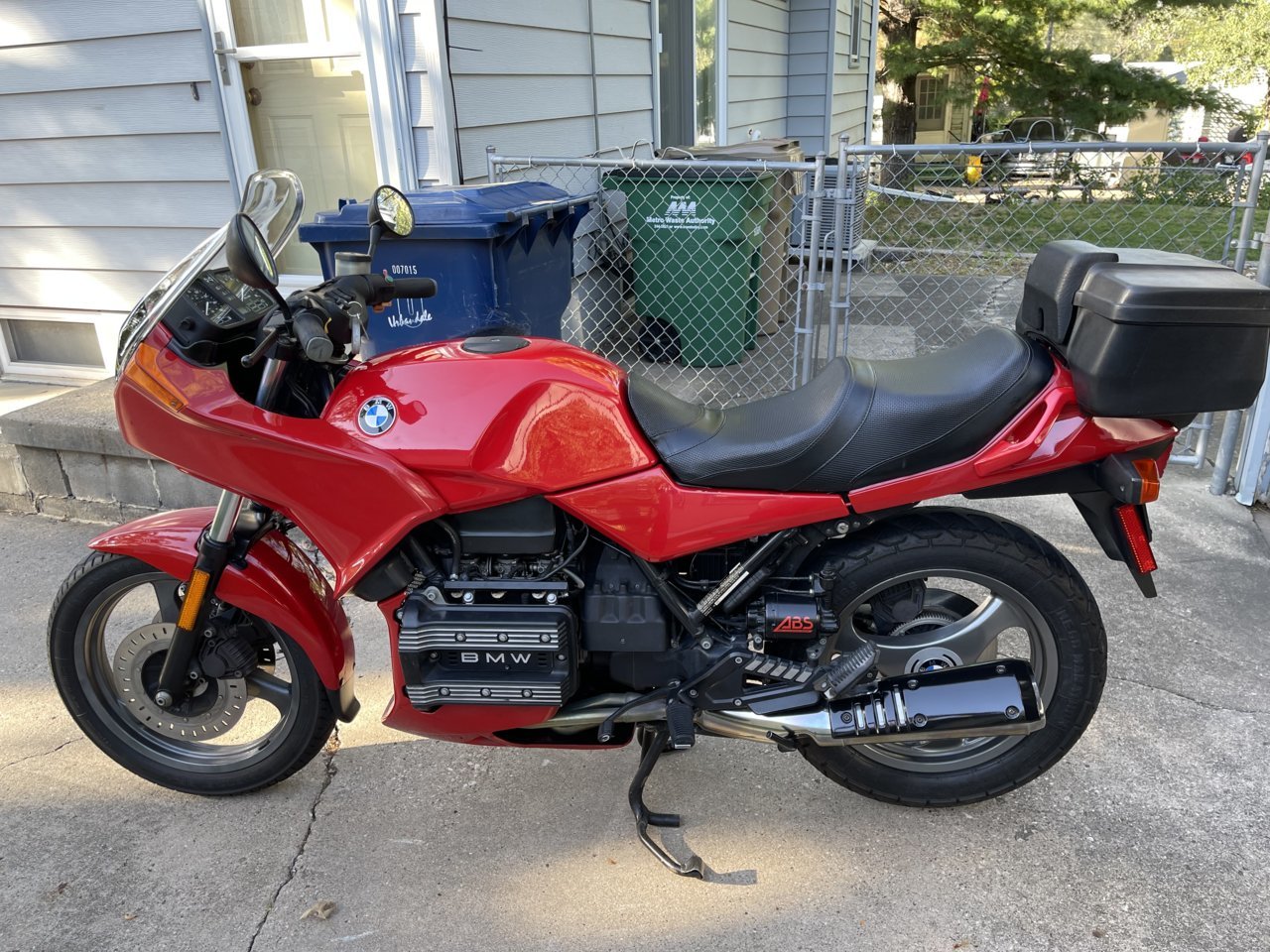

    Just had my starter and alternator rebuilt on BMW. Everything is working great.IMG_2522.jpg
