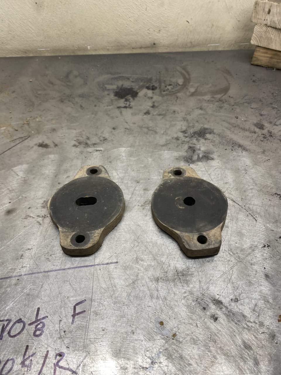

    I made these 1/2” spacers for the archive bumps out of some HDPE and I no longer need them. Free if anyone wants them. You’ll just need longer bolts.

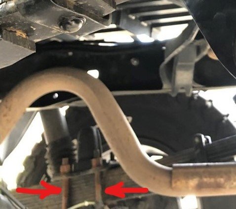

    To help TW members make educated choices and avoid aftermarket parts with issues, I'm sharing this evidence.
    Also, read about a TW member had multiple failures and finally replaced with our durable Option 3 U-bolt flip:
    https://www.tacomaworld.com/threads/the-brwntrd-hasnt-flopped-yet.653122/page-34#post-26811580
    https://www.tacomaworld.com/threads/the-brwntrd-hasnt-flopped-yet.653122/page-34#post-27350181
    Look at the misaligned U-bolts from this brand:

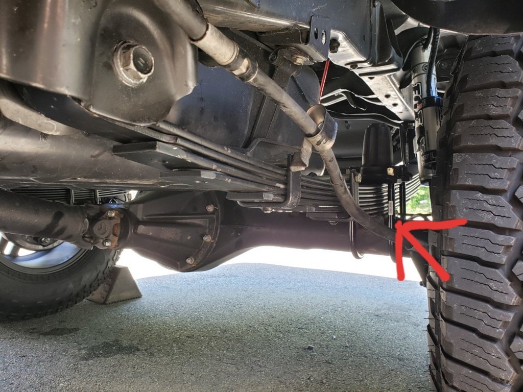

    The same brand has large gaps to sides of the leaves:

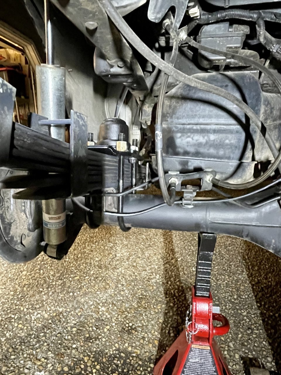

    I was just curious if he still had the spacers or if I was going to have to make some of my own. That’s good to know you guys will be making some but I’ll need something for my next wheeling trip so I’ll have made some by then.
    My next step is the shock relocate but in the meantime the b110 shocks have been awesome for what I use them for (low speed crawling). There’s no high speed wheeling around my area nor would I be interested in it. The truck is also not built for it. Prior to having the flip kit I had the stock bumps, with a homemade spacer that they would strike up on top at the frame. With the b110’s and that setup it was fine, I just wanted the extra clearance under the axle and got tired of getting hung up at that point at times (just eliminating another point of contact). Also the added benefit of a softer bump is a major plus.
    Here is a pic of the axle on jack stands and the amount of bump travel I have, which is more then enough for the wheeling I do along with daily driving it. Sacrificing bump travel for added droop was my focus. Shock relocate and the hangers will be next on my list.
    In this pic the rear is not even fully cycled with my previous setup (prior to the flip kit) with the home made spacer.

    I junked these but they were easy to make if you wanted to make your own

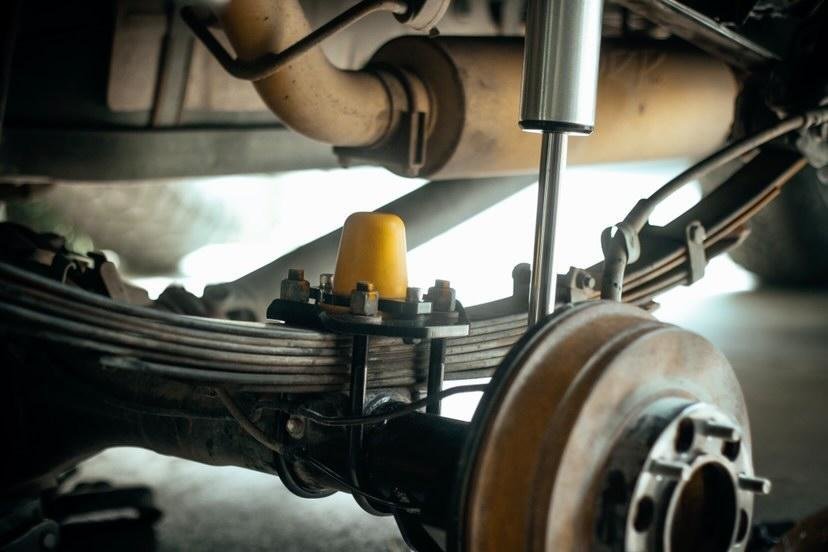

    Option 3 Archive Speed bumps are 3.25" tall above Ubolt plate.
    By design it is a little taller than a stock bump stop to start working sooner at slowing weight down so that it is more progressive feeling than a stock rubber bump which is more like a light switch on or off. Option 3 has a soft intial engagement, but compresses significantly to about 1/2 it's height.
