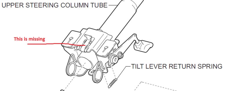

    They said to replace the entire column because the collapsible joint came apart, and they put it back together out of alignment. It looks like the mounting tabs are bent, probably from driving and adjusting the column with loose mounting hardware.
    Loose hardware, you push the column forward, slip/collapse joint collapses, column drops off mounting hardware, you pull column while trying to adjust, column ends up in your lap.

    No. I can see in the picture that the mounting hardware is loose, the mount uses open slots with the opening towards the driver, the slip/collapse joint is separated, and the column is not where it is suppose to be.
    Other option, story is BS and OP loosened the hardware, pushed the column forward, then yanked it backwards. Either way, an open slotted column mount is a piss poor idea in my mind.

    Looking at the mechanical prints and I agree with you 100%.

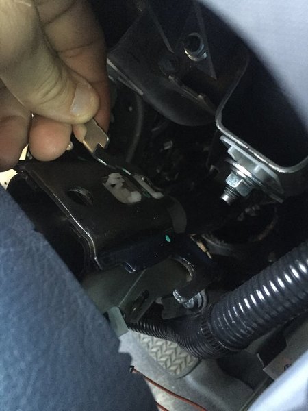

    These Nuts ( not bolts ) do not hold the column tight. The column telescoping feature uses these nuts as a telescoping slide.
    Look at this picture and you will see one of these nuts with a spacer behind it for the shaft to slide on:

    Not really scary at all as long as you don't abuse the steering wheel in a fit of rage.
    See the device the dude is holding in the picture is the stop device that prevents over traveling of the telescoping column. Don't break it and you will be fine.
