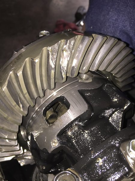

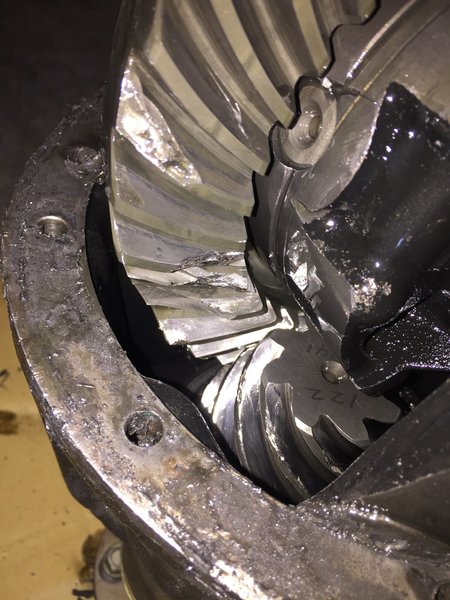

    Great write up! Didn't get the correct gearing I wanted but at least I can drive the taco. Here are some pics of how bad the ring and pinion was. Hardest part was bending the brake lines, super sketch!image.jpgimage.jpg
