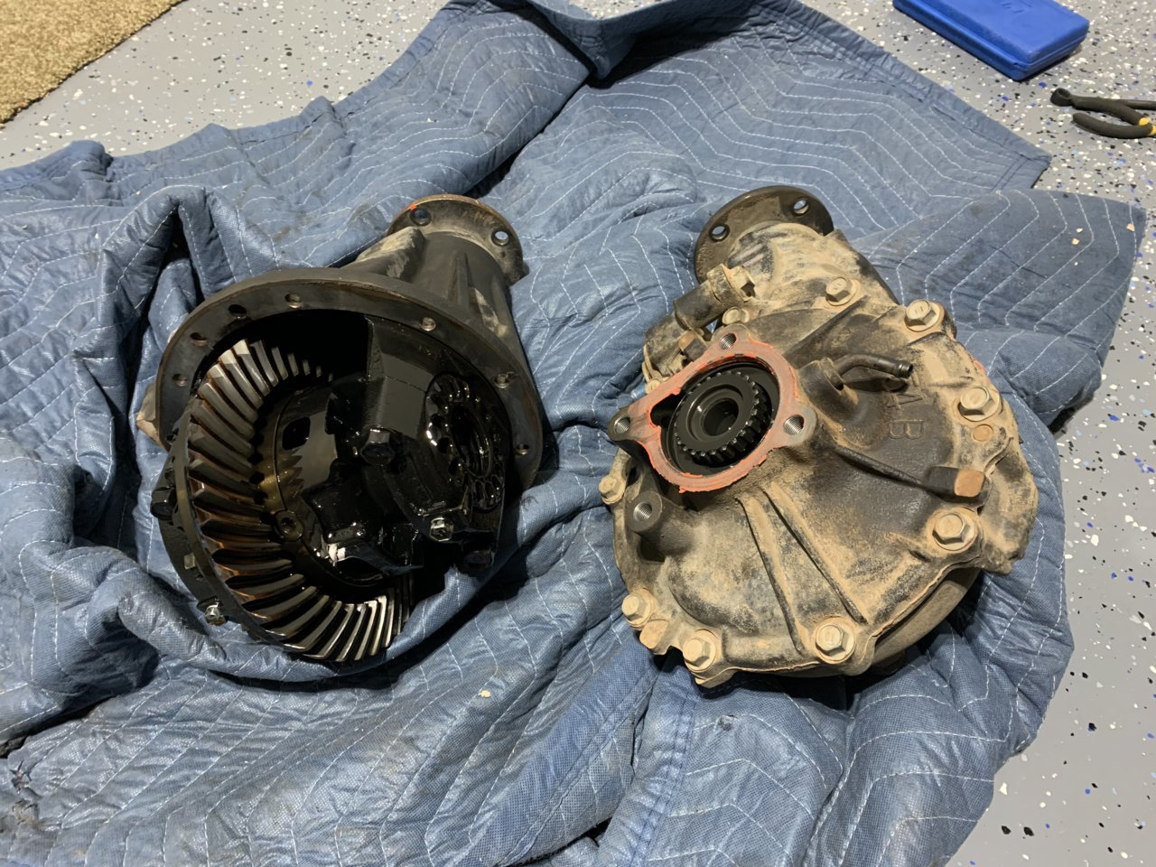

    Just pulled the 3rd to replace the seal
    220k miles on the oem seal and 3rd.
    moved the locker gear all the way over and couldn’t get the diff out, then I was able to move it even further after messing with it. Got the diff out, cleaned everything and ran a bead of ultra grey. Installing the 3rd and just as I start to connect the two some gear oil runs out the 3rd right in my bead of RTV :anonymous:.
    :fingerscrossed:Praying It doesn’t leak
    Done this 3 or so times on my last tacoma and never had an issue with leaks.

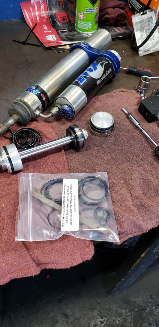

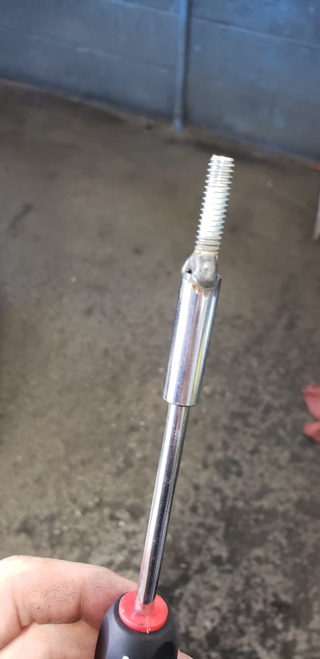

    Good job dude! but looking at your passenger side rear shock, it needs a new main seal. They aren't too bad to replace and the seal kit is just a few bucks. There are plenty of tutorials on YouTube that are helpfull..
    You'll also probably need something like this to pull the piston out..

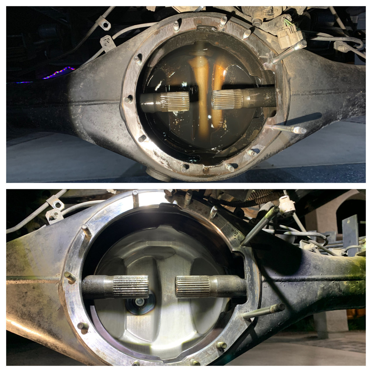

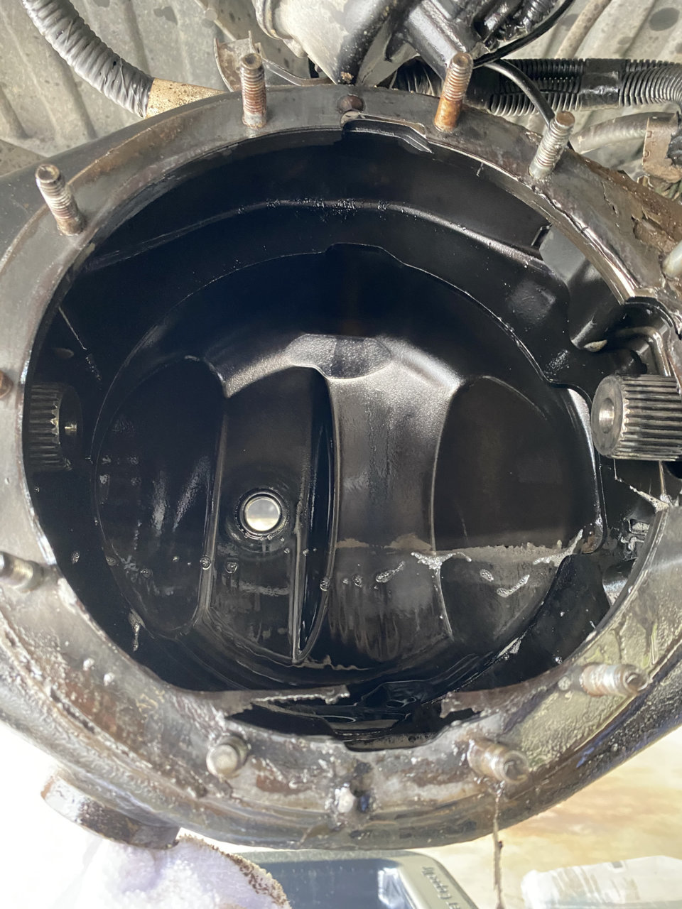

    What an incredibly helpful thread, THANK YOU OP. This wasn’t tough at all. Only thing I noticed was I thought the E locker gizmo was moved all the way to the middle of the diff but after turning the pinion slightly while pulling the 3rd member I realized the little locker gizmo had a lot more to move to be able to remove the member. Piece of cake! Also did a THOROUGH clean of the rear axle housing. Also I found that a good piece of cardboard on your chest will make catching these heavy babies much more comfortable

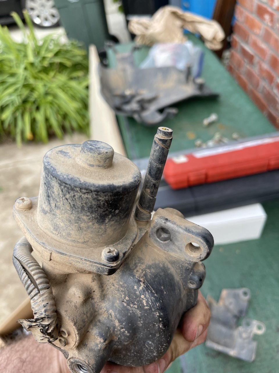

    When I pulled the e locker this came out. do you just insert back in or is this a bigger issue.
  14. Jan 30, 2021 at 3:11 PM
    #414
    MonkeyProof
    MonkeyProof [OP] Power Top
    Oct 7, 2008
    #9774
    12,792
    SoCal- SGV
    no issues, just make sure that hear an audible "click" when you push in the connector back into it's correct spot.

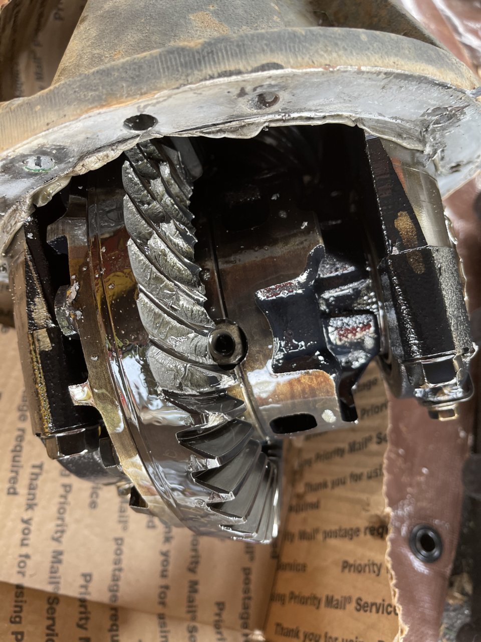

    What a great write up! Am glad to have the new 3rd in my truck. All this makes me wonder, though, if this is a mileage (fatigue) issue or a strength issue? Mine busted at 156,000 miles. I don't think the truck saw much 4-wheeling (except snow) until 125,000 miles, when I put 33's on. The way they all seem to break makes we wonder if the housing flexes and puts more strain on the outside of the ring gear.
