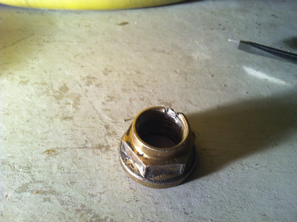

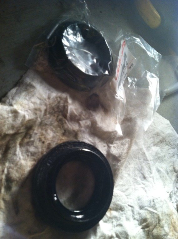

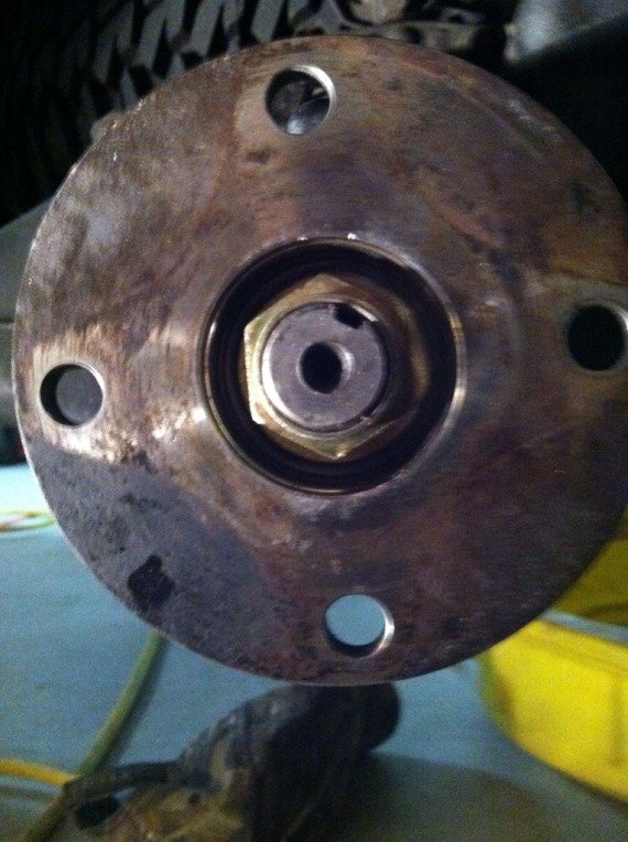

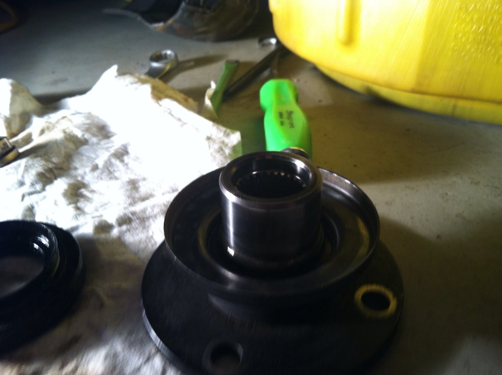

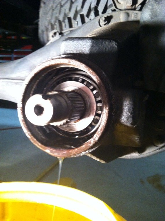

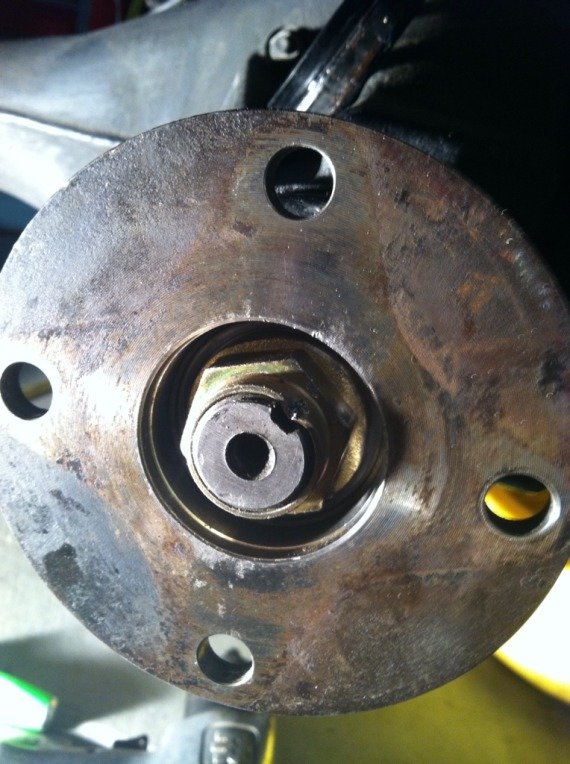

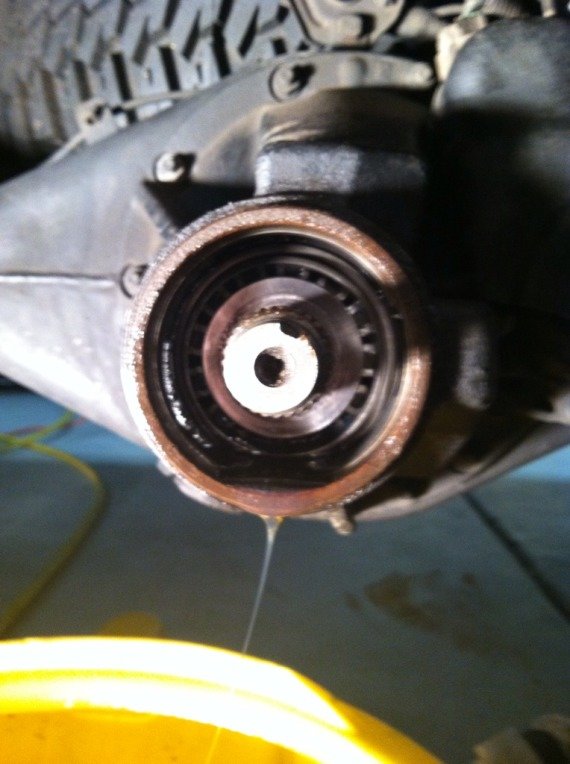

    Just thought I'd throw this in here.
    C99858A4-4B8B-4DC3-A39E-AFF016A5262D-448_662beb247d8bd13e7f1505ffc18c93bbc7fbc85b.jpg
    43BE29FE-FF02-40D4-989F-E28D639E7DFE-448_ee4e68e10386f84c3e993ff59b7ec79e518d0de0.jpg
    13C9AEFA-53FC-471F-A93F-FFFB76F590B0-448_b9466581b9139ca90384bdf8cb7f645905fac35c.jpg
    853AF53B-2419-41E0-935E-1E7FB461867D-448_8eeb639517faf379c825061bb7f02efcccdd60f2.jpg
    2501F478-040C-483C-8E71-FA883F63D2DA-448_af4770ffe8550611623675484b128a5ee4a3ce8a.jpg
    AC6CF35A-F739-4D2A-9F08-FCCD889DCF1D-448_22158ea069357d0c7ed51dfd319b26c870286f09.jpg
    621B3519-3848-445A-BDA2-7367DC888A7F-448_4777408c27764f71f085c683d04d9385f3bb27aa.jpg
    Fucking seal was all crooked in there, the flange sealing surface looked good and the seal looked good but the whole thing was cocked sideways, noticeably. Probably could have just sat it in there fully and square and it would have worked but I replaced the whole thing and cleaned everything up. Chase at ECGS sent this out for free, new nut and seal, got it quick! Easy because I have a solid sleeve. 200ft lbs and stake it. I also threw a little RTV on the splines for good measure but there was no signs or leakage from there when I took it apart.

    I think it was like 20$ or something, ECGS paid for it all. It was hard but I was able to get under the torque wrench and push up for all I was worth until I heard it click. My old ass IR 1/2 impact had no problem taking it off btw, staked and all.
    As for the seal, I tapped it in evenly using a drift and a hammer.
