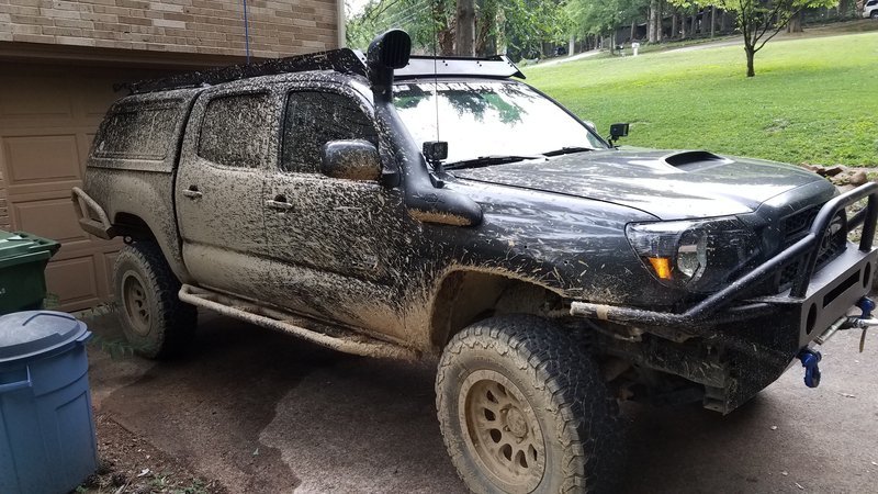

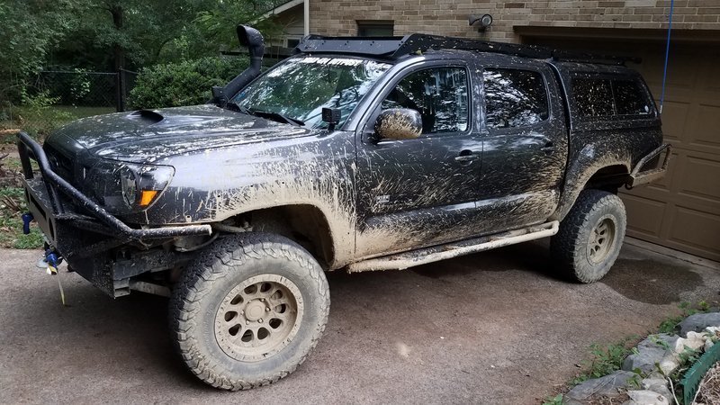

    Welcome, this is my build thread for my 2011 MGM DCSB Tacoma Sport 4WD.
    Thankful for Tacoma World and all the people in it for motivation, inspiration, assistance, and just like-minded friends.
    Pictures are organized by modification type (interior/exterior/suspension/armor/miscellaneous) below. Any and all criticisms and compliments welcome, enjoy!
    Current mods:
    Interior:

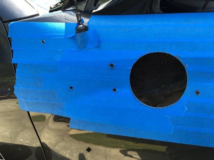

    • Interior LED Lights - Thanks to @MedlinAround Kit Here
    • Gauge Bezels, Tweeter Bezels, Vent Trim, and Bottom of Shift Knob Painted Blue
    • Door Panel Pieces for Window Controls Painted Black
    • Center Console Organizer Bin from Target
    • Wet Okole Full Piping Seat Covers, Black with Cobalt Blue Piping
    • Treat-A-Dog Pup Protector for the backseat to carry my dog
    • Weather Tech Floor Liners in Black
    Communications:
    • Cobra 19 DX IV Compact 40 Channel 4 Watt CB Radio with RF Gain
    • FireStik II FS4-BB 4' CB Antenna Easy Tune Blue
    • 18' RG-58A/U Coaxial Cable With Pl-259 Connectors
    • Firestik SS-3H Heavy Duty Stainless Steel Antenna Spring
    • Rectangular External Communications Speaker for Ham Radio, CB & Scanners
    • Firestik K-4A Stud with Screw-On Coaxial Termination for Antenna Mirror Mounts
    • FireStik K-1A Push-n-Twist quick disconnect

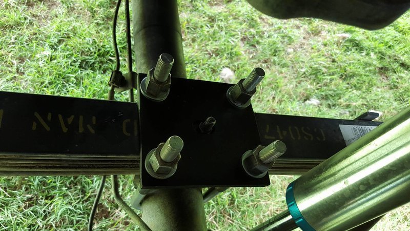

    • @Shmellmopwho's Driver Side CB Antenna Mount
    Exterior:
    • Black Badges and Black Grill Emblem
    • Removed Fender Flares
    • Removed Mud Flaps
    • Diff Breather Relocate
    • Redline Tuning Hood Struts
    • Cali Raised Side Projecting Ditch Lights and Brackets

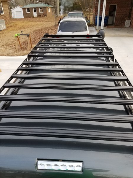

    • SOS Concepts Bed Rack
    • Tacoma Bed Mat
    • Black CVT Trasharoo
    • Stock Exhaust Cut Above Axle and Rerouted
    • @Bentrodder Bed Supports

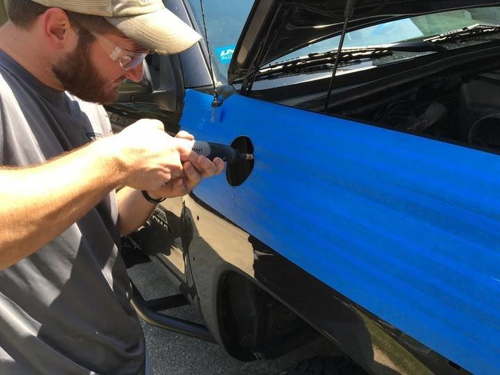

    • Fenders trimmed 1.5" all around
    • Extreme CMC

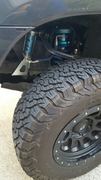

    Suspension:
    • Front:
      • Total Chaos Uniball UCAs
      • Sway Bar Removed
      • King 2.5" RR Extended Travel Coil-over Shocks w/ 700# Springs from DSM 25001-119-E (removed)
        • Extended Length: 21.687 Inch
        • Collapsed Length: 16.750 Inch
        • (installed at approximately 115k)
      • Dobinsons MRR front with 730# springs

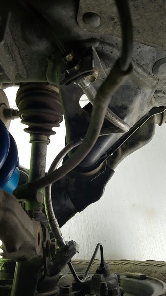

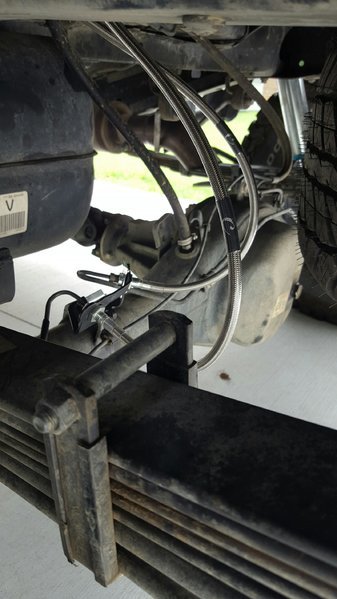

      • 4" SS Extended Brake Lines
    • Rear:

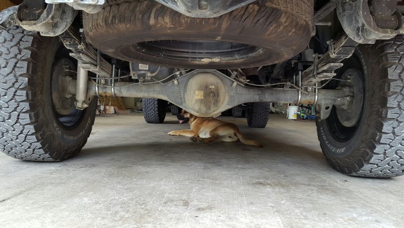

      • OME 2.75" Lift Dakar Leaf Pack w/ AAL
      • U-Bolt Flip (Modified Low-Range Flip Kit)
      • Wheeler's Super Bumps Bumpstops
      • King 2.5" RR Extended Travel Rear Shocks from DSM 25001-121-Dakar (removed)
        • Extended Length: 25.54 Inch
        • Collapsed Length: 17.08 Inch
      • BAMF Shock Relocation and Bilstein 5125 14" Shocks
    • Performance:
      • ARB RD129 Air Locker in rear
      • ECGS 4.88 Gears installed at 153,910 miles.
    • Wheels & Tires:
      • SCS Ray10 17x8.5 Matte Black Wheels
      • 35/12.5/17 Treadwright Guard Dogs (Installed 153,430)
    Armor:

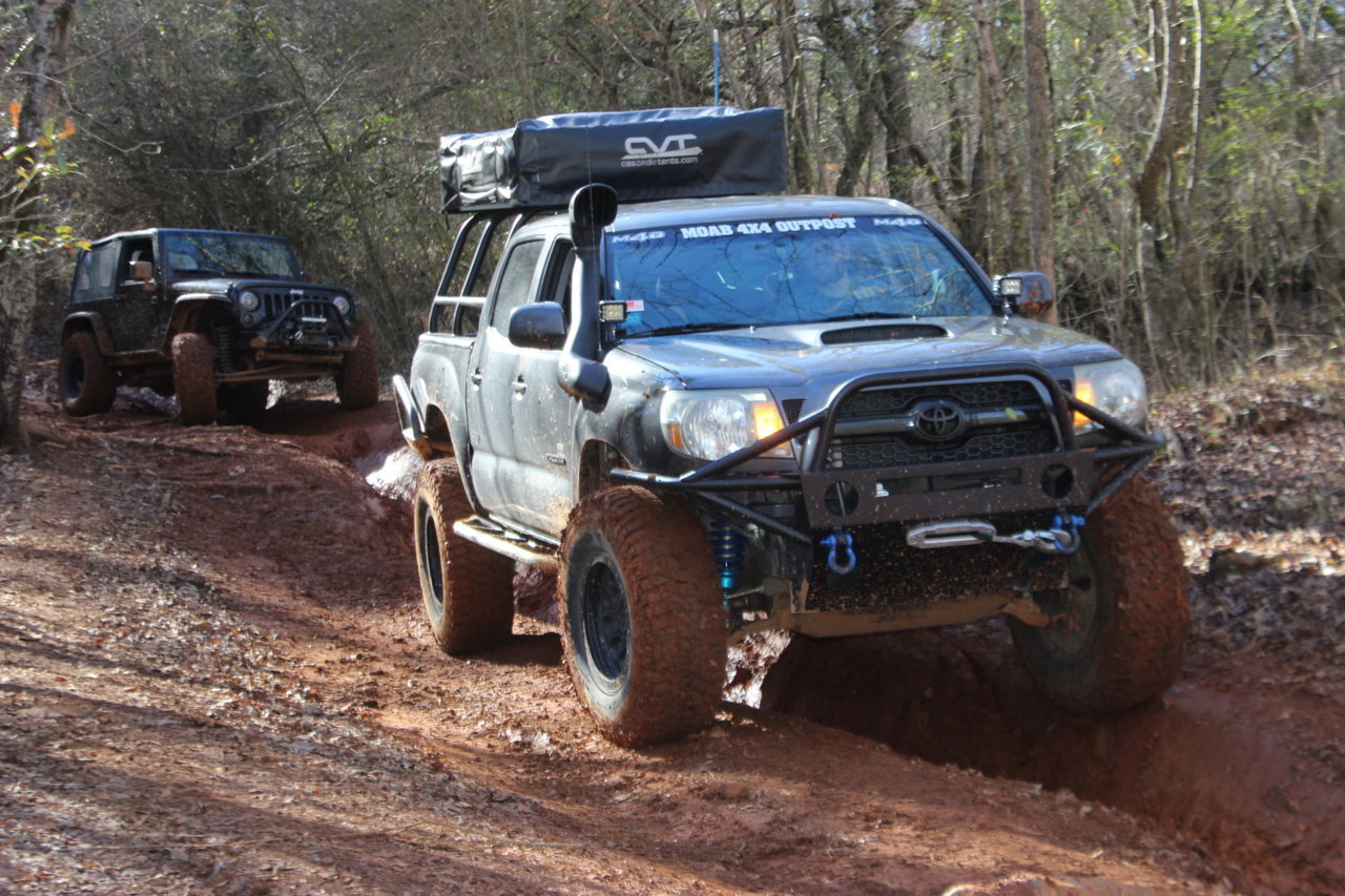

    • Custom Rock Sliders by Taylor Welding, LLC (Instagram: taylor_weldingllc)
    • Custom Hybrid Front and Rear High Clearance Bumpers by Hammock Welding and Fabrication
      • (4) Blue 3/4" Reteck D Ring Shackle, 9,500 Lb Capacity w/ Daystar Isolators
    • SOS Concepts Skid Plates
    Maintenance:
    • Oil Change, Tire Rotation/Balance, and Alignment ~every 5k miles
    • ECGS Bearing Replacement
    • BFGs put on at 108k miles
    • Front Diff Fluid Replaced 116k miles
    • Replaced Alternator October 2017 after Black Mountain
    • At ~150k miles:
      • Replaced Driver Side CV Axle
      • Replaced Passenger Side CV Axle
      • Replaced Inner and Outer Tie Rods (Pass and Driver)
      • Spark Plugs Replaced
    • Replaced Driver and Passenger Wheel Bearings/Hub Assemblies at about 151k miles. Thanks @BamaToy1997!!
    • Guard Dogs put on at 153,430 miles
    • Diff Fluids changed 153,910, and again 500 miles later with gear break in.
    • Drum brake shoes changed at 153,910
    • Energy Suspension Radiator Bushings
    Other:
    • Hi-Lift Jack w/ Base Plate, Handle Keeper, and Slider Adapter
    • Tow Strap
    • Ratchet Straps
    • SuperWinch Tiger Shark 9500 SR
    • ARB CKMP12 Portable Air Compressor
    • EZ Tire Deflator (gift from TWSS)

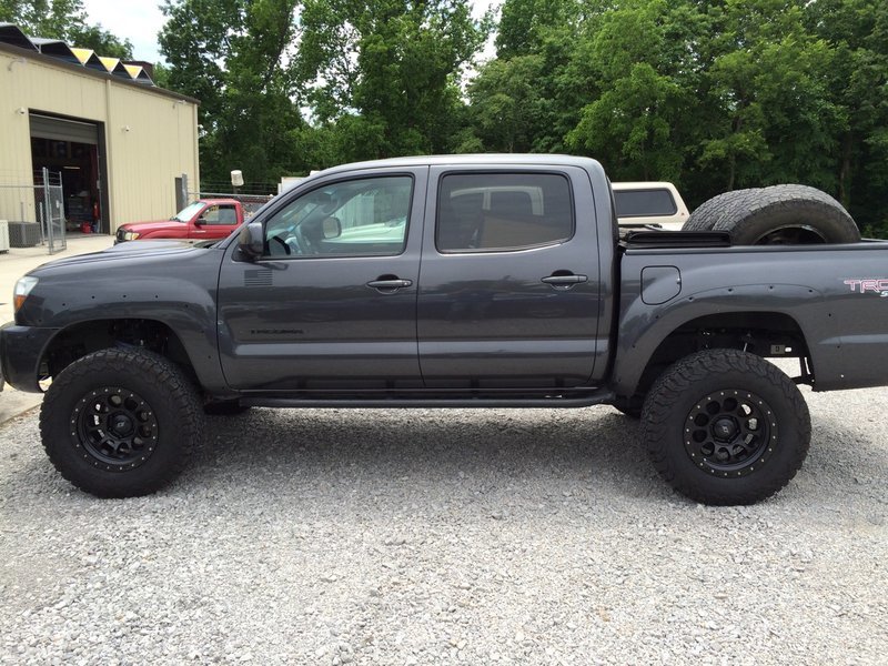

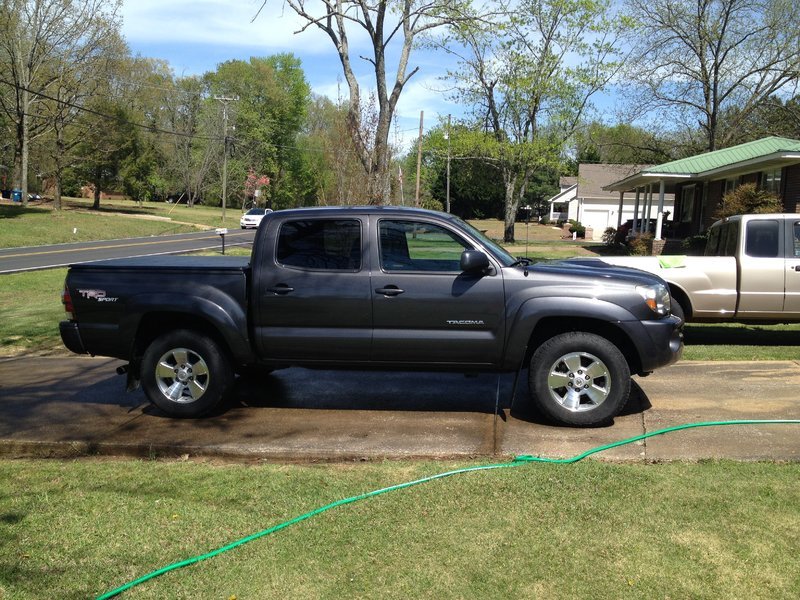

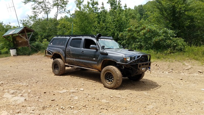

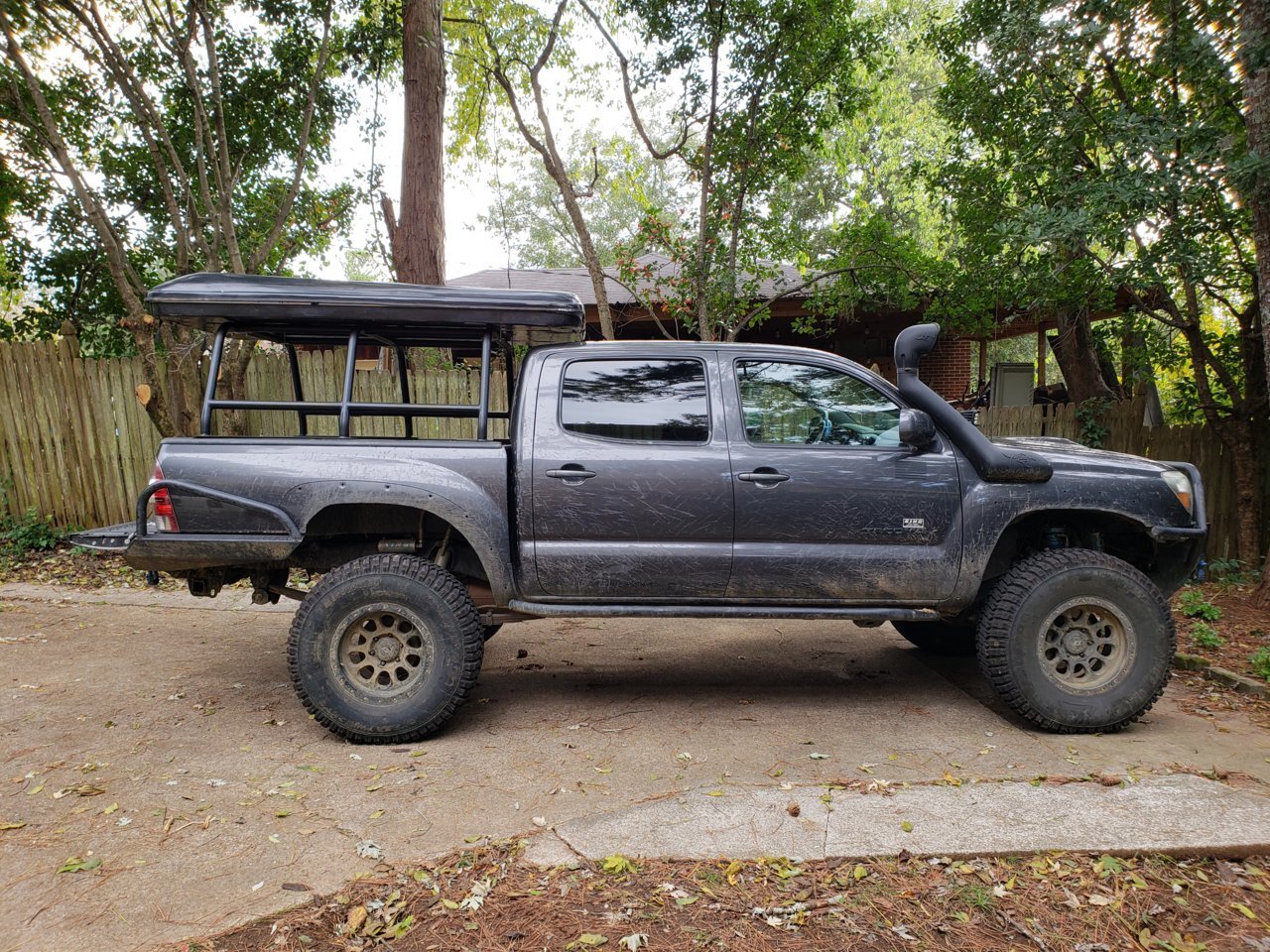

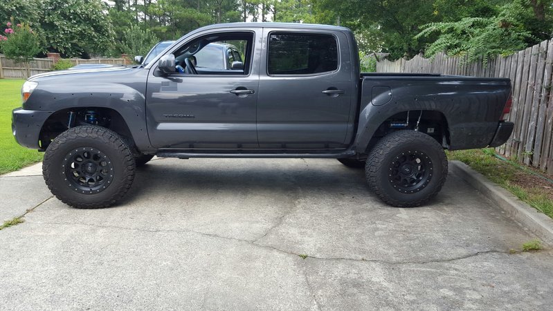

    1. How it looked when I got it. June, 2015.

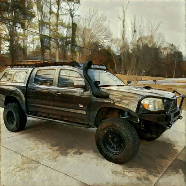

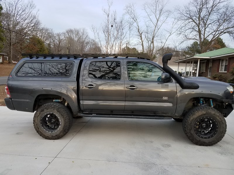

    2. How the truck currently sits:
    3. Some photos:

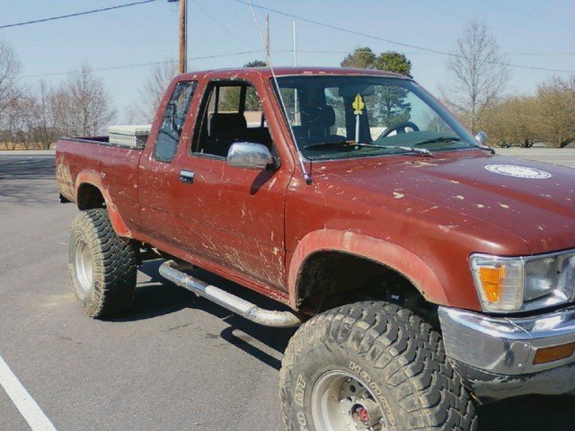

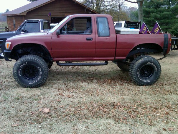

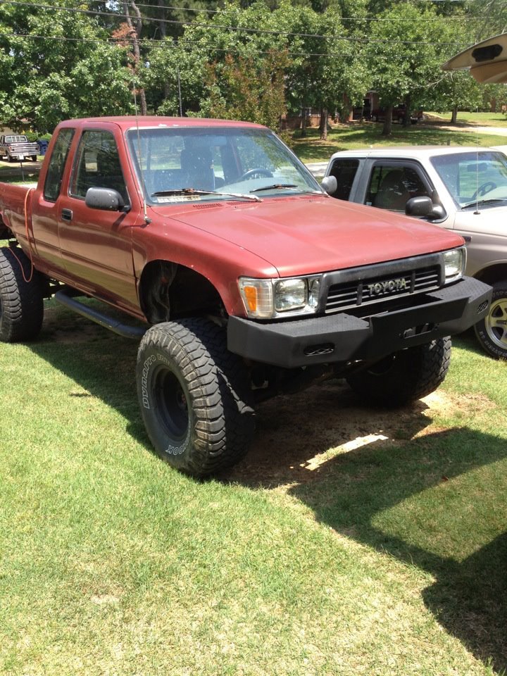

    My Toyota History:

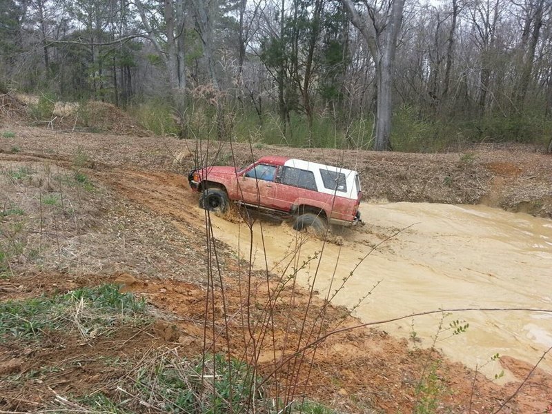

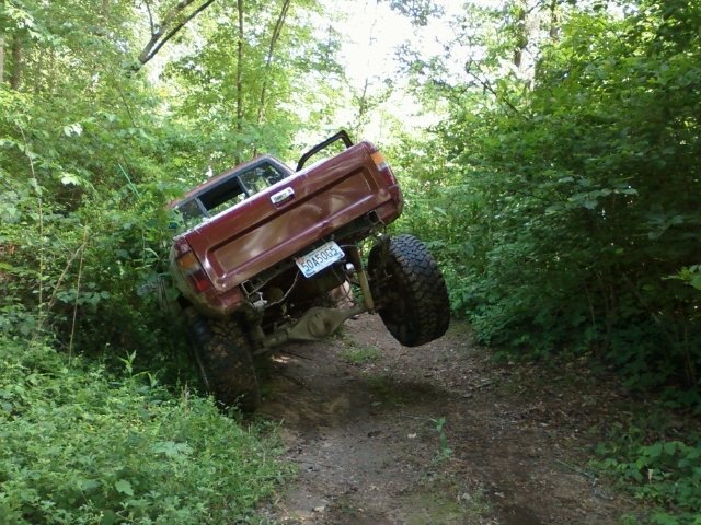

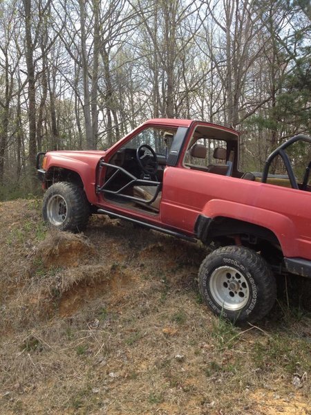

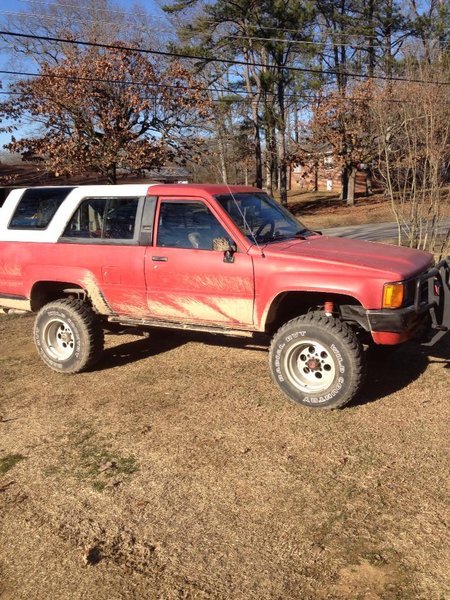

    When I was 16 years old my dad bought me a 1989 Toyota Pickup with 189k on it. It was already lifted 3" and I quickly put 35" Hankook Dynapro MTs on it and removed the fender flares. Here is the earliest photo I could find of it:
    I then decided it was time to cut it. We cut 4" out of the fenders and 16.5" out of the bed. I also painted the wheels, side bars, and bumpers black.
    I used to wheel the heck out of that thing and actually almost lost it once when the ground gave way beneath me:
    I longed for a solid axle Toyota since I was 16 and I ended up finding a guy who had a 1985 4Runner for sale, and we ended up straight trading my truck for his 4Runner.
    This thing was a ton of fun, but I never had the funds to do anything with it. It came with the tube doors and front and rear bumpers and sliders on it so I just left it alone and played with it as it was.
    I drove this around for a couple of years before I ended up buying my current 2011 Tacoma. So I know it's a short history (3 vehicles by 25 years old), but it's always been a 4WD and it's always been a Toyota for me.

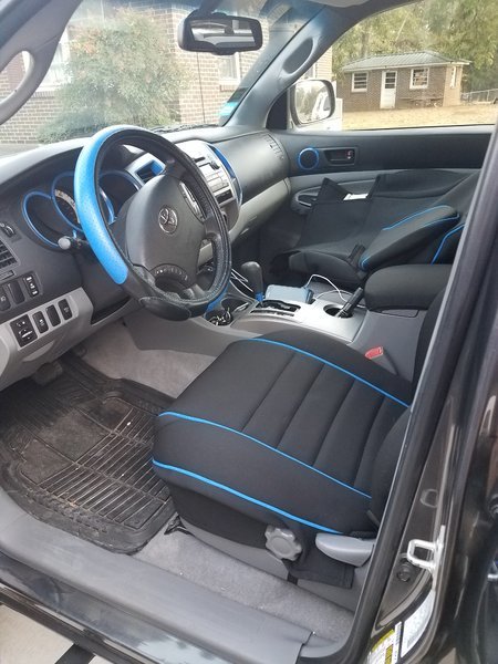

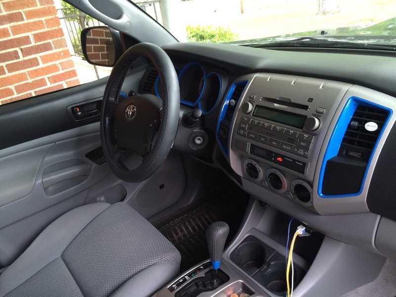

    LED interior and tag lights installed thanks to @MedlinAround go buy the super easy to use kit from here!
    Painted my gauge bezels blue
    Painted vent trim, door speaker bezels, and the chrome piece on the bottom of the shift knob blue. Also, removed the chrome piece that surrounded the shift knob because it sucked to paint! Window control panel pieces on the doors painted black.
    My Patch Collection on my Headliner

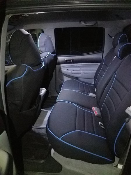

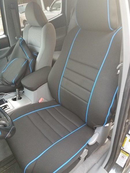

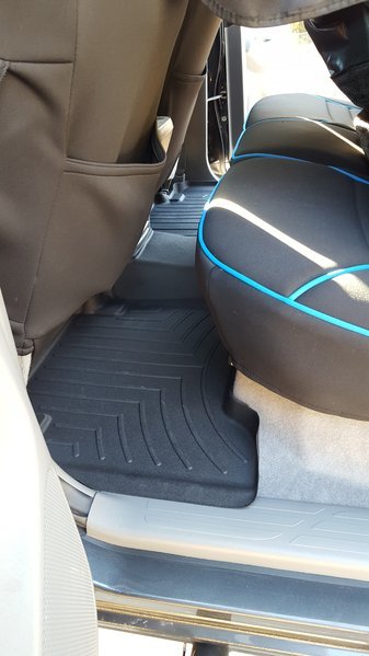

    Wet Okole Seat Covers, Full Piping Black with Cobalt Blue. These take about 1.5-2 hours to install by yourself, but they are so nice.

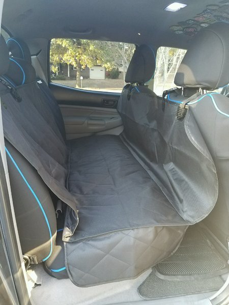

    Treat-A-Dog Pup Protector:

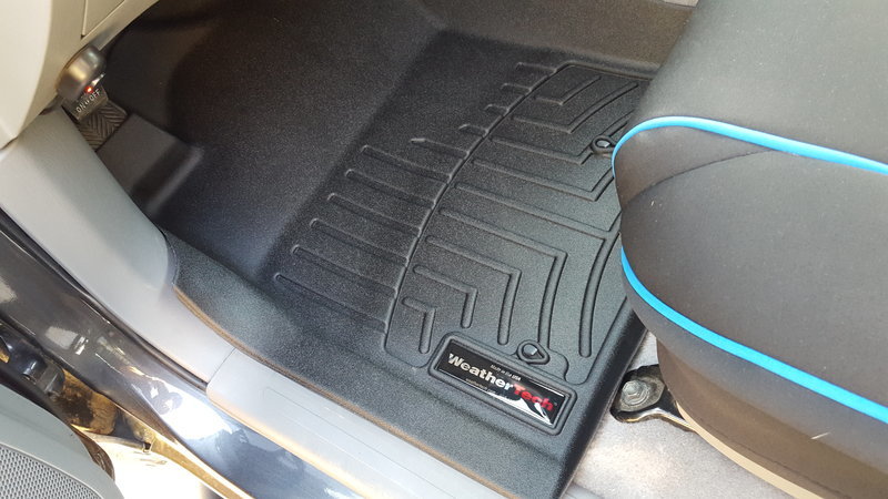

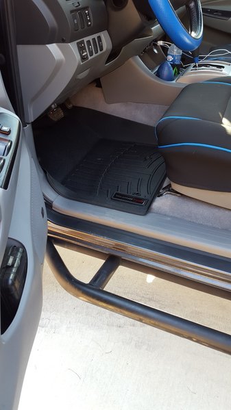

    Weather Tech floor mats installed. I love these things.

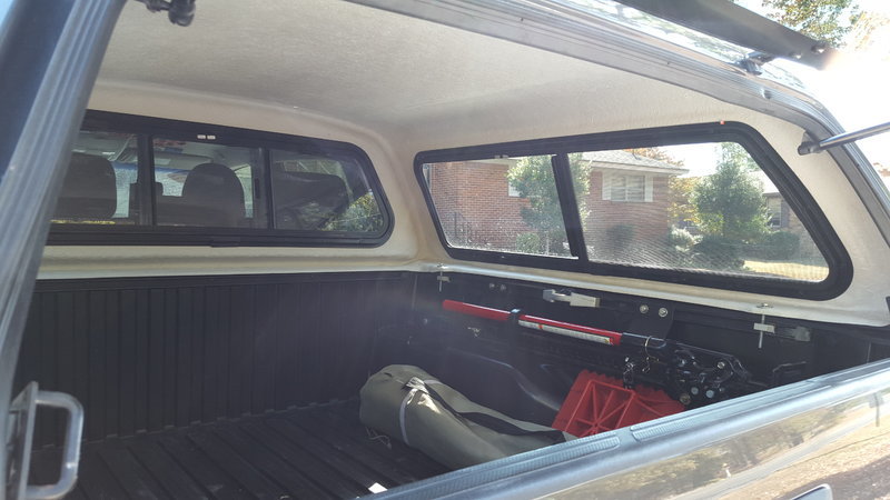

    EXTERIOR
    Removed Fender Flares:
    Redline Hood Struts:

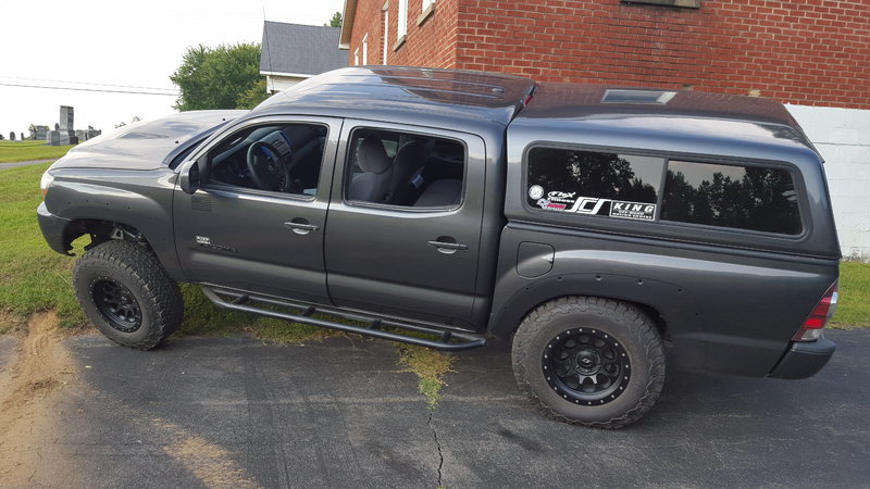

    Got me an ARE camper shell! Awesome Craigslist find!
    And I got it colormatched:

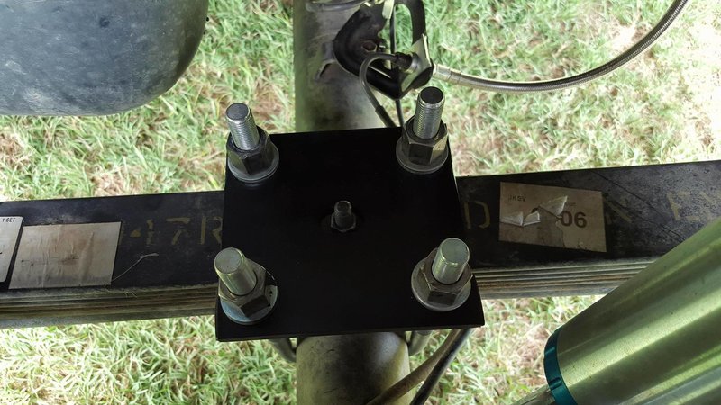

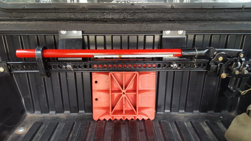

    Mounted my Hi-Lift Jack with @Shmellmopwho's mounts and slider adapter. Great products.

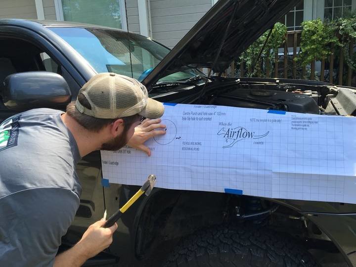

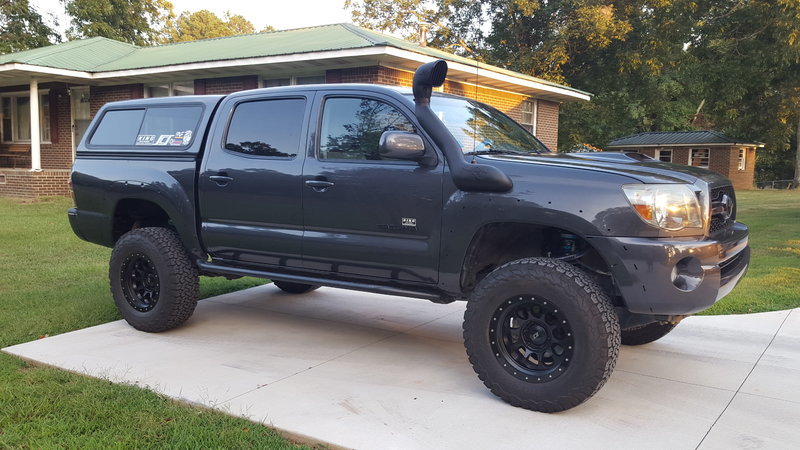

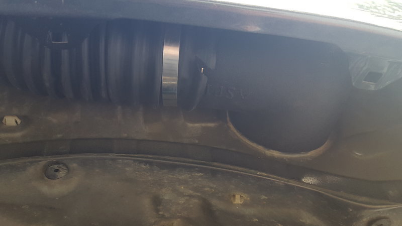

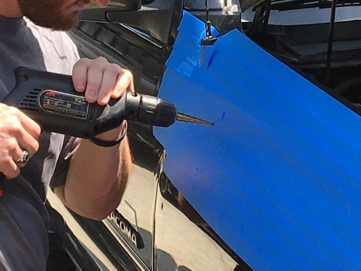

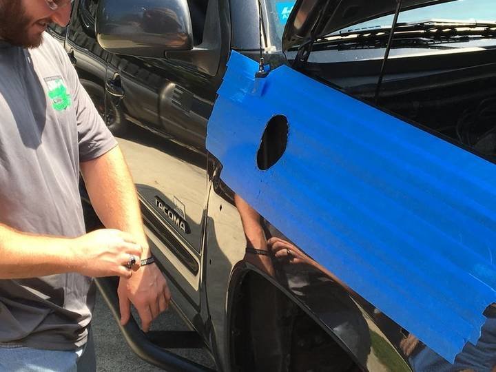

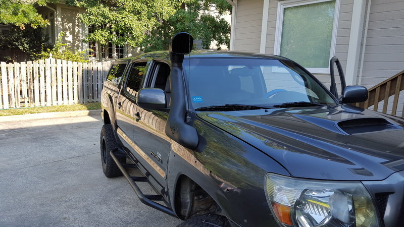

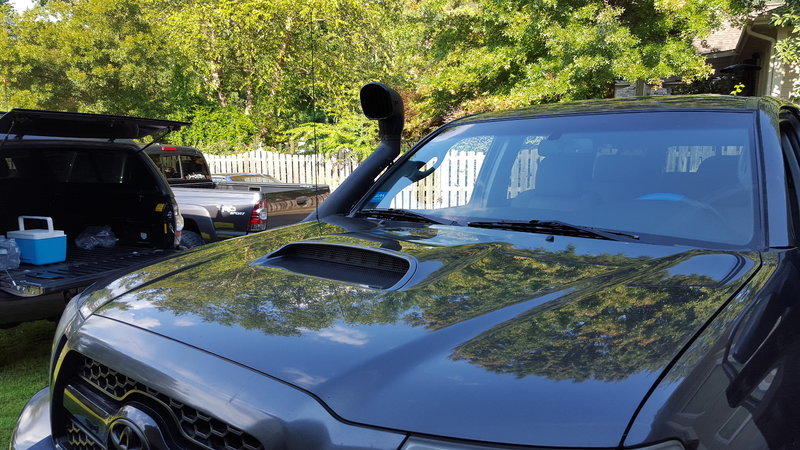

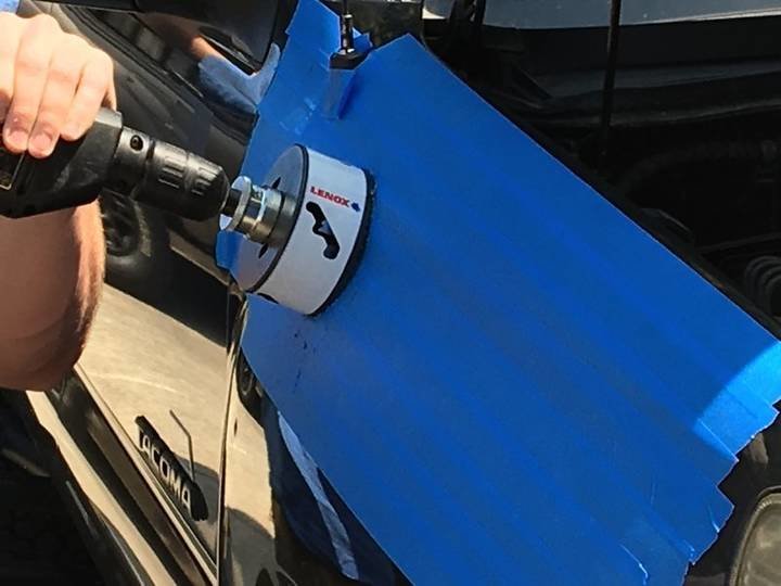

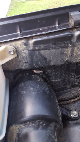

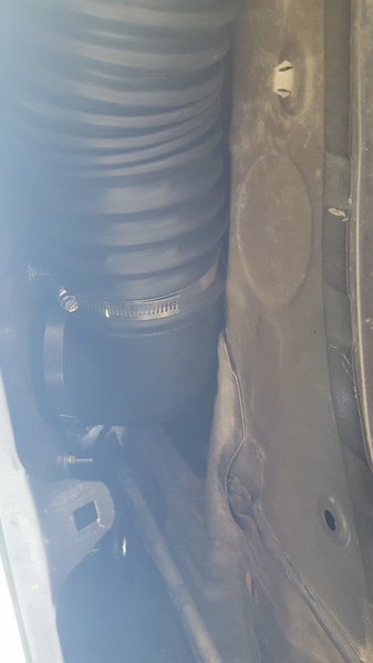

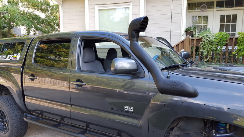

    Snorkel
    This is the install thread that I followed, but I did not cut the bracket, I simply "bent" it back to allow for enough room by being STRONGHAMMER (I used a flat piece of metal and a hammer to beat the hell out of it):
    https://www.tacomaworld.com/threads/how-to-airflow-snorkel-install.443155/
    and snorkel install process pics:

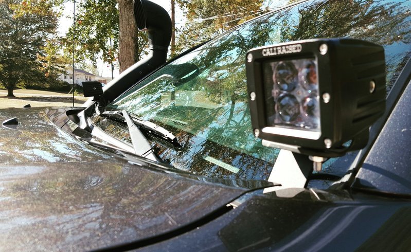

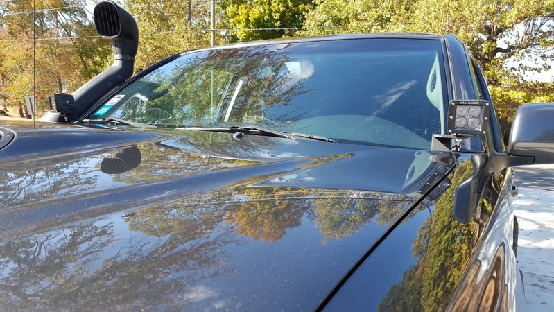

    Cali Raised Ditch Lights and Brackets:
    Ditch Lights + Headlights:
    Ditch Lights Only:

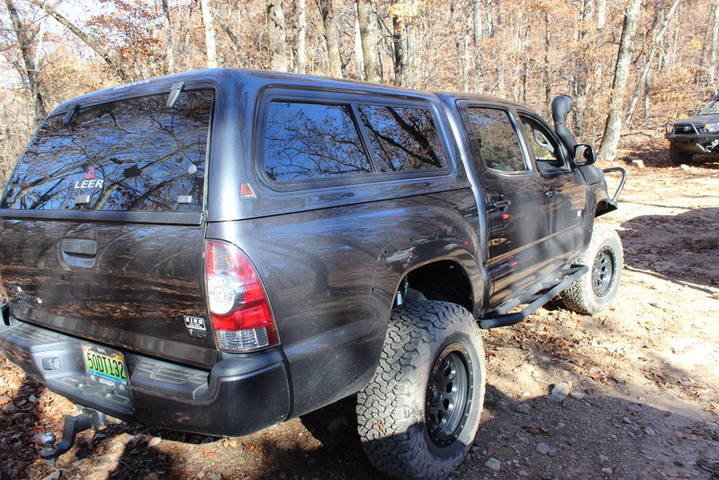

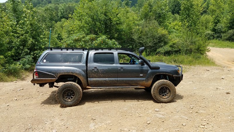

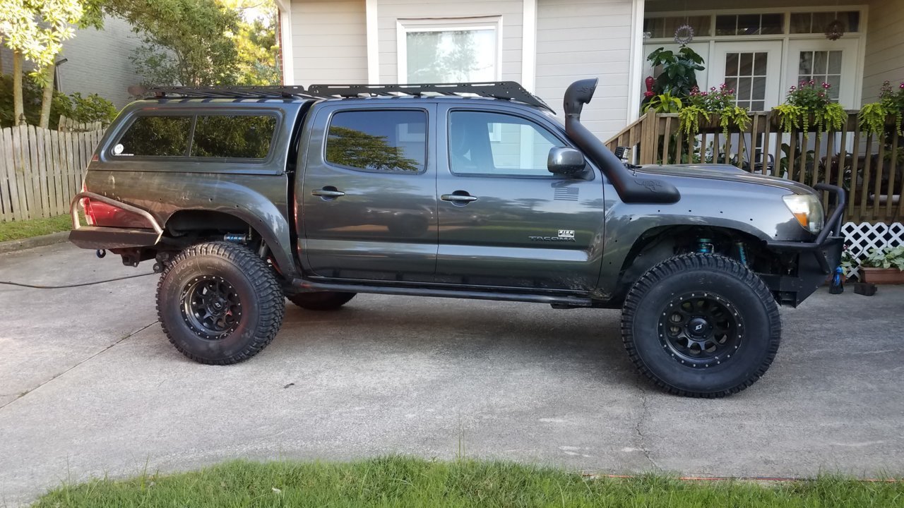

    My new Leer XL100 Camper Shell with sliding front window I got to replace the ARE I had.
    20$ Tacoma Bed Mat

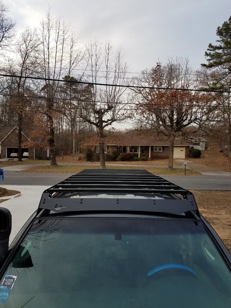

    Prinsu Cabrac and Toprac
    Reserved for future exterior updates.

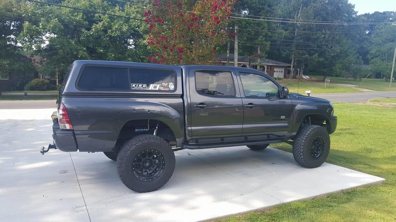

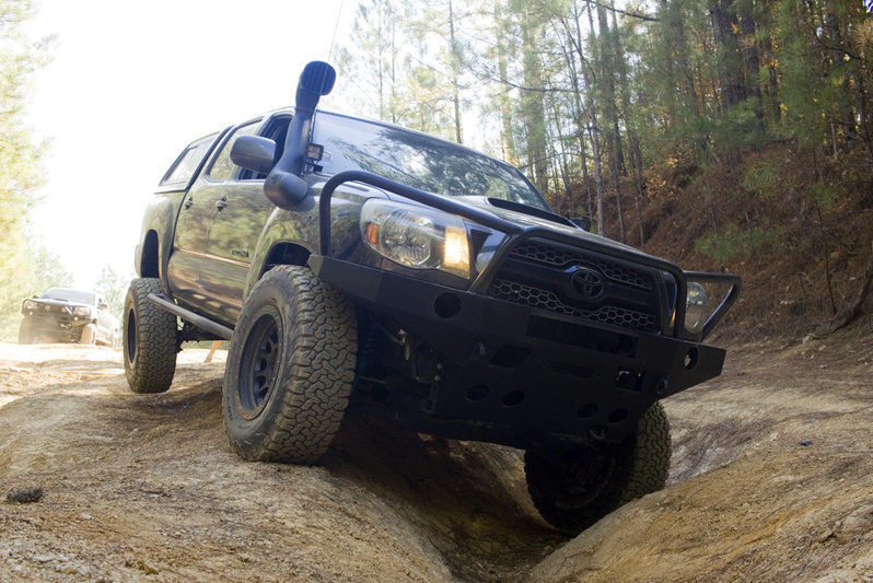

    SUSPENSION & WHEELS/TIRES

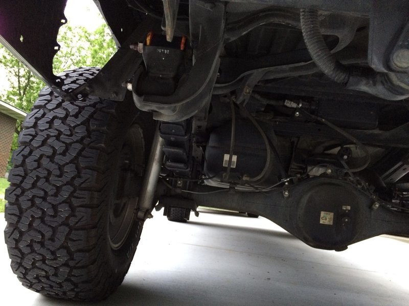

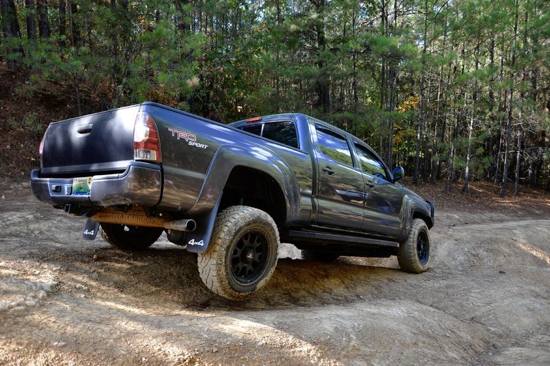

    Installed 285/70/17 BFGoodrich KO2's, 3" Rough Country Lift, and 1.25" Spydertraxx wheel spacers, and painted wheels.
    Total Chaos UCAs Installed!

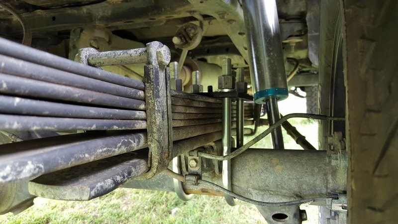

    OME Dakar Leaf Springs:
    Installed SCS Ray10 17x8.5 Matte Black Wheels and removed spacers:
    Low Range U-Bolt Flip Kit Installed:

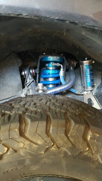

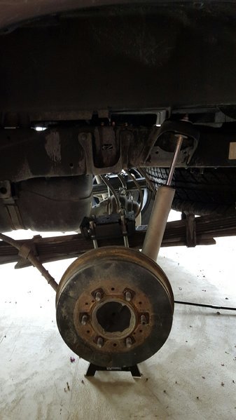

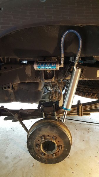

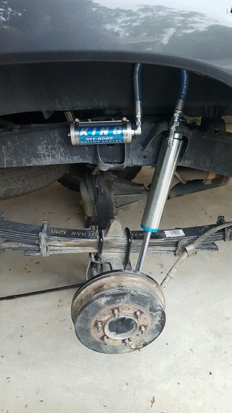

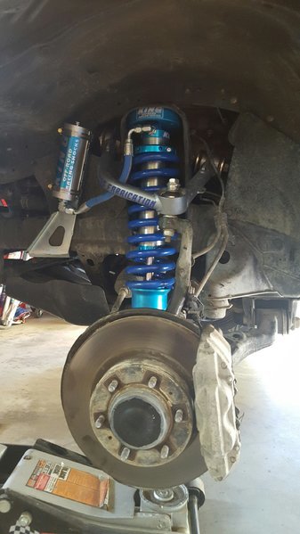

    King's 2.5" RR Rear Shocks Installed, Low Range U-Bolt Flip Kit did not work with the shock on the passenger side so had to modify the plate so that it would work. Here are the modified plates:
    Here is the wonderful King's that I put on!
    Before (Rough Country Shock):
    After:
    King 2.5" OEM Replacement Coilover Shocks with RR Installed

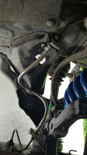

    4" SS Extended Brake Lines Installed

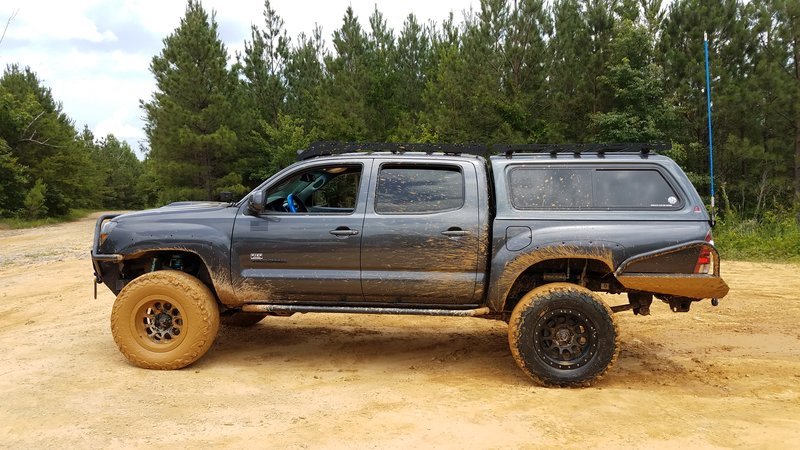

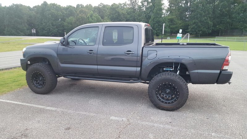

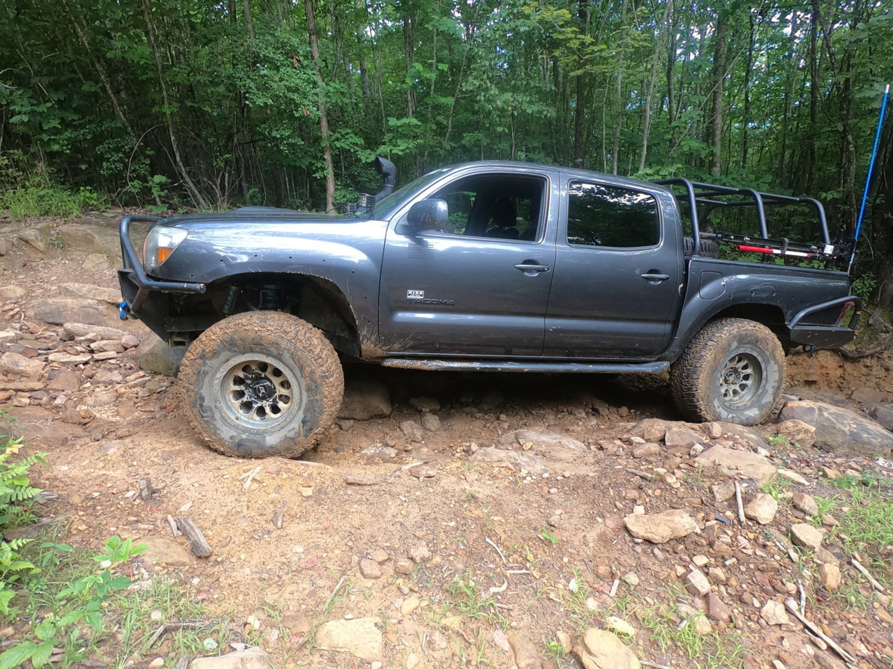

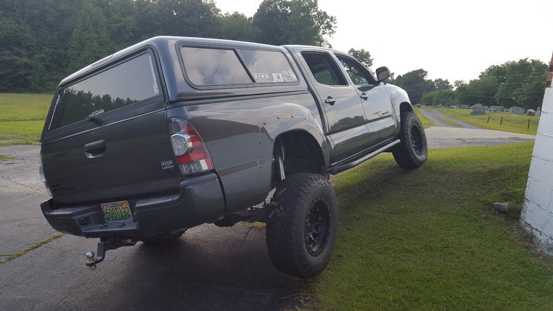

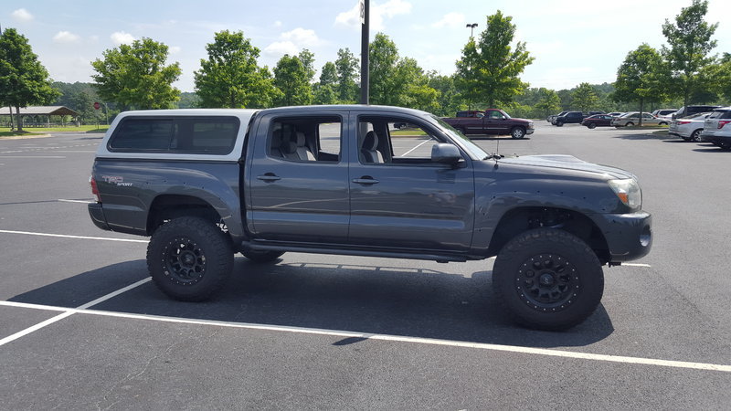

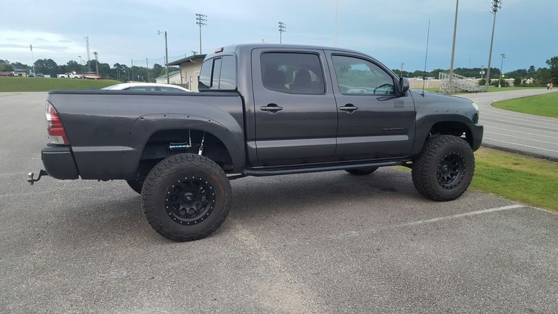

    Upgraded to 35/12.5/17 Treadwright Guard Dogs and trimmed fenders

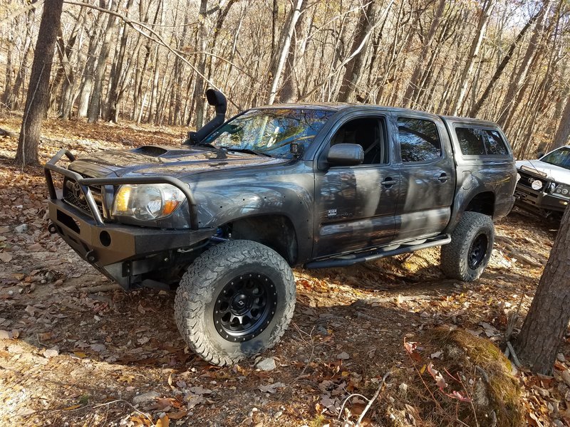

    ARMOR
    Sliders by Taylor Welding (256-738-7886). Local Alabama guy.
    IMG_1384.jpg12821422_1717155345186801_1073945639190129389_n.jpg 12803174_1717155355186800_809464338285241707_n.jpg

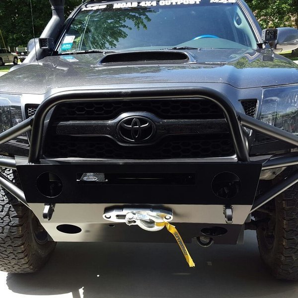

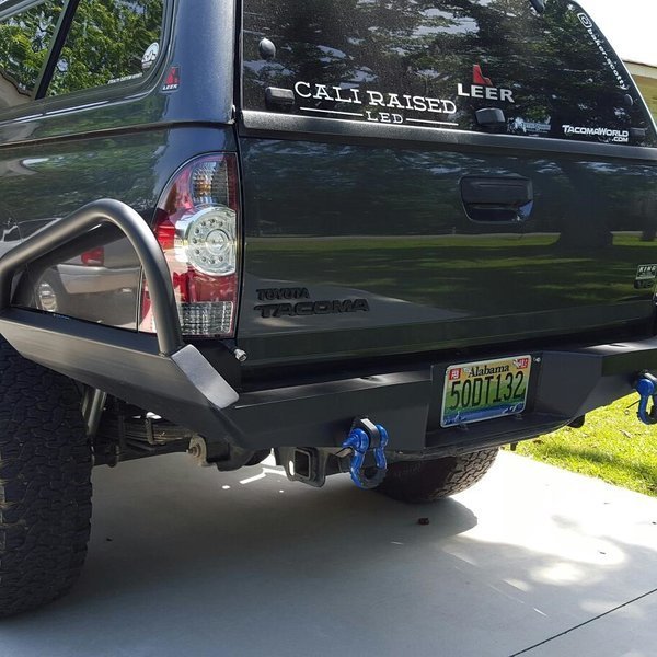

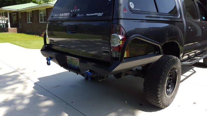

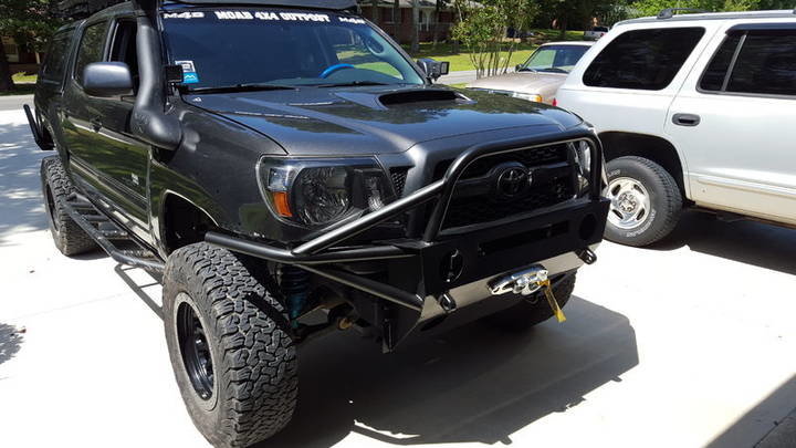

    Custom Front Hybrid Bumper by Hammock Welding & Fabrication
    Custom High Clearance Rear Bumper by Hammock Welding & Fabrication
    Reserved for bumpers/armor updates.

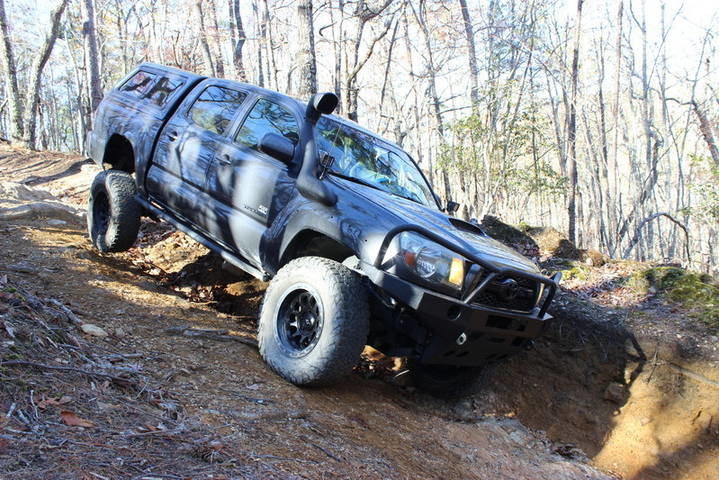

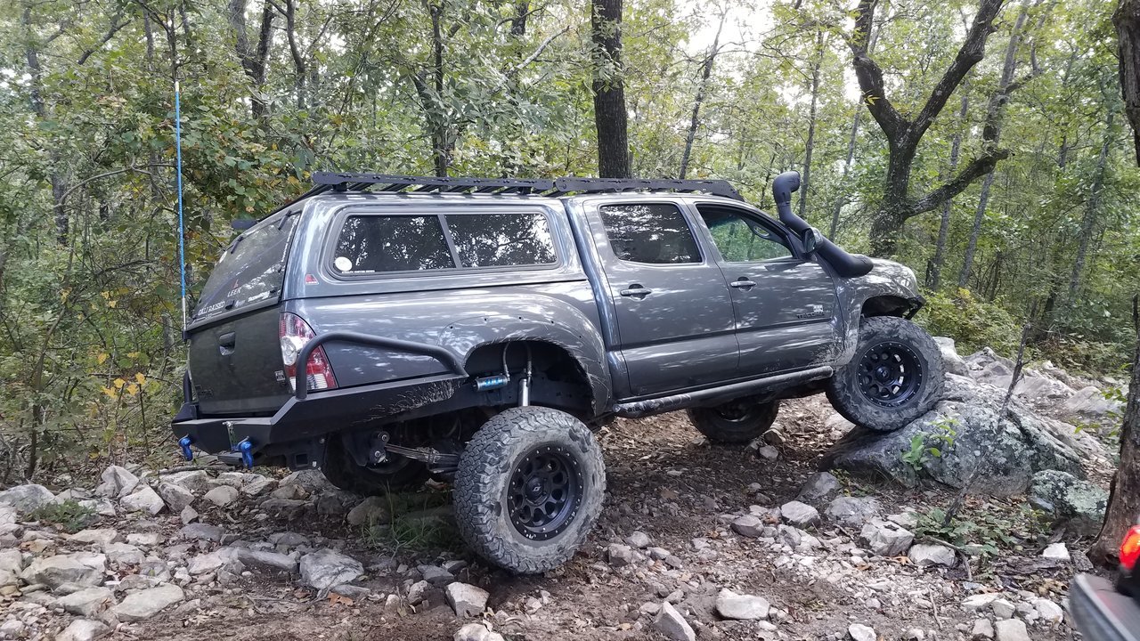

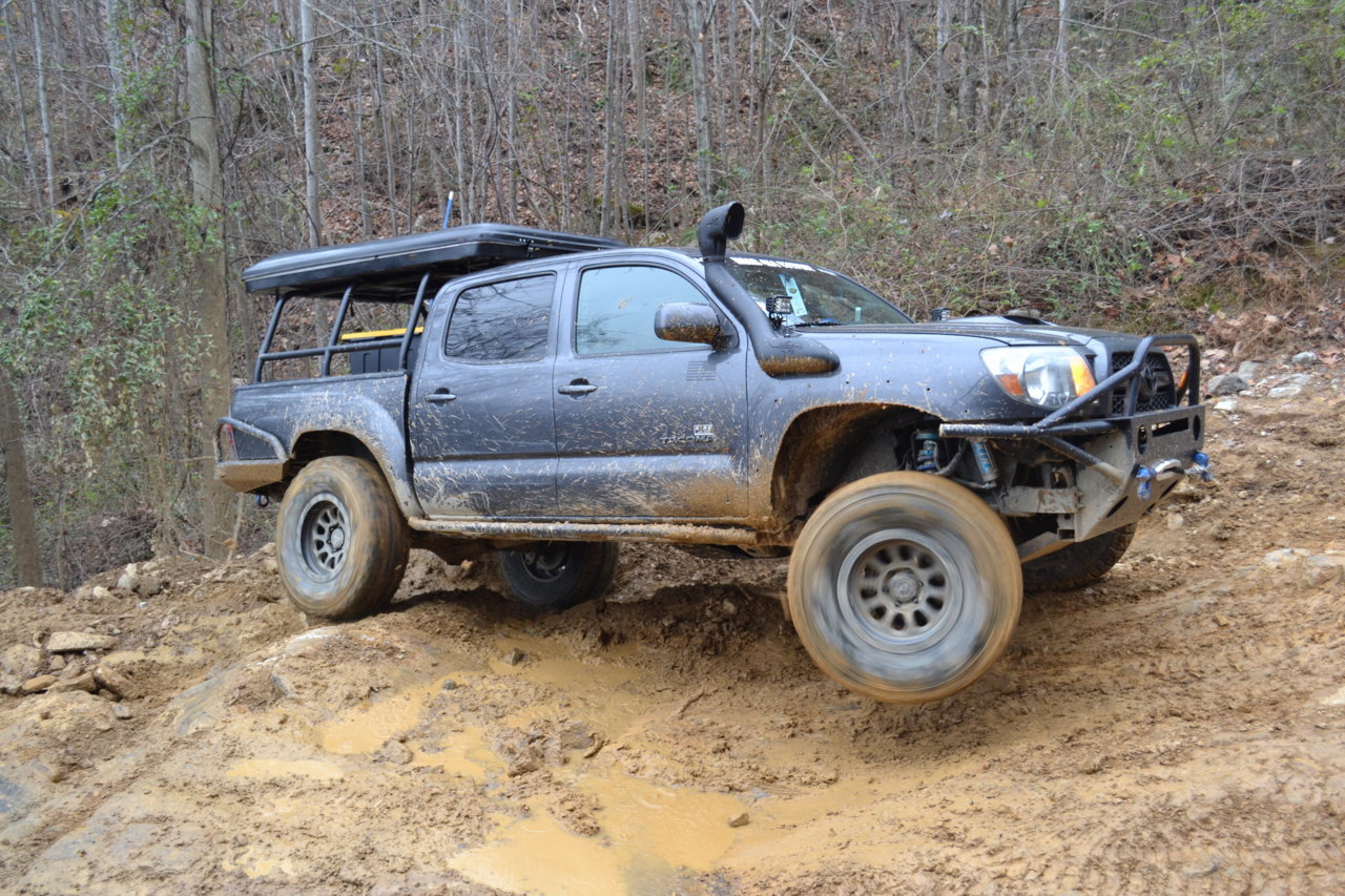

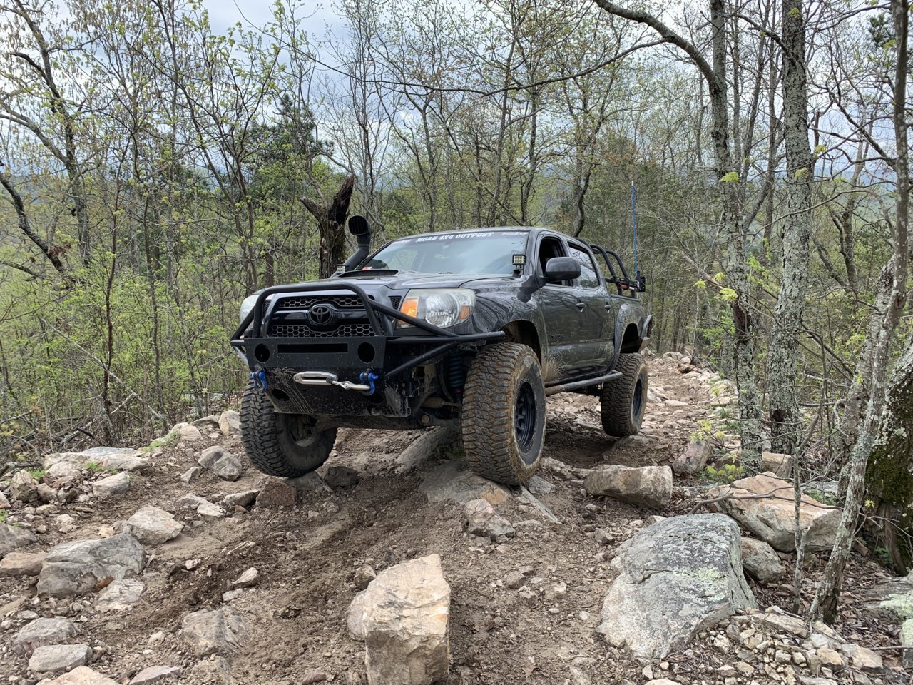

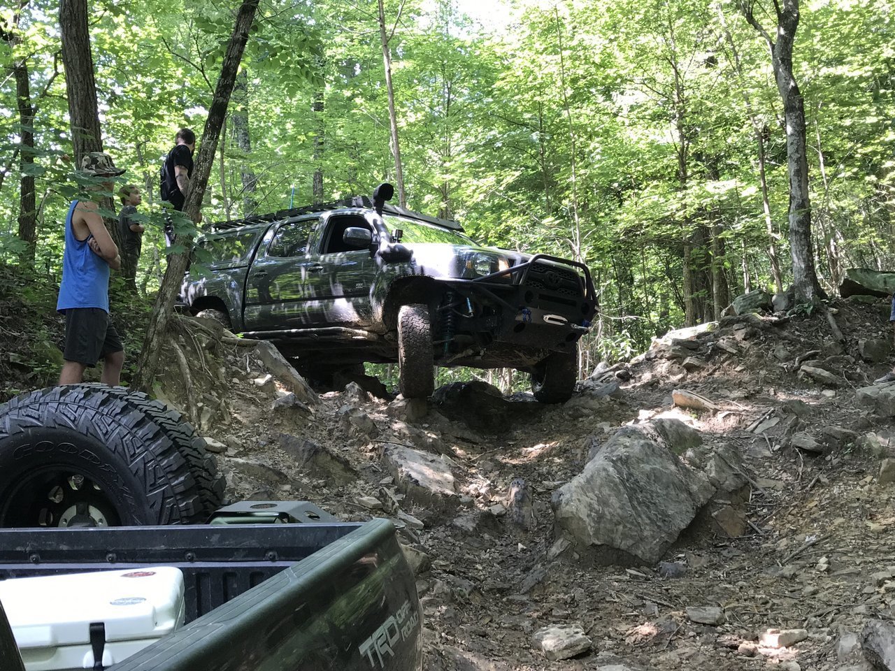

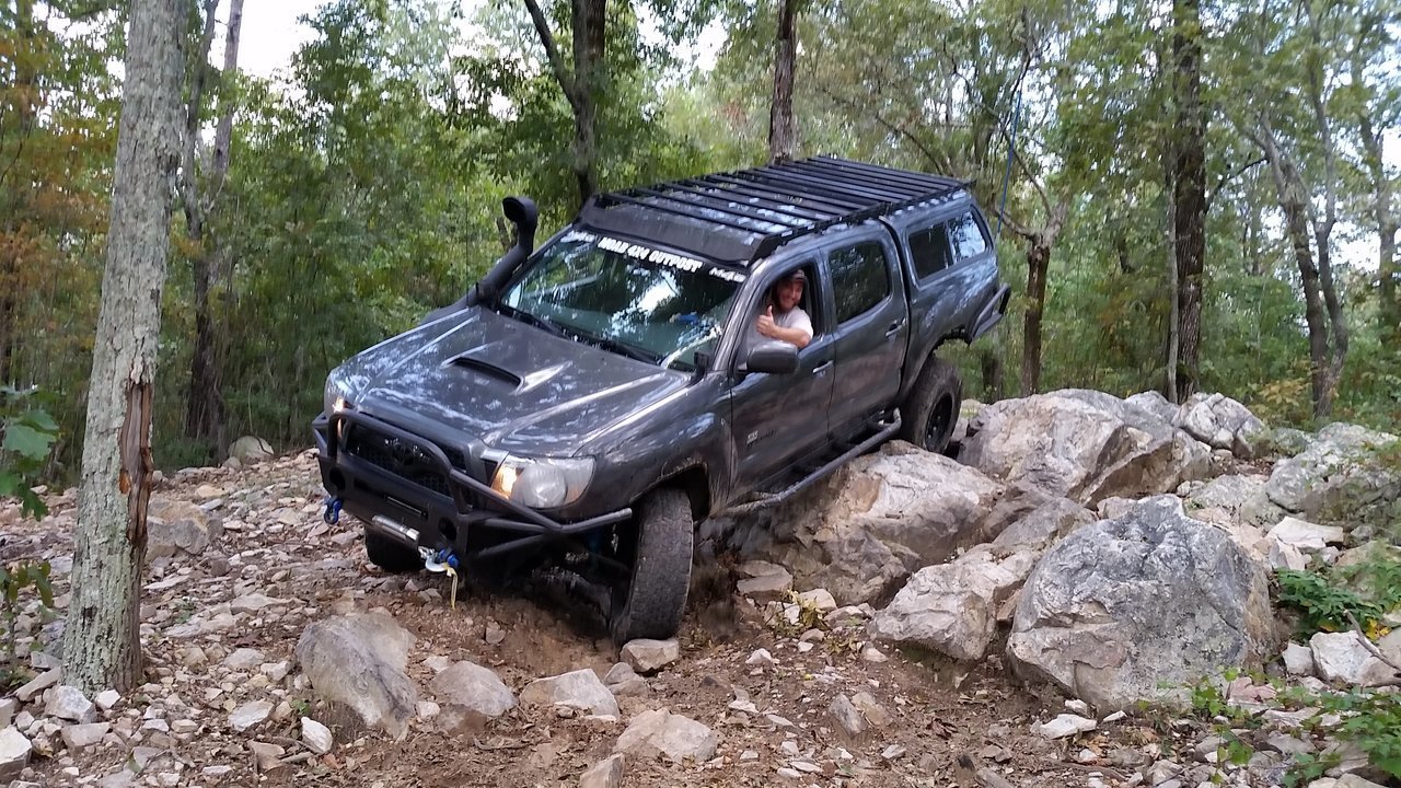

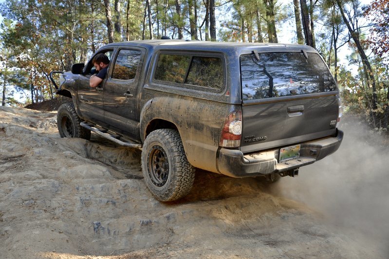

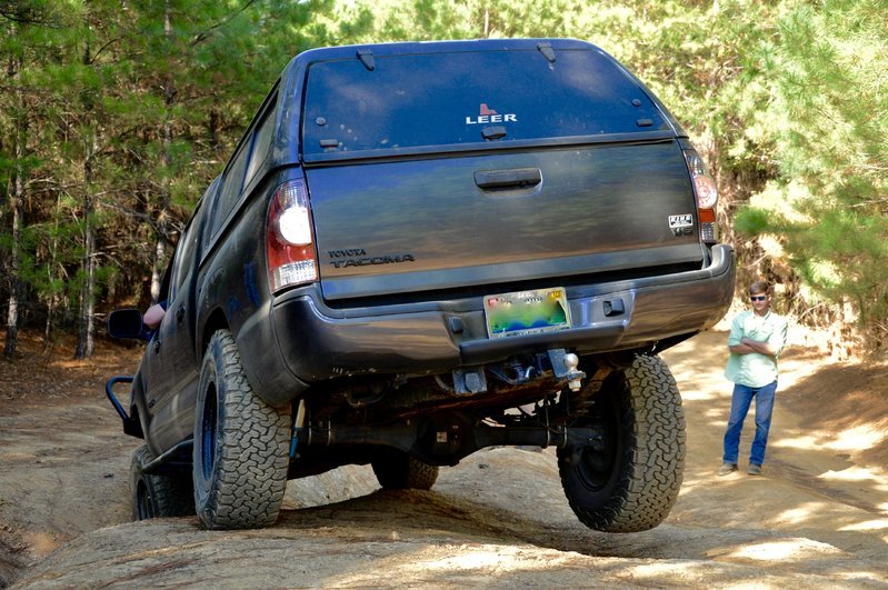

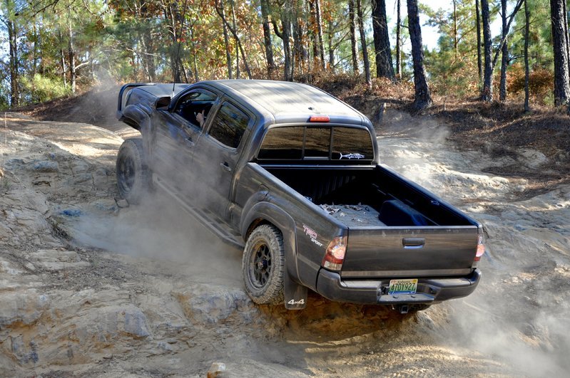

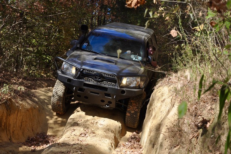

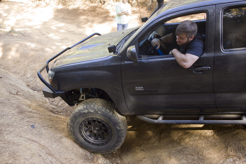

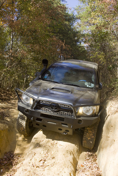

    Did a flex test just to see what I was capable of at this point. (Rough Country lift is all that's installed at this point)
    Flex test at same spot with current suspension setup:

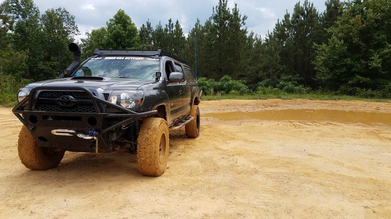

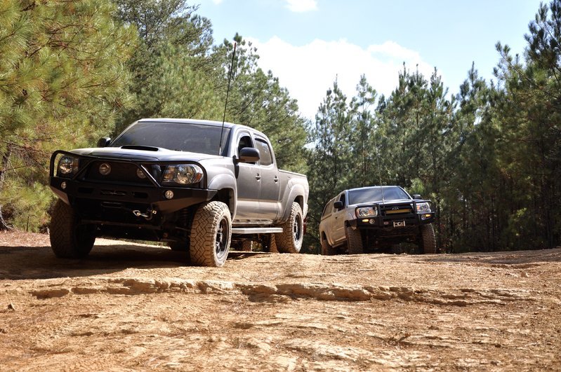

    Riding in Birmingham:
    Riding at Lakeshore in Birmingham:
    Riding at County Line in Arab:
    Riding at The Slab in Montevallo:
    Riding at Choccolocco in Jacksonville AL:
    Alabama Tacoma World at Top of the World:

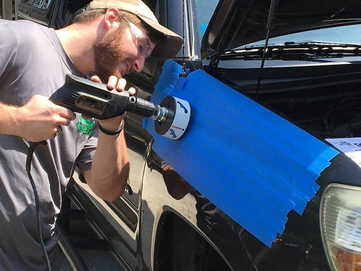

    I don't feel comfortable doing the BHLM by myself, I just know I'm going to screw something up, and you mean the fog light anytime mod?
    ChadsPride likes this.
  9. Mar 6, 2016 at 6:39 AM
    justinalldredge19
    justinalldredge19 Well-Known Member
    Jul 5, 2013
    #107672
    2,331
    Justin
    Arab, Alabama
    It's WAY easier than you think, just follow a How-too thread on here and take your time. And yes fog light anytime.

    Decided my accent color will be blue on this truck, so painted the gauge bezels blue. Speaker and vent bezels to come in the future.
    Before:
    After:

    2011 MGM DCSB TRD Sport 4WD
    Painting Door Speaker Bezels
    To remove your door panel remove the two screws in the door handles as shown:
    then simply pop this piece off:
    push the center of this pin to pop it out:
    then use a small flat head screw driver to remove the window controls and disconnect the connector on the back like so:
    simply pull the door panel off by starting at the front seam where you popped the little black pin out and go around the bottom of the door and back up. The door panel will just pop out and then you can lift it off of the window seal. You will then reveal the backside of your speaker cover and mine looked like this:
    You can pop out the "screen" by just pushing on it, but removing the bezel is a bit more difficult. If yours is like mine the green stuff is some kind of glue or epoxy holding it on, and you also have the two clips holding it on. GENTLY squeeze the two clips together and then you basically have to "break" the bezel away from the green stuff to remove it. Yay now you can paint it!
    For reinstall just follow the steps backwards! I used a small amount of super glue to reattach the speaker bezel where the "green glue" was holding it. THE PASSENGER SIDE IS EXACTLY THE SAME PROCESS.
    Here is the finished product of mine:
    ChadsPride, Pirhett and TheTacoma like this.
