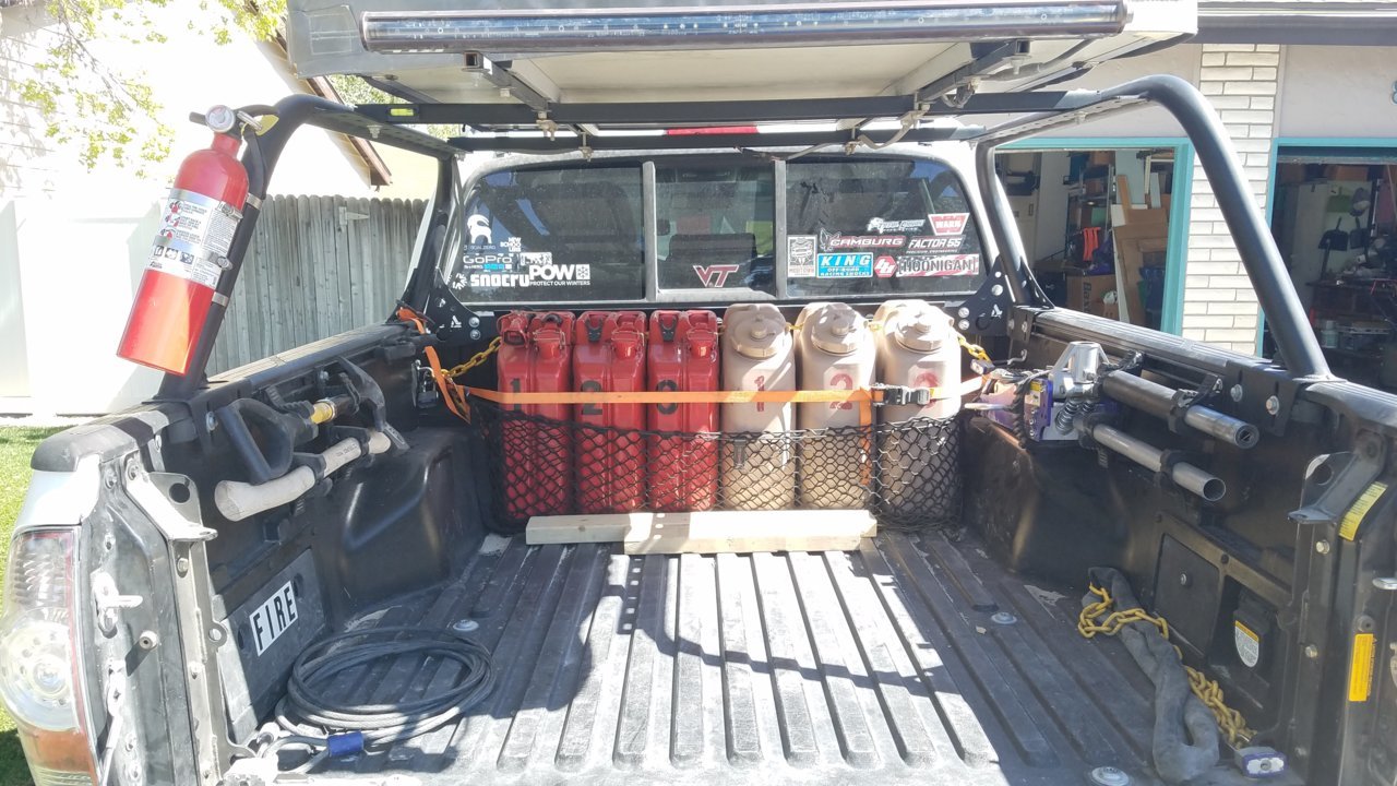

    Depends on the trip. 5 gal is usually fine, but I've had to use every drop of this load before on an extended dirt trip of UT/NV:

    I had the two 10 liter cans. That’s just over 5 gallons and I just limped into the gas station! I know it’s bad practice, but I’ve almost run my tank dry three times now. I’ve learned that there is another gallon left when the dash says you are totally empty!

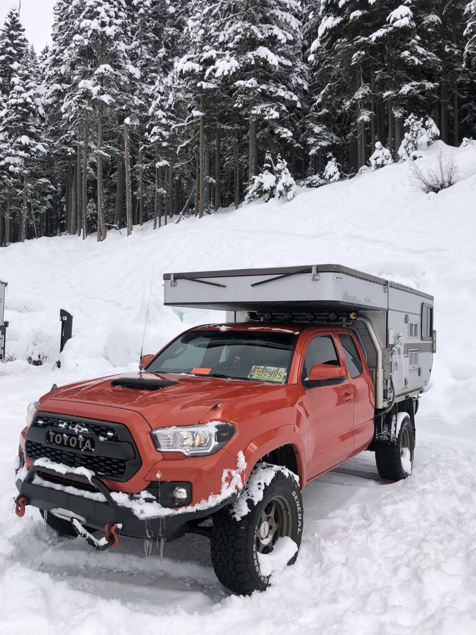

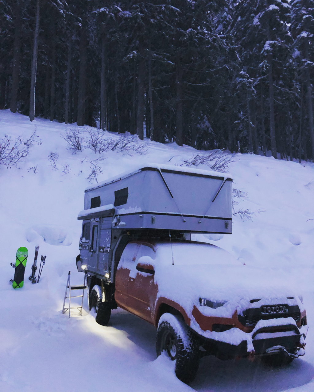

    The truck and camper are performing great in the snow.

    Its 99 here Stu! Looks like the West is having a good snow year. Have you ever tried airing down in deep snow? Seems like it should work like it does in deep sand
    Naveronski likes this.
  13. Jan 21, 2023 at 9:51 PM
    #213
    Stopmithering
    Stopmithering [OP] Well-Known Member
    Oct 5, 2016
    #199003
    398
    Stuart
    17 Tacoma TRD Sport ACLB MT
    Yes, I have. The only time I got a wee bit stuck was when the snow was up to the axles.

    Using foil insulation around the vinyl and in the windows for our weekly trip up to Stevens Pass. It’s made a huge difference in comfort and only takes a few minutes to install.

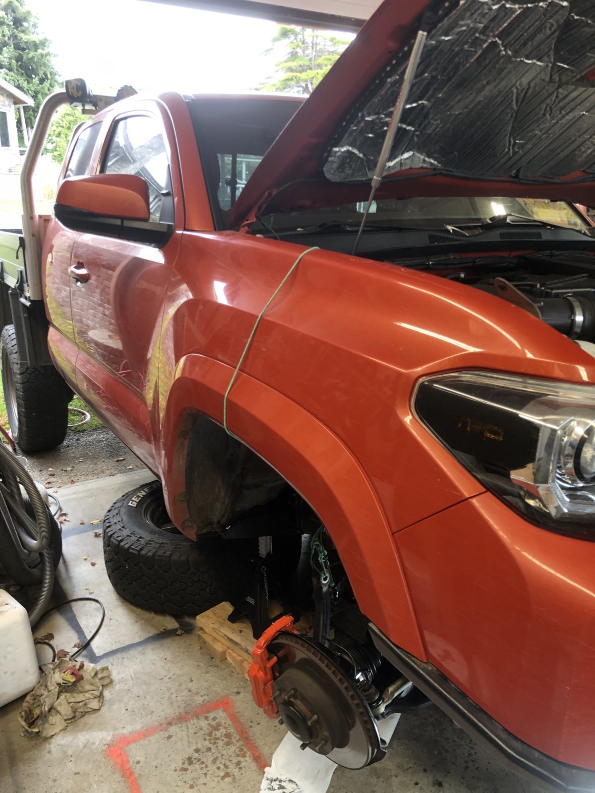

    56,000 miles

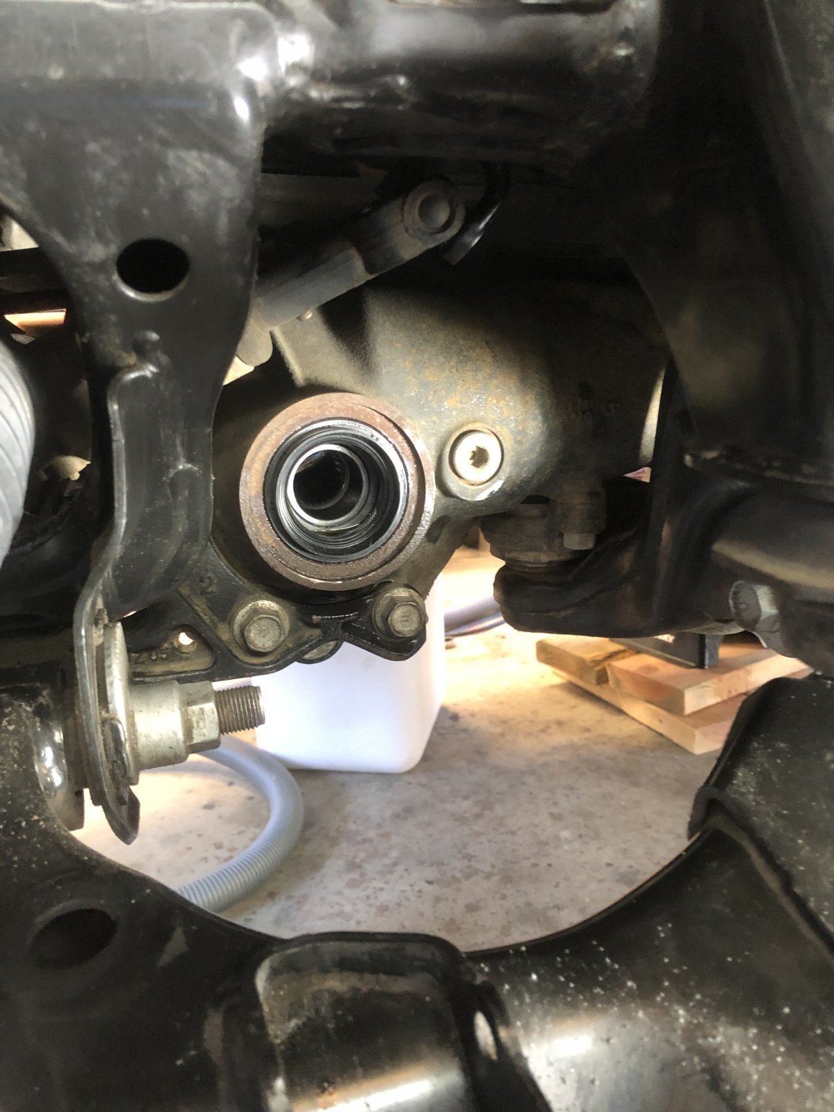

    It’s been a busy couple weeks with the truck nosed into the garage, with a long list of things that needed doing. I pulled the front wheels off to replace the brake pads with TRP Pro pads. It was then that I noticed that my driver side shock had blown a seal. So the shocks are now back at Teraflex for a rebuild.
    In the mean time I’ve totally cleaned up the front undercarriage and touched up a couple of rust spots. Over all the chassis is in great shape. Greased up all the ball joints and UCA pivots.
    Pulled the needle bearings and installed the ECGS bushing.
    All oils changed.
    Still more to do. I’m in my happy place.

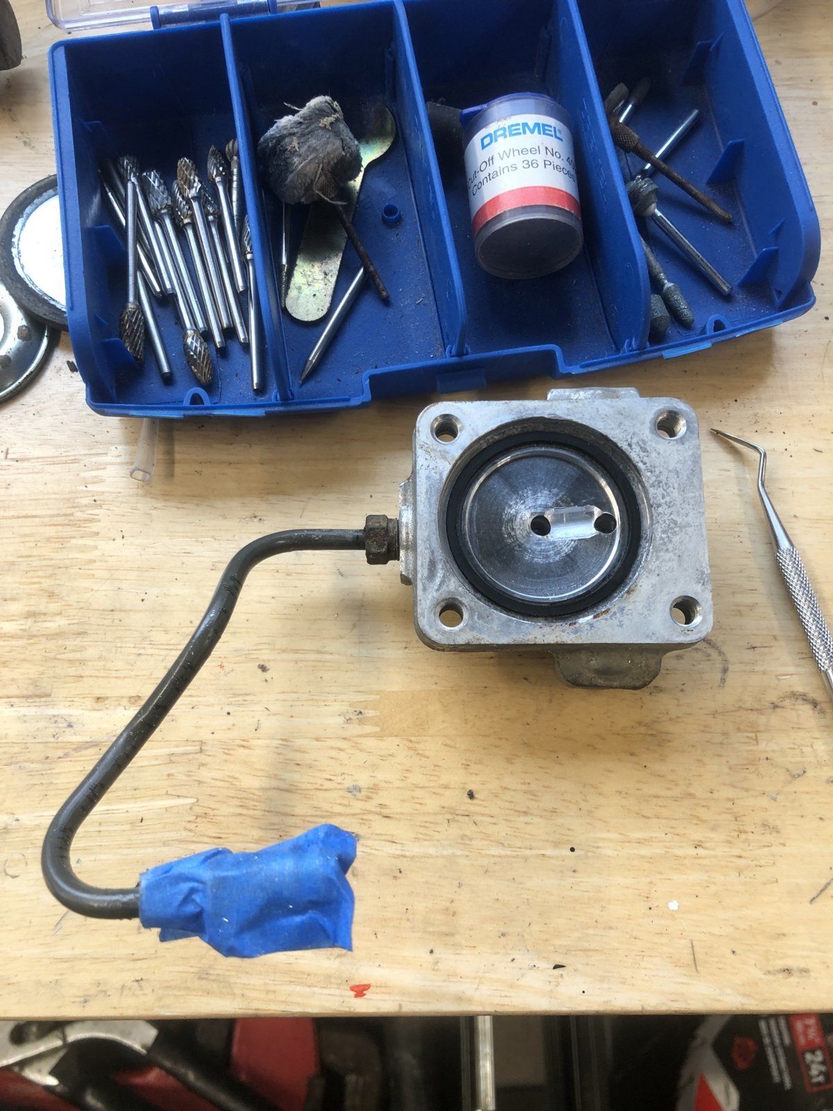

    I finally got around to the clutch accumulator delete. I used the Dremel to carve a channel though the accumulator. Pretty straightforward, but I was surprised by the amount of corrosion infiltration into the system. I did the best I could to clean it up with an old dental pick.
    Flushed the brake and clutch system with Bosch ES16-32N fluid. The truck is still waiting on the front shocks that are being serviced at Teraflex.
