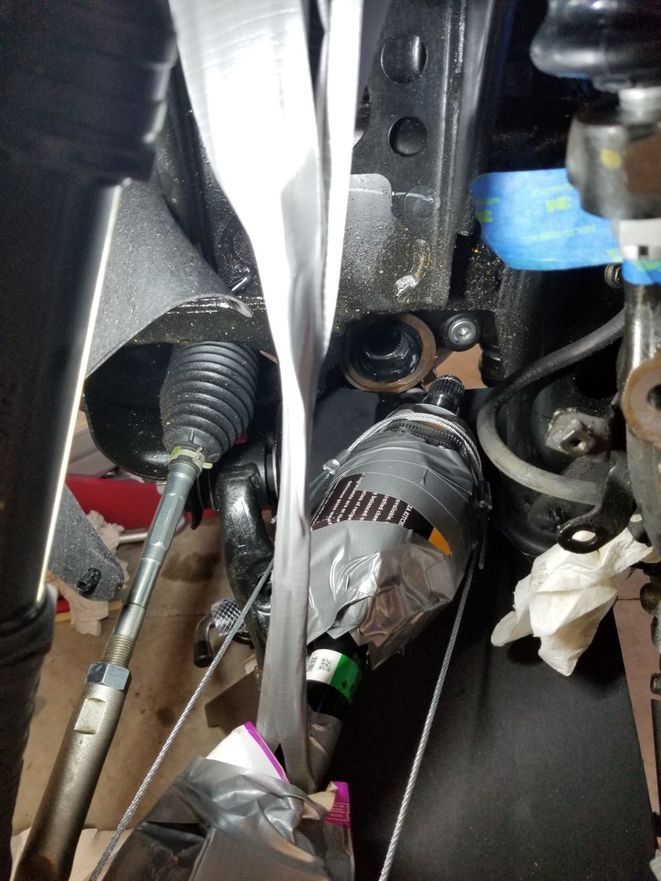

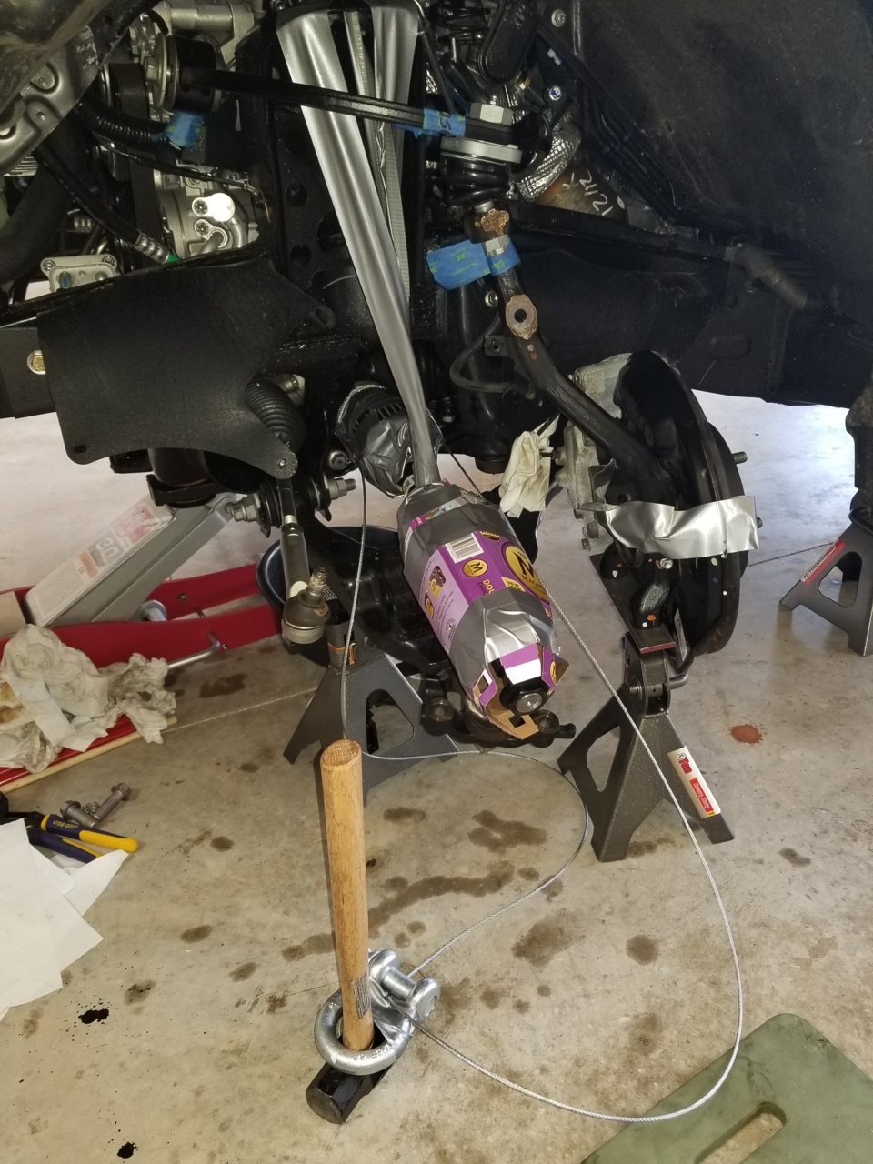

    It’s a bitch trying to punch CV out with the truck on the ground from underneath it, but I did it the smart way eventually with cable chokers.
    Bottom of my post here
    https://www.tacomaworld.com/threads/lift-kit-question….721793/#post-25700008
    Basically slip the ends of a single piece of cable through a 2 hole crimp but only smash a stopper on each end so it still slides, i.e. a choker on each end.

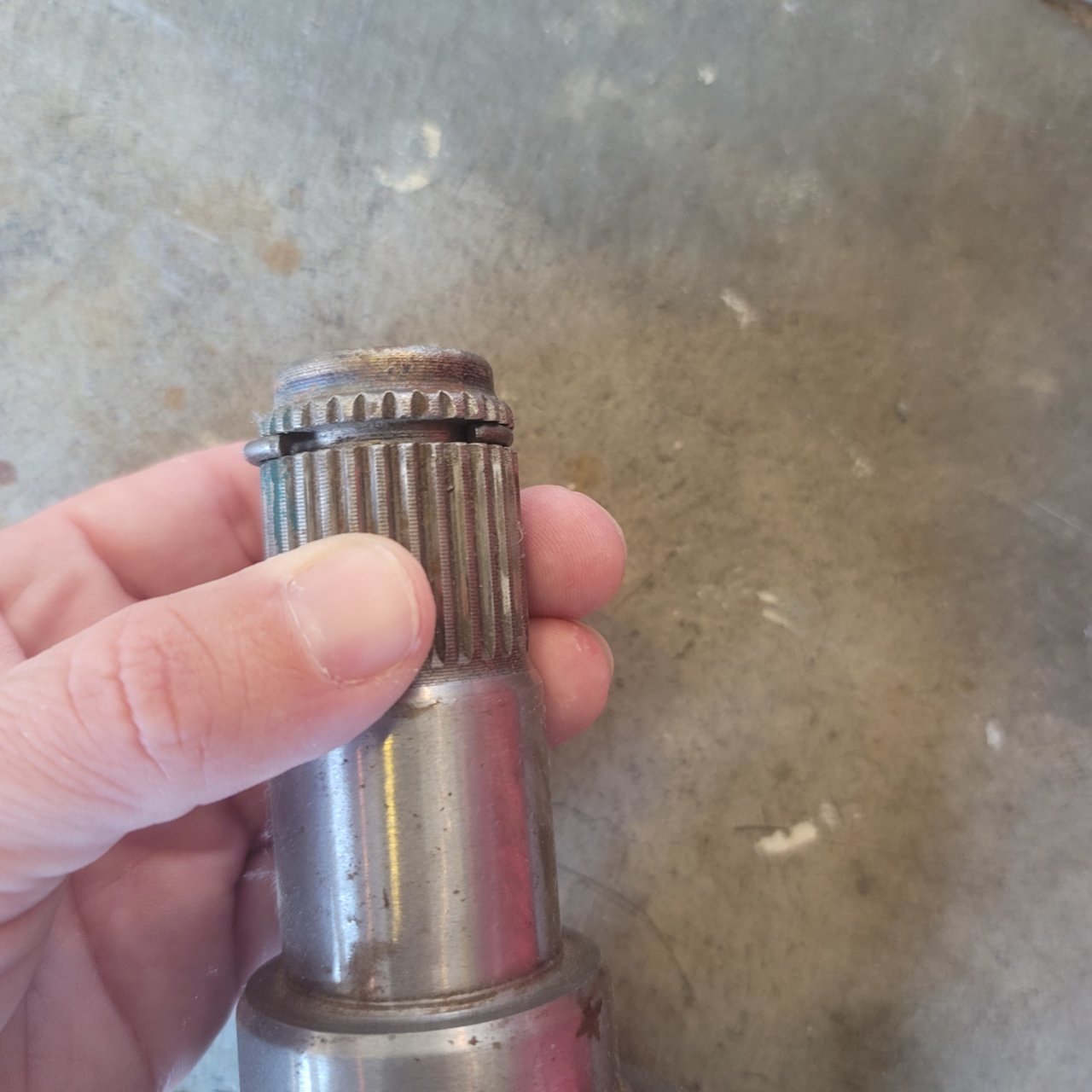

    @tluke81 this might help picture it. Walked out to my garage to take photo of c-clip

    Here is a better overview. 15min to setup once you get the parts but literally 2 good swings straight away and it’s out.
    Just stop swinging hard once it pops a little bit out…

    It's really for putting it back in because at that point you can see the c-clip

    The opening doesn’t matter when removing but makes a big difference when installing. Have the opening of the c clip facing to the ground.
