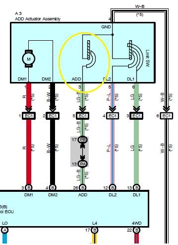

    that actuator is very finicky when it comes to the reassembly and the timing of the gears and spring fingers on the contact pads. Make sure it is actually spinning all the way but checking ground on the limit switch. Can't remember which pin. Think it's pin 4

    Anyone know or can link me to the pin assignments?

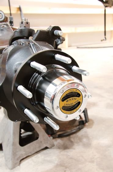

    These are a lot easier to see if they are locked or not juss sayin:D

    As I said to you at AOAA, if those contacts are open, you will want to use Bulb grease, a.k.a. dielectric, so as not to insulate.
    If you find a diagram, flag me on the post please.

    Here's the pin assignments
