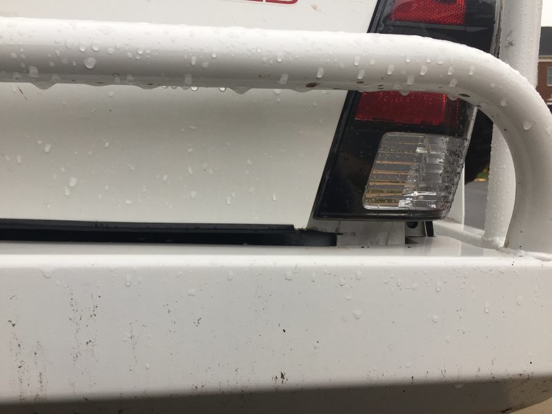

    Whoa, let me look up the laser level how to.
    I have a nice Porter Cable Laser level.
    Do you guys know what the cut-off measurement is from the top of the bedrail?

    I think its like 17". Its right below the tail light

    You just cut even with the bottom of the tail light. That's your initial measurment. Match it on the other end.

    It's a good sized gap. It's supposed to be so it can flex on the trails without hitting.

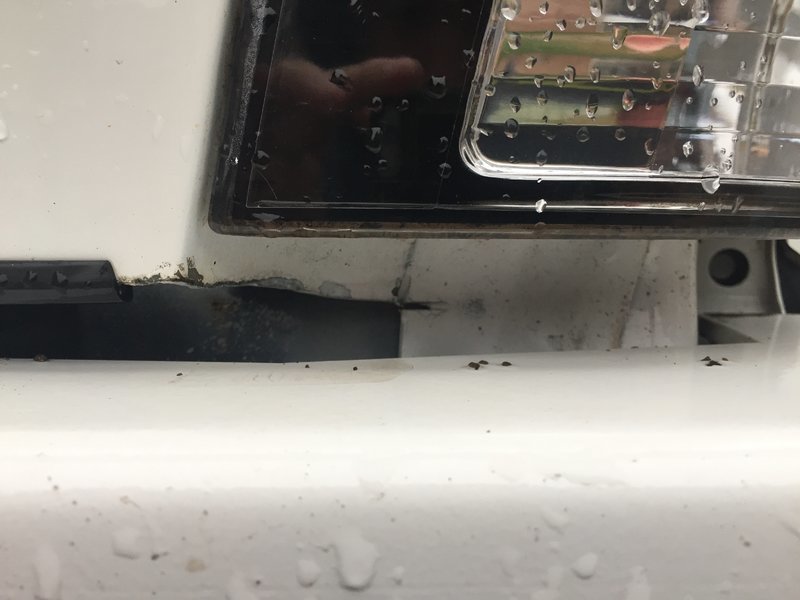

    Can I please get a closeup pic of the cut line just below the taillight?
    fatfurious2 likes this.

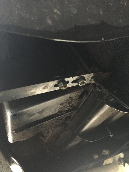

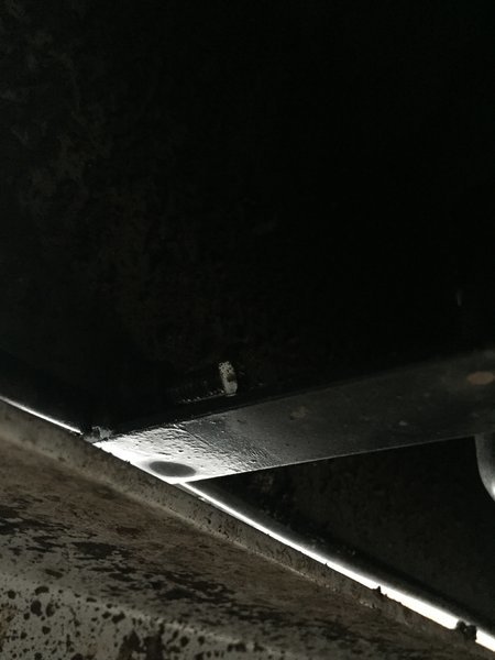

    Ill take some pics now Lloyd. And of those brackets and of the trim stuff that i used

    I went a little below the tail light

    As stated, cut level with the tail light bottom. Billy said he likes to see 5/8" gap between the sheet metal and bumper when finished. I actually have less clearance in some areas than that, and after a three wheeling trips now, it doesn't seem to b a problem.
    Also, make sure you rip this plastic thing off the truck in the photo before mounting the bumper,
    It's under the tail light, held in with three plastic body clips, IIRC.
    Just grab and pull hard to break the clips. :D
    I don't know what it's called or what its purpose was.
    Also, you can easily retain your fender liners if you want to, which I recommend. Just don't cut them, and then "tuck them in" to the bumper and secure later.
