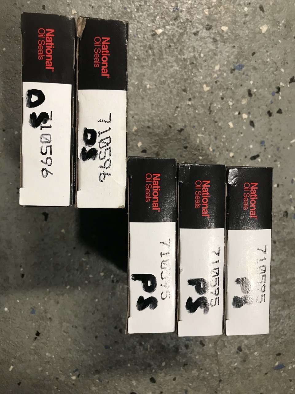

    For some inexplicable reason, this past year I’ve used 3 drivers side CV axle inner oil seals.
    Well, it’s actually easily explained.
    Seal 1: Removed CV to replace torn boot. Replaced the original 12 year old seal.
    Seal 2: Replaced Seal 1 after noticing a leak a week later. I apparently installed incorrectly.
    Seal 3: Replaced Seal 2 during the regear and ARB front locker.
    Got some fresh spares:
    Thanks @diabetik81 for the great deal on these.

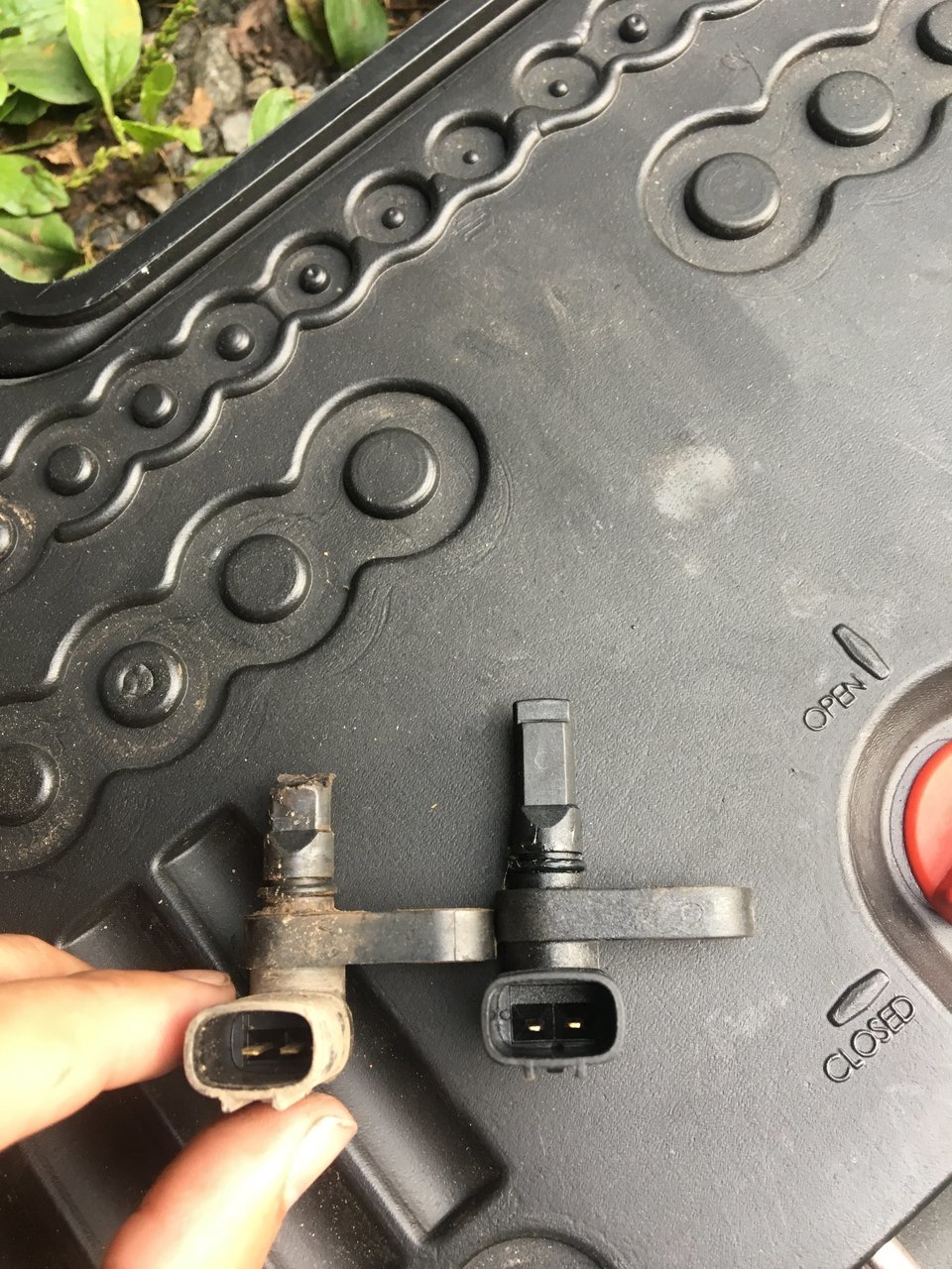

    I cooked my brake fluid when my WB went out when I was driving home the rotor was in contact with the pads. Melted my wheelspeed sensor or whatever too haha
    After that was all fixed the pedal was much more firm, but new drums and shoes made my pedal feel back to normal

    For the WB I removed the sensor pretty early on and it looked chewed up.
