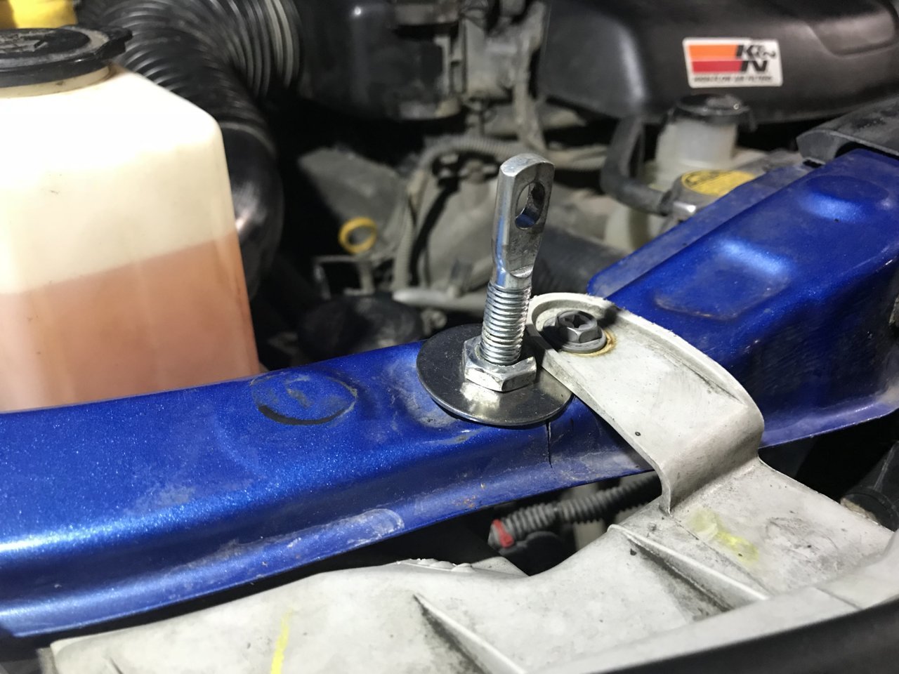

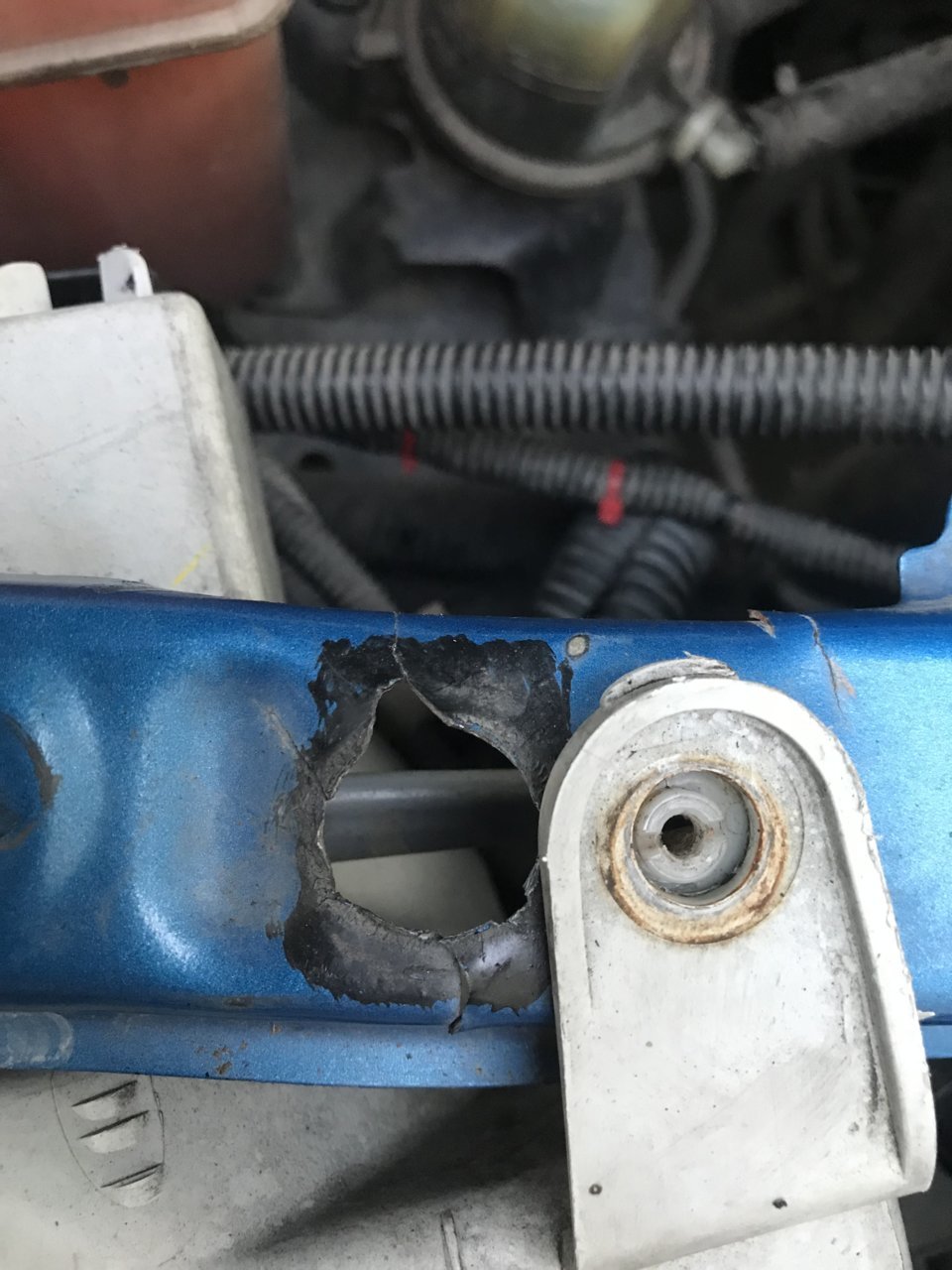

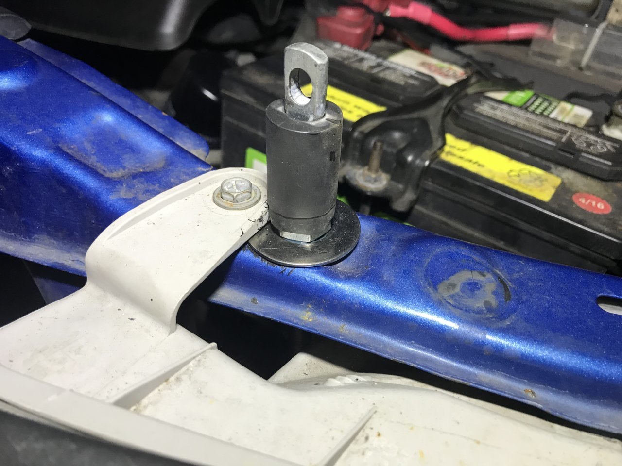

    Update on my Hood Pins:
    The PS pin pulled away from the stamped sheet metal upper crossmember. Took the whole thing out including the metal sandwiched between the two washers:
    I took some much bigger stainless fender washers and sandwiched it back.
    Did it on the other side as well because it looked doomed to pull away soon.
    I was thinking of welding some kind of reinforcement to the crossmember but that shit was pretty thin gauge. A full crossmember fab is probably the best solution. But I need to find some time. And someone who has already fabbed up something and can send detailed pics/plans.

    thin metal like that you have to do pulses or it will burn right through, just weld flat stock you can find at home depot for it

    There’s cracked sheet metal everywhere! The drivers side core support is crumpled. It needs a complete redo.
