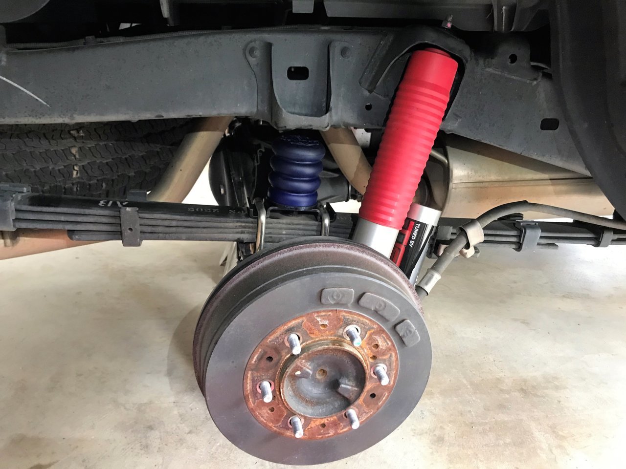

    The Sumo Springs are not intended to create LIFT. The correct part # for 3rd Gen is SSR-612-40 (4 rolls). The part # for 2nd Gen is SSR-610-40 (5 rolls). The guys getting LIFT are using the 2nd Gen Sumo's on their 3rd Gen trucks, thus the 5/8" of lift. You really don't want to lift your rear this way. They are meant to assist with towing and heavy loads, that's it.
    I just installed the SSR-612-40's on my truck. Love the ride, tows even better. The rear only sags by 3/4" now towing my boat.

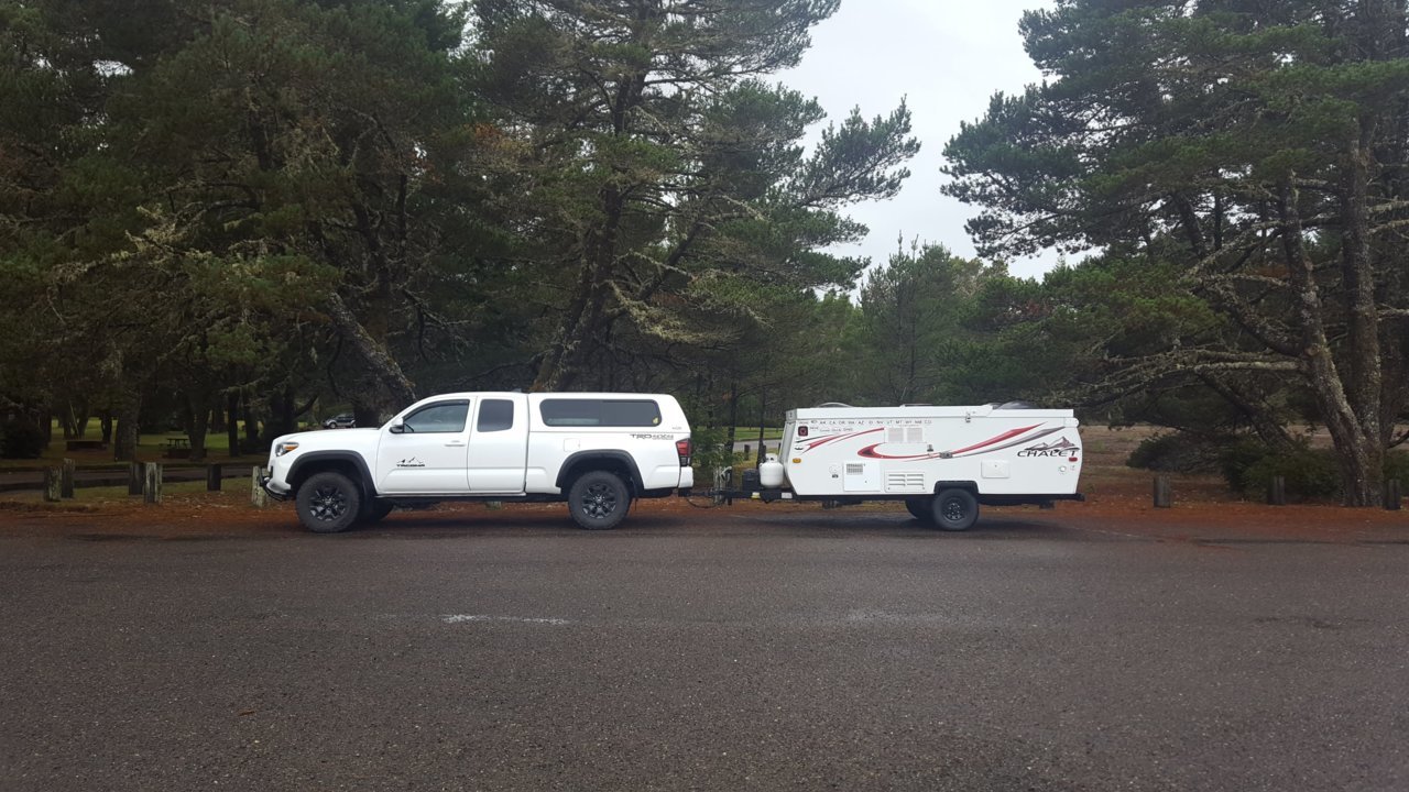

    Right on the mark .Glad to hear about your decision and results .My exact experience. No desire to lift. Just helps the sag from trailer tongue weight. Considering the weight /arm, the potential moment can be huge. 20181121_134455.jpg
    280lbs tongue weight.
    PLUS:
    Snugtop canopy , 100lbs of dog , folding recliners , tools , etc.
