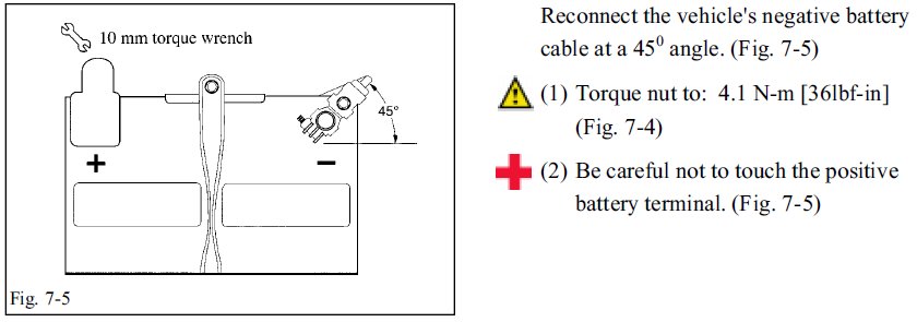

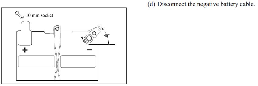

    Every instruction printed by the dealer on electrical work has this:
    and when done, this:
