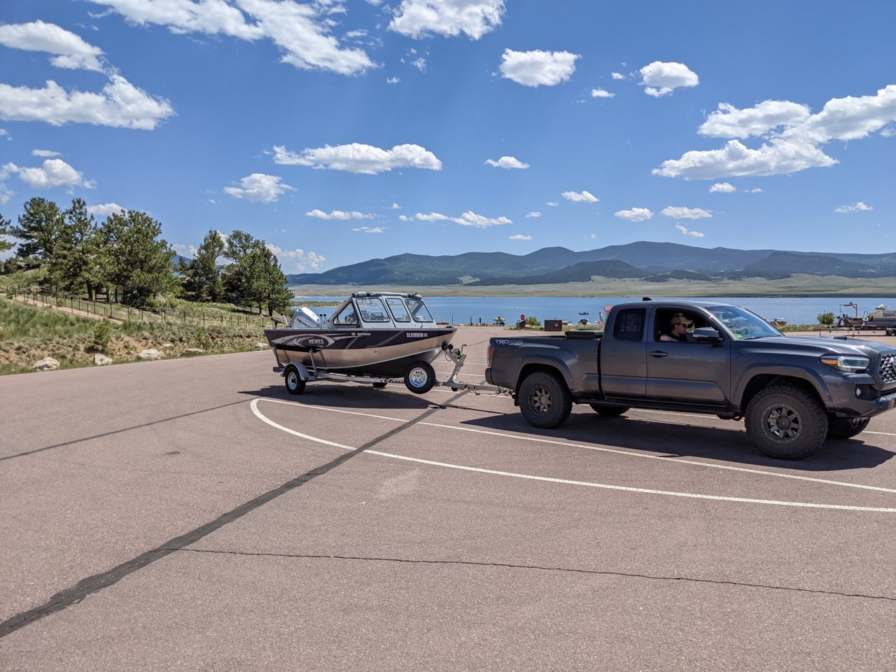

    I towed my boat 140 miles today starting at 5700', going over a 9500' pass and ending up at 8600' and averaged 14.6mpg. The truck is still quite underpowered at low rpm, if you aren't above about 2800 rpm you'll need to downshift for any kind of measurable acceleration. Below 50mph most hills need 3rd and sometimes 2nd gear to stay in the power band and maintain speed. Around 60mph you start to be able to get away with 4th and sometimes 3rd. Once you downshift you have plenty of power to accelerate easily up the hill and exceed the speed limit but the next gear up drops you out of the power band.
    My boat/trailer is 3000lbs and has a big flat front window which I'm sure doesn't help aerodynamics at all when towing.
