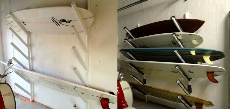

    I'm thinking about drilling in pvc pipe along the side to create something like this w/ only one holder. Not sure how I would go about attaching the pipe to the shell

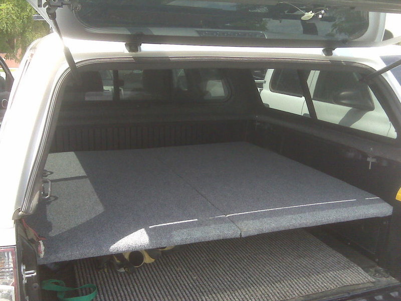

    then do this and store boards underneath... 6' 4" will still fit diagonally.IMG00140.jpg

    I've considered this but I actually do a decent amount of landscaping work and I use my truck transporting alot of the supplies that would not fit if I had this setup. I do really like the idea down the line.

    understand. It's tough to find that magic combo of function for all types of activities/work... it's like a mobile locker room slash storage shed. But it's easy to take the platform in and out... 2 2x6 boards for the cross braces in the cutouts of the bed, and two pieces of 3/4" ply for the platform. none of it gets fastened.

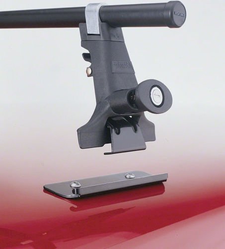

    I suggest you drill through the top and hang the boards inside from the roof of your camper with some sort of bracket/carrier
    I mounted Yakima carriers on top of my shell by drilling through.
    You may not like the sound of that but with silicone sealant and oversized washers that reinforce them,
    I have had no leaks for years now. They have taken a lot of stress under load.
