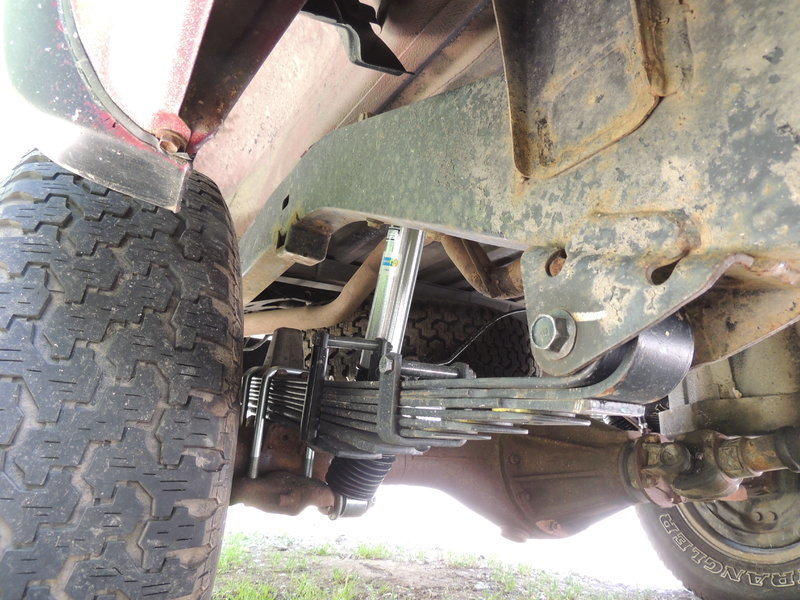

    Well lots of options out there for sure. IMHO it sounds like the OME suspension would fit your needs/desires.
    My rig second day out on Schafer canyon rd, Canyonlands:875EA034-A3D7-4B0B-8B93-5DC88EB642AC.jpg
    and after the first stage of my upgrade:
    I can’t comment on the Nitrocharger shocks as I went with Bilstein 5100 and OME 883- ARB bumper and winch in the future-up front then added them on the rear a year later during the second stage of the suspension upgrade. I carry a fair bit of weight and drive a lot on gravel roads, so I went with the OME Dakar exp leaf pack with the AAL, and greaseable rear shackles:5447F7A7-097E-4276-840F-CE4B2247001B.jpg
    Added the extended rear brake line while getting the rear wheel cylinders replaced. Then found the old Ranchos (no idea what model very rusted) to be limited-upper-out and went with the 5125s aft:
    I personally don’t have any experience with the Ranchos, but I think you will like how the OME springs ride, maybe the adjustable Ranchos would make a good combo.
    How the truck looks now with about 300# on board- after about 3-4 yrs with this suspension configuration:1B7BDF5E-F007-4BD5-963A-B43556A88838.jpg
