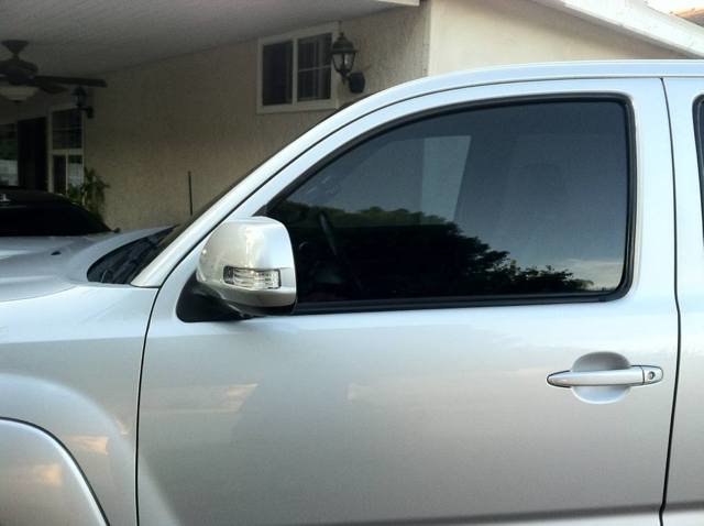

    looks good...i did the same on my 08 sport
    i just got the 4runner ones tho ;)
    BassAckwards likes this.

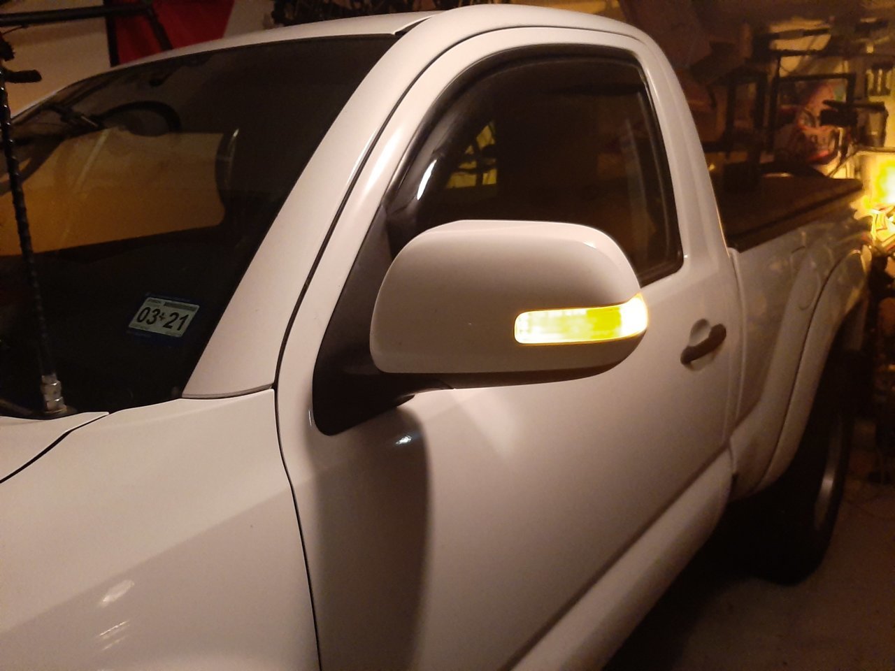

    Thanks for the excellent writeup.
    My Taco is a 2012 ACLB PreRunner (no SR% package) and was not pre-wired in the doors (came without power mirrors).
    Made up a couple of 5-wire WeatherPak Delphi harnesses to hook the mirror into the door. Re-terminated the mirror end with mating WeatherPak connectors.
    Pulled the loom to the inside of the cab and used Sumitomo female crimp connectors to tie into the cab wiring.
    :confused:Toyota used larger female terminals on the drivers side vs. the passengers side - luckily i had a few of the smaller size.
    Had to run One wire to the knee panel fusebox for each signal. Tied those in following instructions from this Post: http://www.tacomaworld.com/forum/2nd-gen-tacomas/233340-turn-signals-independent-drl.html

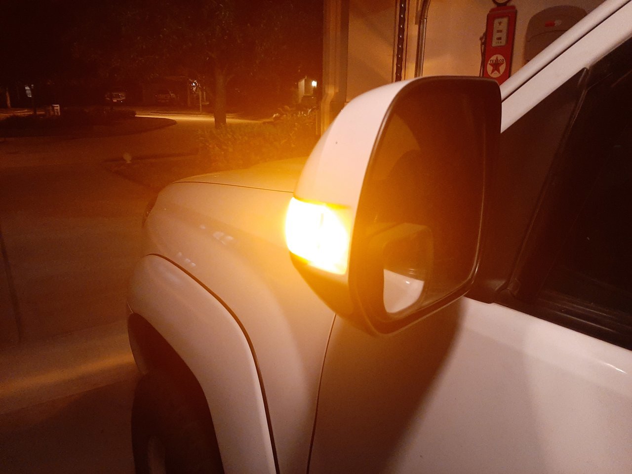

    Gave up on junkyard and manually ran wiring for my blinkers back in April.
