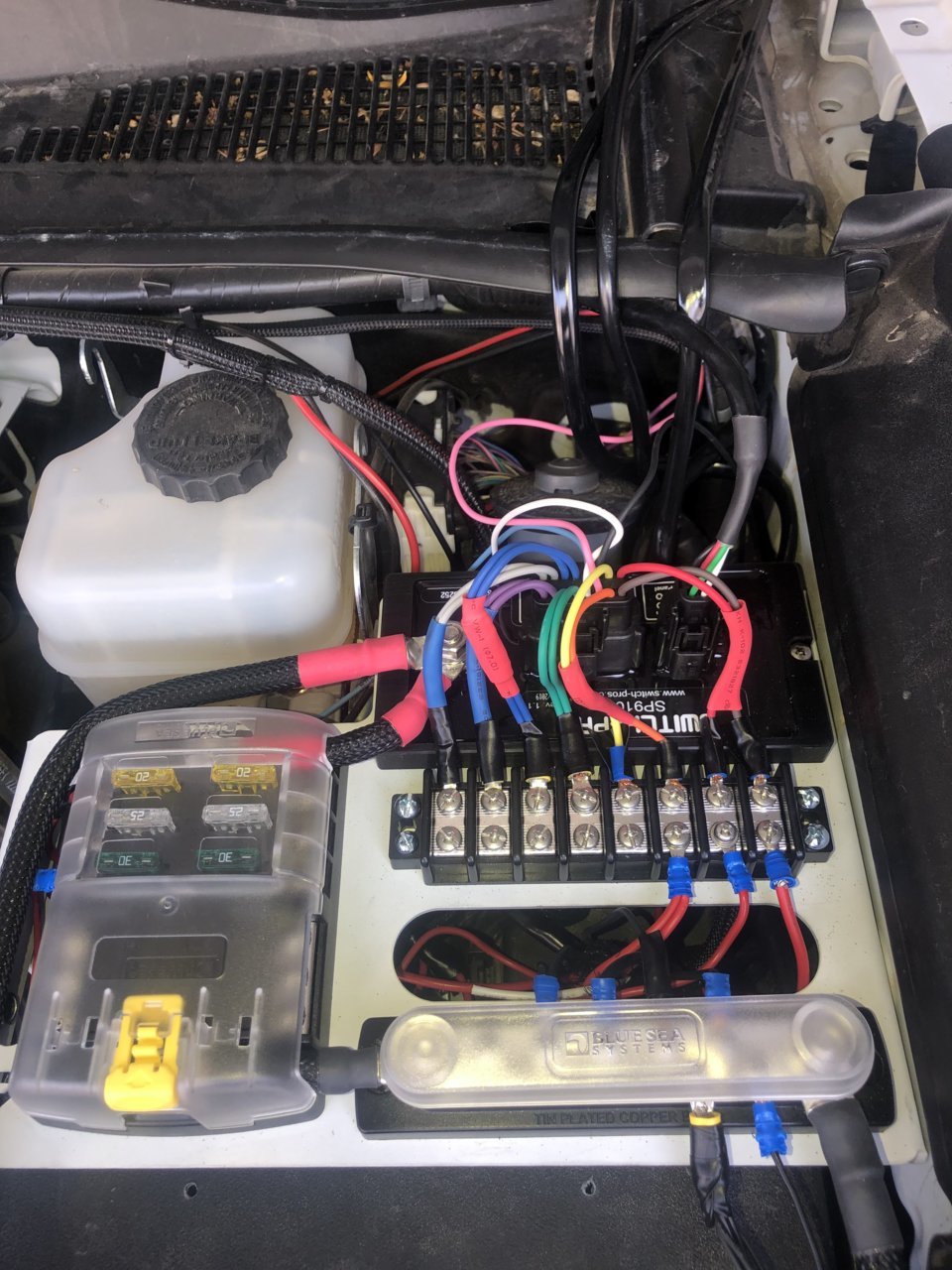

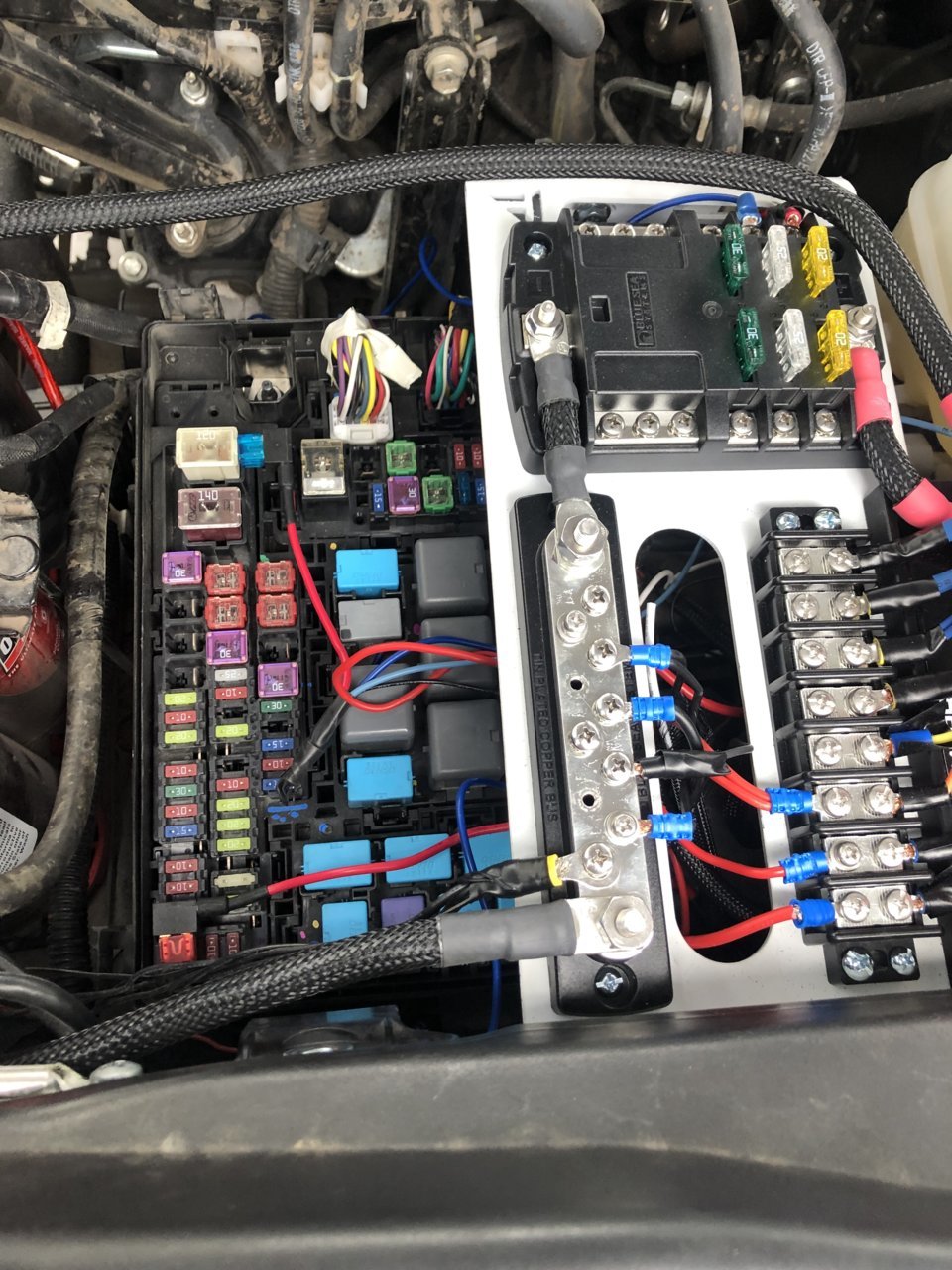

    Mine sits right behind the clutch reservoir
    I was gonna do a power tray but you want the switch pro vertically mounted and this works well. I’ve never had an issue.
    The programming is a nice bonus on top of the other advantages. You can also configure flashing, memory, startup, etc.
    It’s well worth the cost IMO. I won’t do electrical without one ever again.

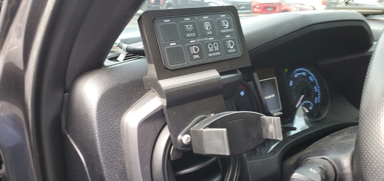

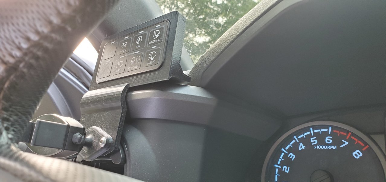

    Just a feeler, is anyone interested in this mounting solution for the Switchpros panel? Uses the unholey vent mount for mounting. I chose to go this route because I didn't like having to take my eyes off the road to hit the switches in the cubby area. The steering wheel blocks the view a bit. Been using it for 8 months or so since my install and really like it, as opposed to some of the alternatives.
    I figure its not for everyone, but if anyone is interested I could print off a few.

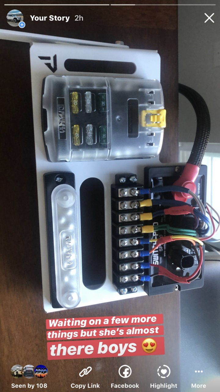

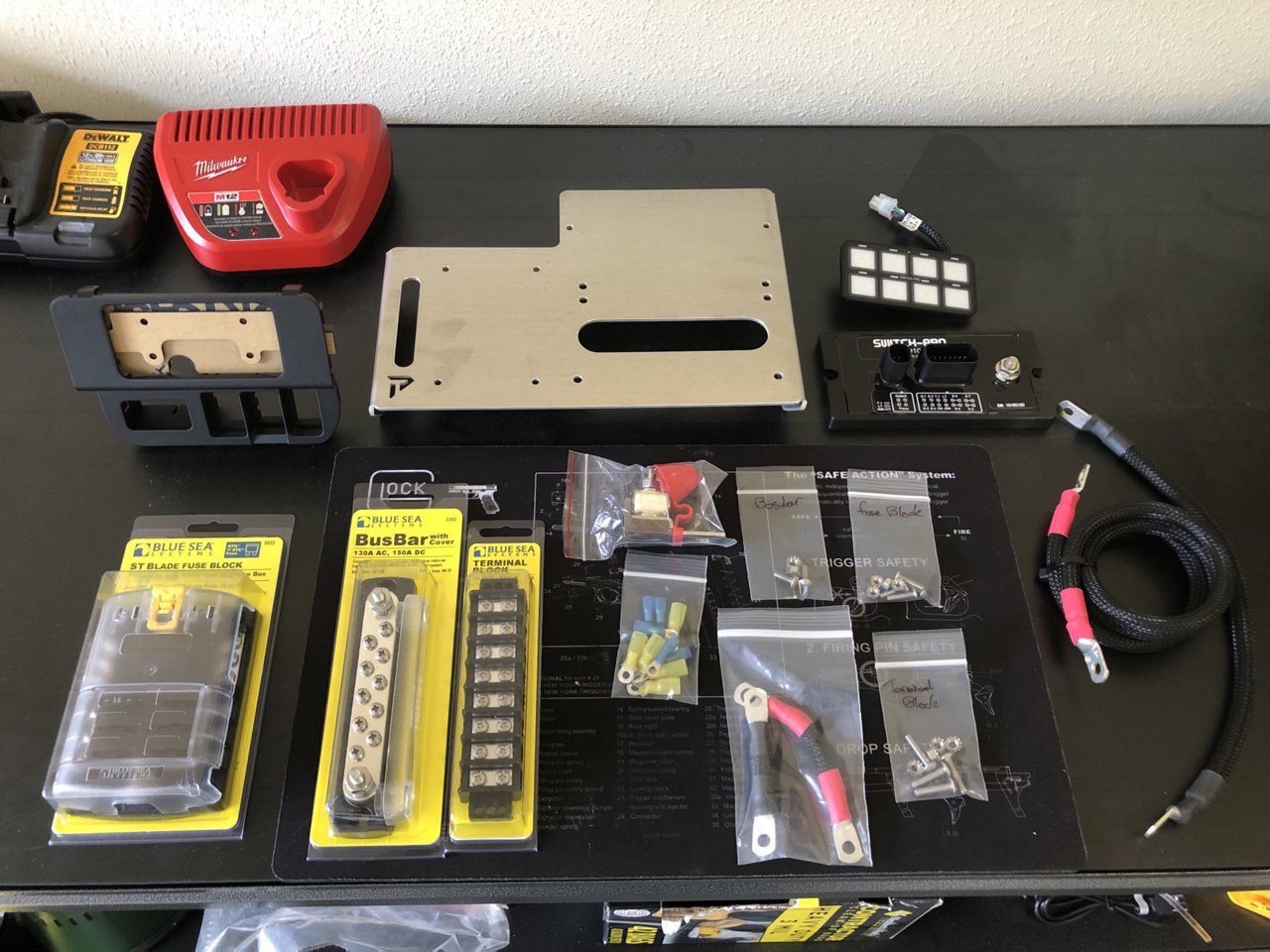

    Finally got my set up in. Going to be working on it this week , and installing it this weekend. I’m super stoked.

    Out of curiosity where did you get the baggie of ring terminals? I've needed to get marine grade ring terminals for my wiring but they come in packs of at least 25 and I really only need 10-15. Thanks.
  9. Sep 22, 2019 at 2:23 PM
    #609
    Frsh2df
    Frsh2df Well-Known Member
    Jun 7, 2018
    #255772
    1,504
    2017 MGM TRD Off Road 4x4
    I got them from Power Trays when I ordered most of what you see on the table minus the switch pro.
    When I added the items to cart it had a option to add hardware to the order.
    I’m not sure if they offer it separately or not.

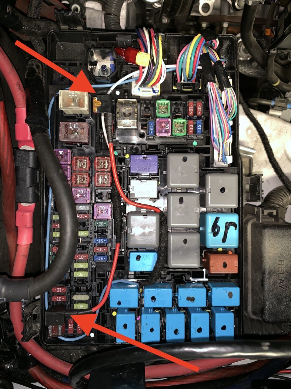

    So we finally got the switch pros installed and they looked good and they function well! The only issue I’m having is-
    When I start my car or drive around my switch pro buttons don’t work unless my phone is turned on and have the switch pros app open and then it’ll work! Any suggestions on how to fix this or what the possible issue might be? @Gunshot-6A helped me with the install and did a KILLER job!
    Thanks for your time and responses

    I had the same issue, and found that it is due to a incorrect fuses that I had tapped into - the Light Blue Ignition wire and White T2. Go into your fuse box and change it to these two fuses:
    Light Blue Ignition - fuse tap into the Injector Fuse
    White/T2 - Right Low Beam
    This page in the manual explains these three wires in detail (Light Blue, White, Pink).
    https://www.switchpros.com//wp-content/uploads/2019/03/SP9100-Rev1.2-Directions.pdf
    Here's where I found the proper way to tap into both fuses.

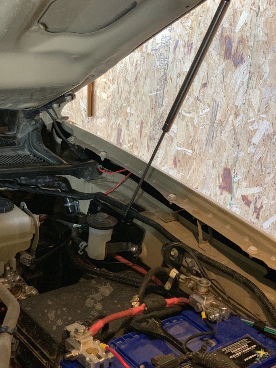

    I’ve gotta wire up mine one of these days. I started to disassemble the harness so I could pull out the excess for the air lockers and pressure switch.
    I think most people just slap it in as is and leave all the extra garbage in there.
