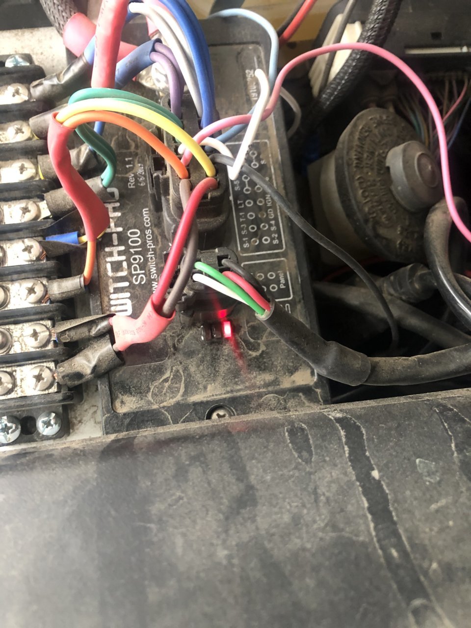

    Does anyone know why my IGN light is on? It’s been on for awhile now ever since I installed it but it doesn’t affect anything because all my lights are turning on etc... any ideas or issues? Should I worry about my truck catching on fire

    Really. It's normal. Tells you that you have the powahs! Now go fight Skeletor!

    It means you have the ignition wire attached to an always-on circuit. What circuit did you use an add-a-fuse or tap on?

    I also see that this was already basically answered for you back in September:
