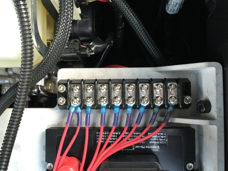

    I installed my Switch Pro to my own designed bracket. My bracket attaches to the bolt mounts on the side and down below to the wheel well. I have no vibration issues. Also I wanted to keep my fuse box free and clear for easy access. All my wiring is underneath and around my fuse box.

    Finally got around to wiring my Switchpro wires to my Bluesea terminal bar. I didn't have larger gauge terminal ends for my accessories so I will try and accomplish that tomorrow. My cables that run to my 12v outlets in my bed are 10 gauge and I'll probably mount those in switch position 1 and 2.

    It's been completely solid without the support leg! I zip tied an inline fuse which lays between the tray and OEM fuse box using the hole for the support leg.

    Newbie to this scene. I thought the switch pro is a standalone unit. Is there an additional reason for running the Blue Sea and if so what would that be. I'm planning on running all kine electrical stuff and want to do it right the first time. Mahalo

    It is a stand alone unit but there are many different ways to wire a truck depending on what you are trying to accomplish. You might use an alternate fuse panel to power other options that you do not want to switch on and off, or because you need more then 8 switches. One limitation the Switch Pro has is that it will not be able to handle multiple larger amp accessories. But you can use the Switch Pro to trigger a relay that is hooked up to the alternate fuse panel. Some TW members are running the Switch Pro alone and some are using an additional fuse panel, etc.

    I have two blue sea products; ML ACR and a terminal bar. The ACR is for my dual battery setup whereas the terminal bar is just an easy and cleaner install for the accessories I'm using with the Switchpro's. Prior to my terminal bar I had used butt connectors or solder to power my accessories, but now I don't have to continue to cut my Switchpro wires when I change accessories. Hope this makes sense!
