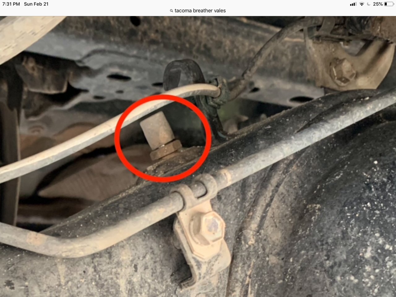

    Check your breather valves while your there to make sure they are free and cleaned

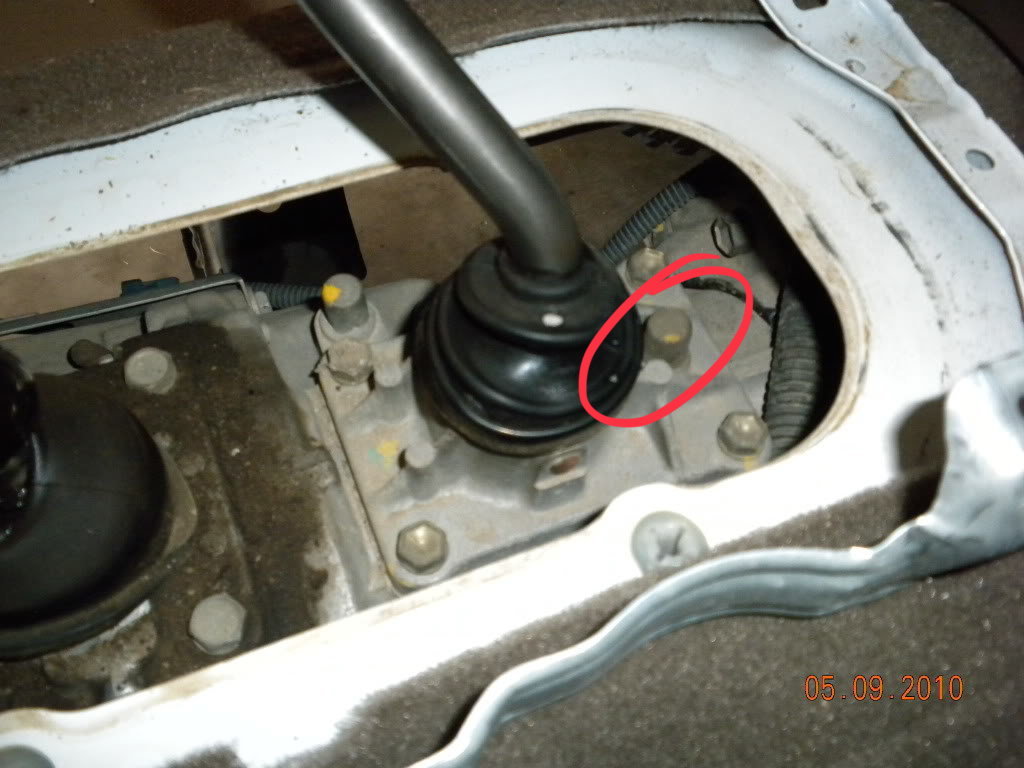

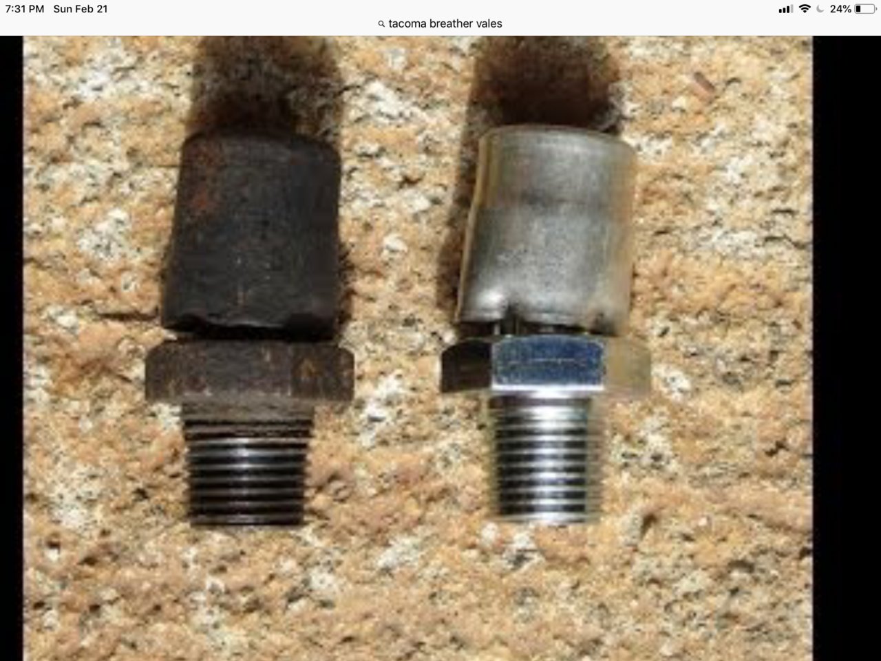

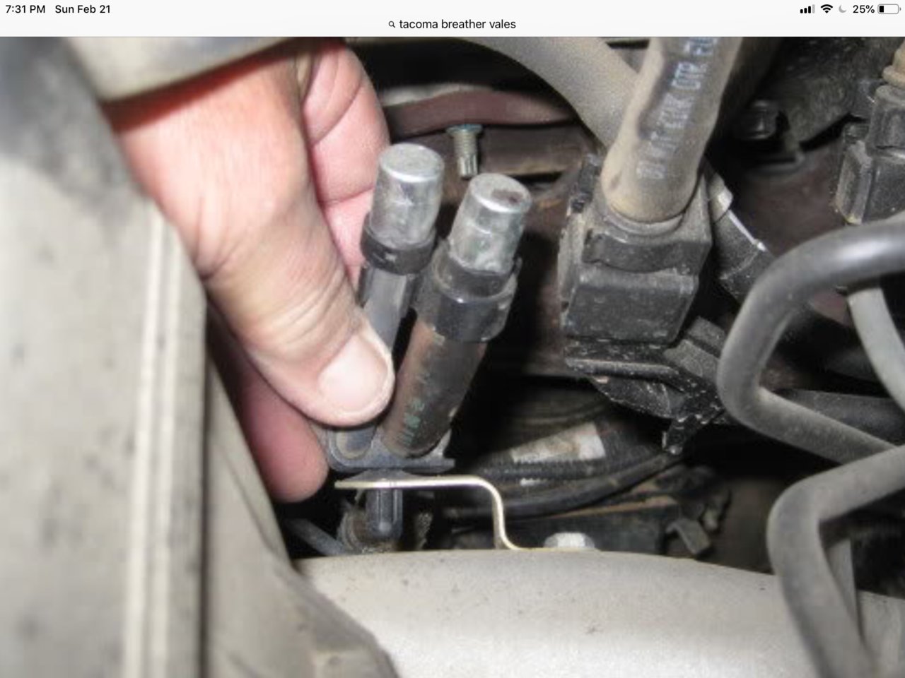

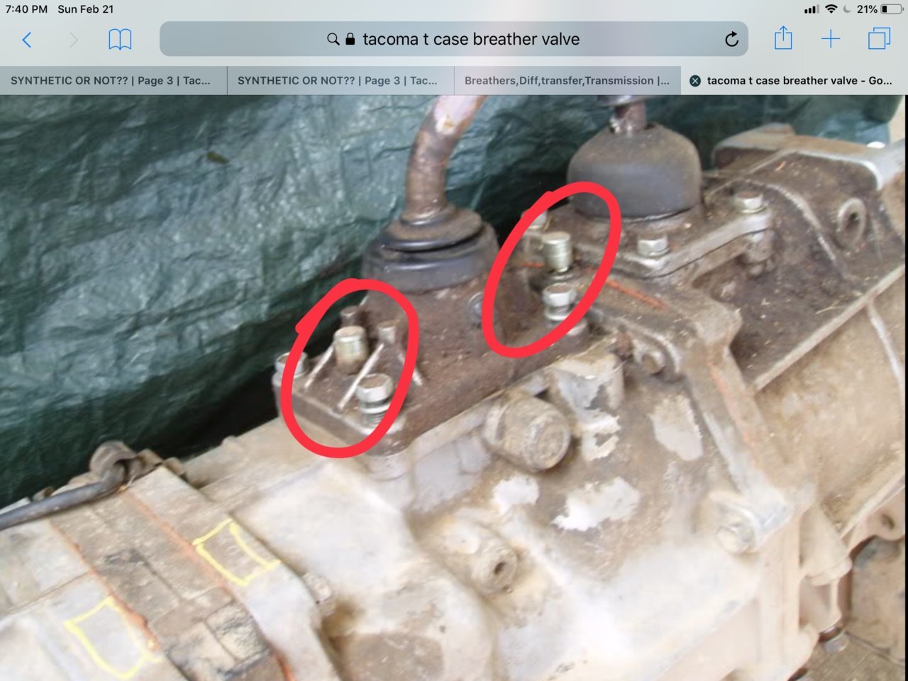

    how do I check those?

    Just make sure they move up and down easily and not rusted of clogged with dirt.
    If one gets clogged you will blow out your rear seals=1500.00 repair.
    Transmission and Tcase and both diff have one

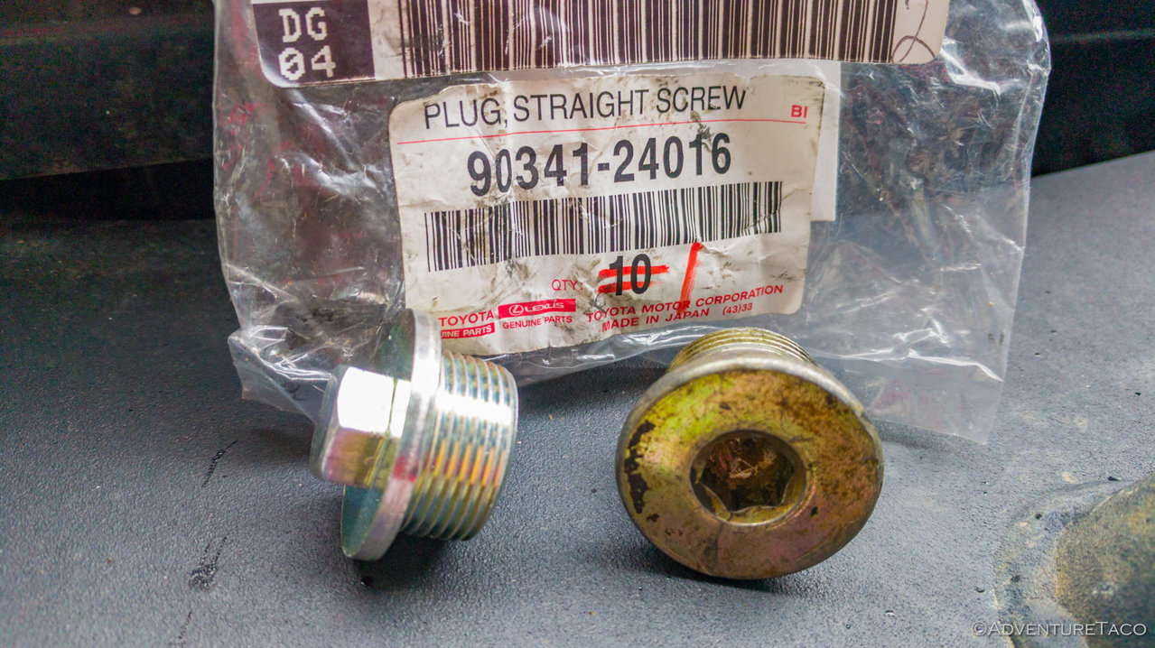

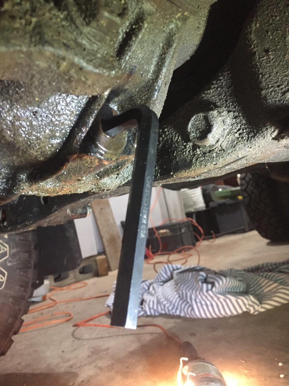

    Even though it says second GEN this read helped me a lot researching and performing all my gearbox oil changes.
    https://www.tacomaworld.com/threads/front-diff-and-transfer-case-oil-change-howto.147631/
    The front diff drain plug should be replaced with the Lexus part And I did not have much trouble taking mine out. All the gaskets and washers mentioned in the above thread are applicable to first GEN
    My differential is all wet because it’s covered in rust proofing oil
