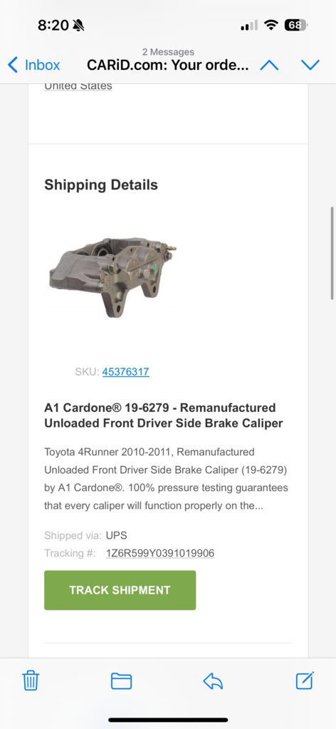

    I don't remember too much from my swap, except that I was able to figure out a way to ensure I got the 12mm calipers.
    For some reason, 2014 4Runner sticks out in my mind as being the key, but I can't be sure. I think I remember finding this thread most helpful on that - https://www.tacomaworld.com/threads...unner-bbk-upgrade-for-2nd-gen-tacomas.504234/
    TacoZim and moon22[QUOTED] like this.

    I’m pretty sure it was 4Runner brake calipers if I remember right from my swap.
    edit: Found order email from way back when.
    moon22 likes this.
