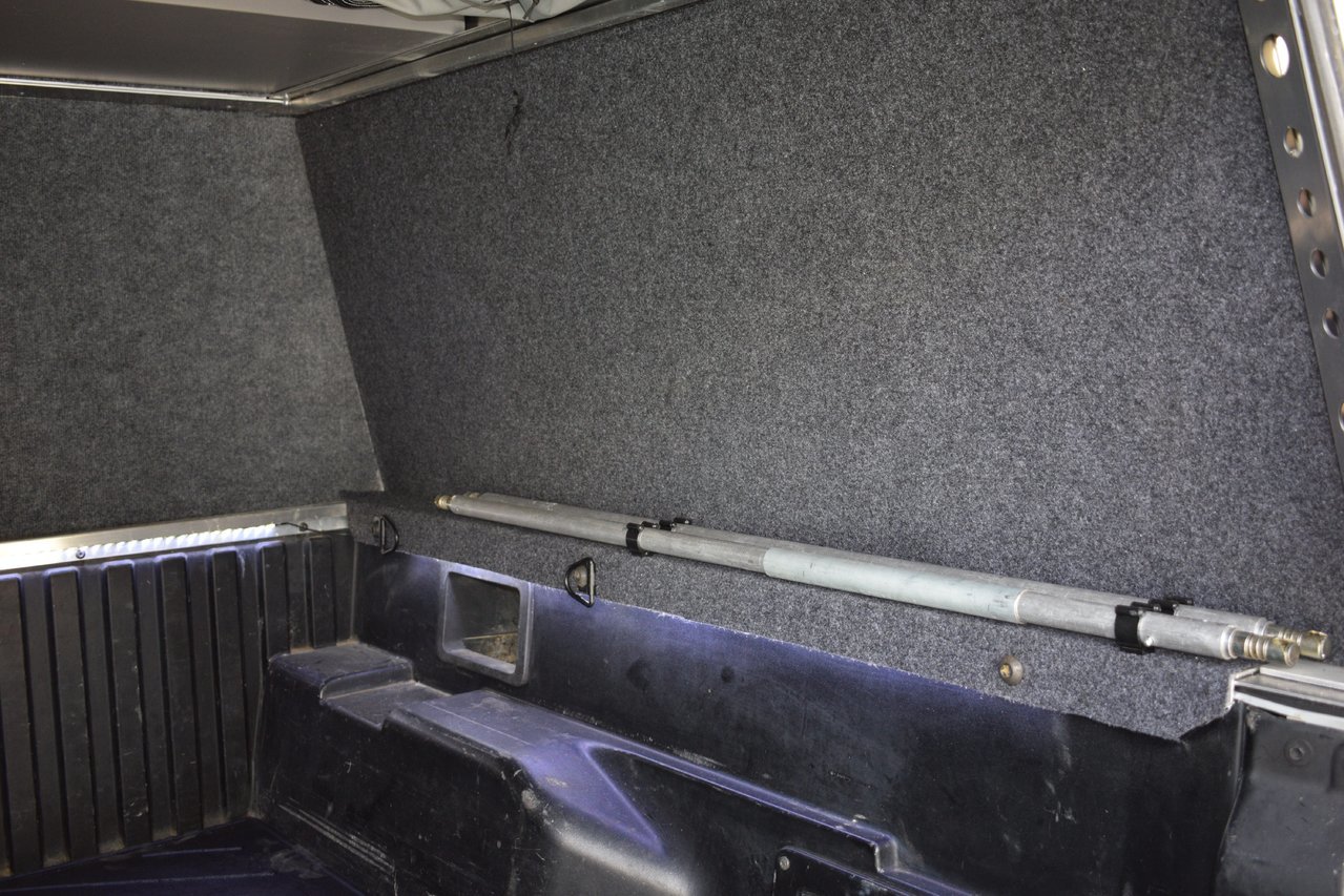

    Has anyone mounted a hi-lift in the interior of the bed with a habitat? I know there are multiple bolt-on bed rail hi-lift mounts, but don't think they'd work with the way the habitat negates access to the bed rail.

    I was going to attempt this with my AP hilift mounts. I didn't see what type of anchor was used for the habitat inside the rail. Was hoping I could just drill and tap into that. Or slip a couple single bolt anchors in between what he habitat uses.
    Anyone know off had what the anchors look like for the habitat?

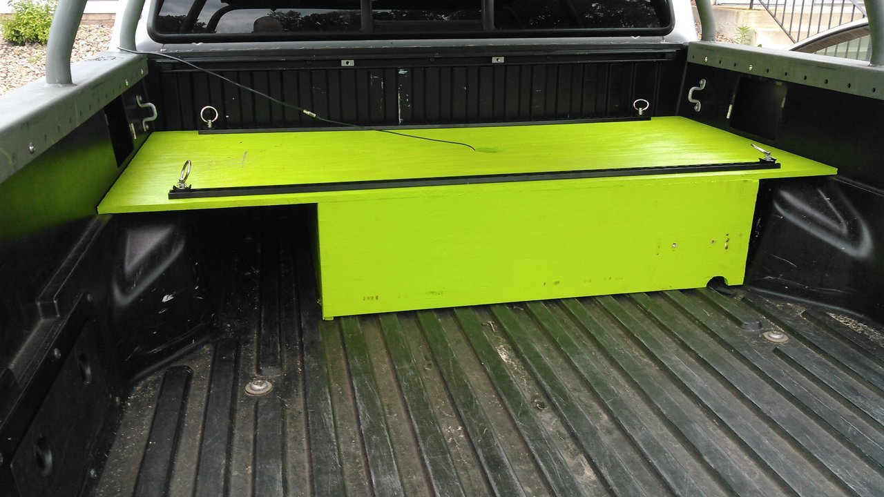

    I'm starting to plan out a new interior for my bed to replace my current test-run setup, which looks like this:
    I plan to use the same press-fit extruded aluminum framing that the pictured cabinet uses to build a sliding drawer in the same place. Then I'll also be building an enclosed fridge slide in the place where my current slide is. You can also see in the back my 15 gal water tank that fits snug with the current setup.

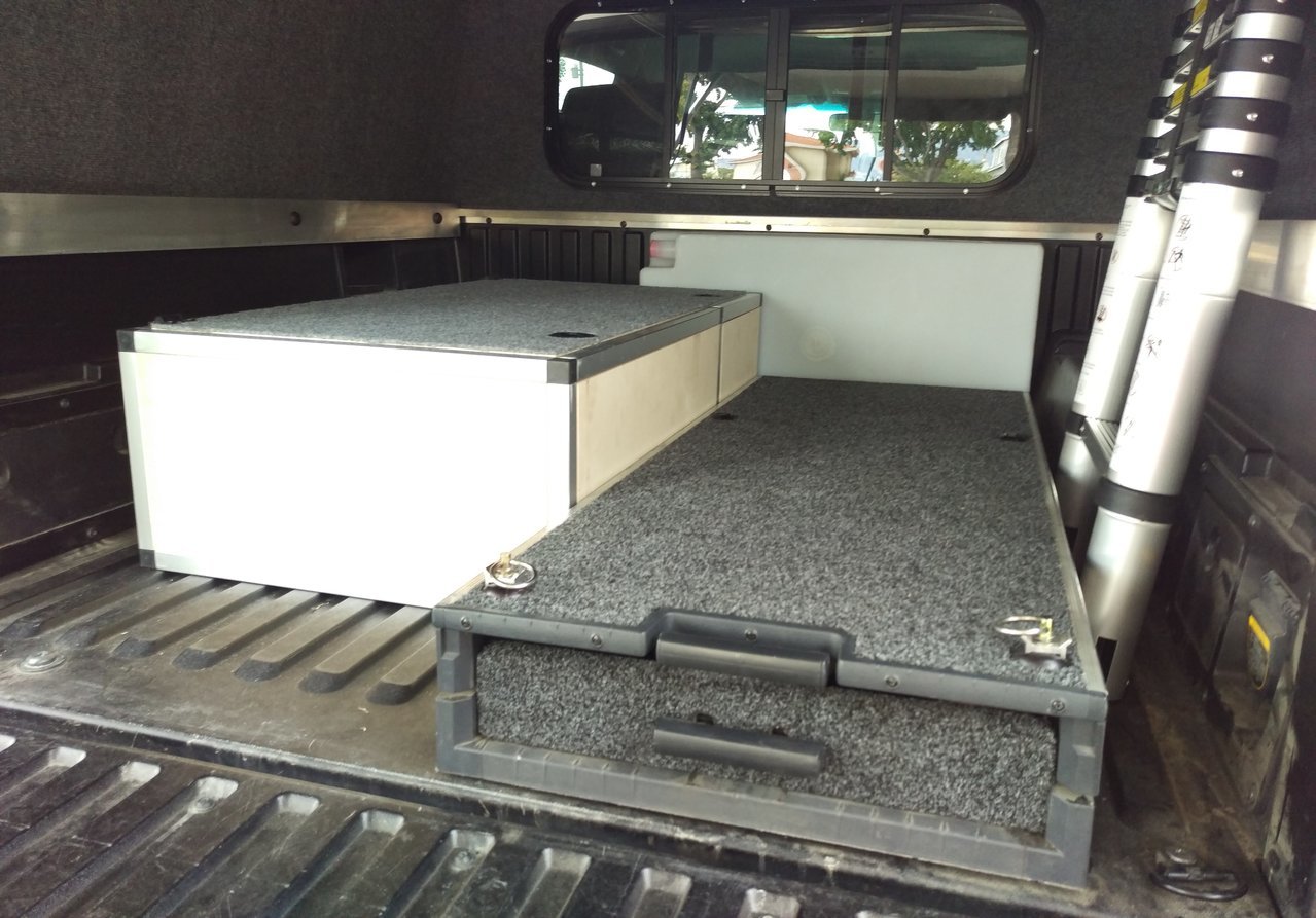

    I have a 24gal water bladder that sits on the floor of the bed under/in a plywood box that forms a shelf on top the fender wells. The left most 8" of the bottom is open and we typically stow our emergency ground tent in there.
    Right rear is our fridge strapped down to some l-track. The remainder of our stuff is in hardigg boxes for ease. I was thinking is doing some nice built ins, but I can yank the camping kit out and use the truck.

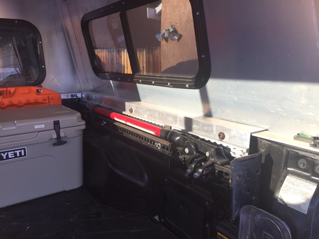

    I just started a designated thread for habitat ideas in the caps / toppers sections as I figure we are kind of clogging up the third gen forums with habitat BS.
    I posted a picture of inside my habitat and you can see how my hi-lift is mounted inside the bed (its not mounted in pictures but you can see the mount)

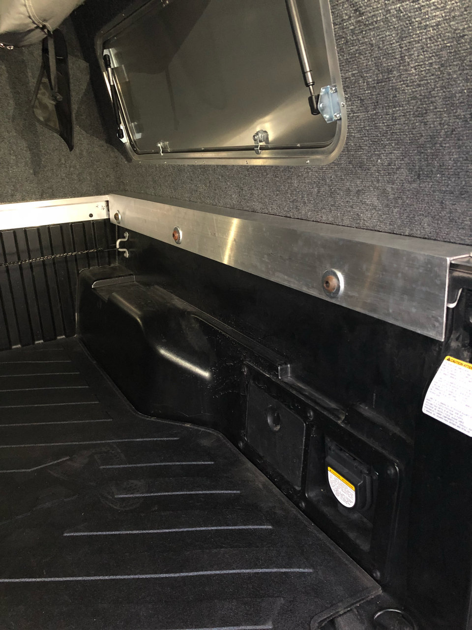

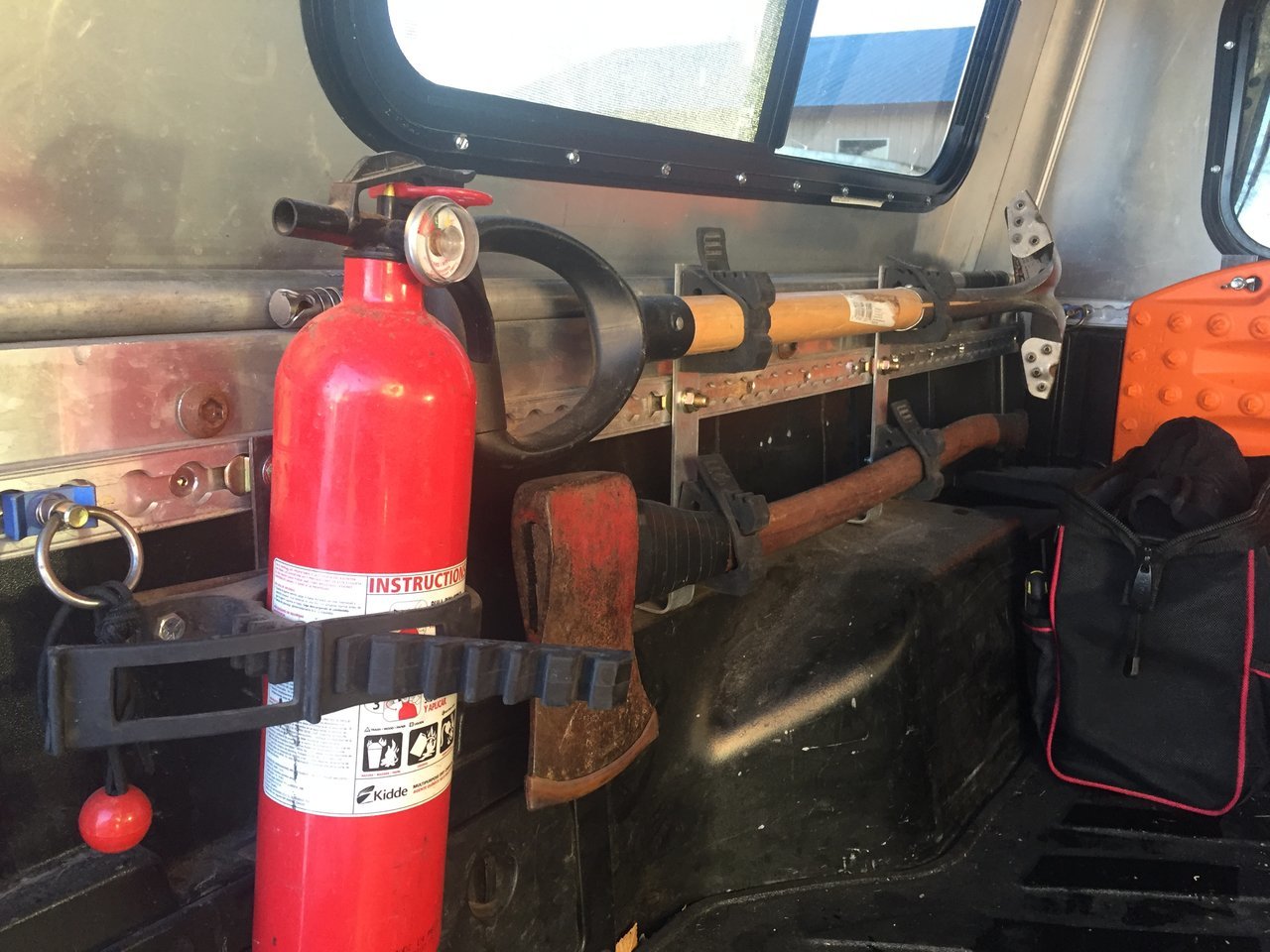

    Sorry for the glare In the photo but it’s that time of day. I attached L-track with rivet nuts and made brackets based on the BensonX design on this sight- https://www.tacomaworld.com/threads/diy-hi-lift-and-tool-mounts.260147/
    Also used the same method to attach shovel, axe, fire extinguisher and maxtrax

    Wow love this idea...what size rivnuts did you use? And what length L-track?

    I just measured the L-track to fit along the length of AT's top mounting plate. Specifically, cut to 52". I forgot to measure the rear L-track while I was outside but it is essentially the width of the bed. I aligned the track just under the large, round mounting bolts, marked my holes, and drilled using a 25/64" bit. Installed 1/4"-20 rivnuts using a tool similar to mentioned above, and it all went together pretty quick.

    I went and looked at my Habitat and mine doesn't as much aluminum showing under the bolts as yours does...I guess I'll have to put the L-track above the bolts...should still work I think
