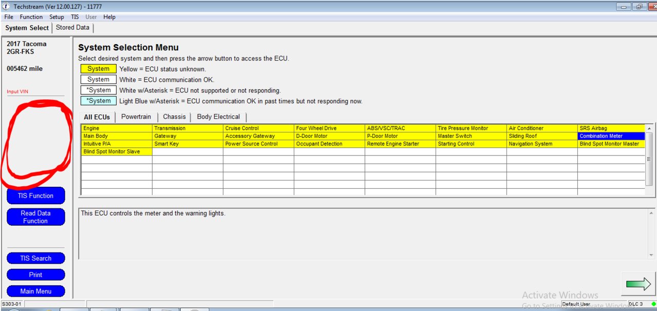

    So I was trying to follow the directions for resetting the learning this morning . The directions say to follow the menus to Powertrain/Engine and ECT/Utility/Learning Value Reset.
    https://www.tacomaworld.com/threads/2016-toyota-tacoma-v6-ecu-tuning-alpha-release.495735/page-1924
    I used this pic from a Techstream thread on TW and it shows a menu selection of Engine then Transmission . But not combo of Engine ECT to choose. This is the same thing my setup shows when connected to my truck . Note - ignore the red circle as this came from -
    https://www.tacomaworld.com/threads...-alpha-release.495735/page-1927#post-19811701
    How are you guys getting to the utility to reset the learning ?

    You need a newer version of TIS try looking for TIS 12.20.024.

    I'm pretty sure it's under the utility menu of Engine.
    Double click "engine", then once it loads there should be a blue "utility" button on the left side.

    Select "Engine" right under All ECUs, then I believe hit the green arrow and it will take you to the engine menu and you'll find the reset store values function there. Been a while since I've done it, but I think that's how to do it.

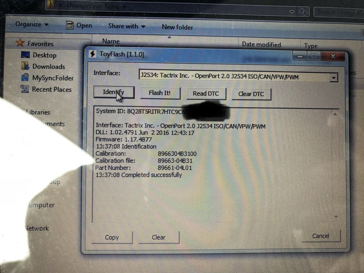

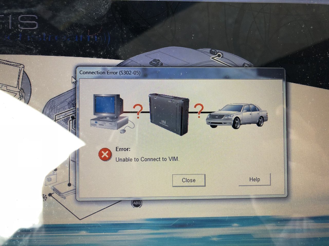

    Just tried to use the orange adapter and USB cable supplied with the tune to use with Techstream, and it doesn't seam to want to connect. Works fine with Matt's flash software though. Do I need a different driver, or an added power supply to the adapter? I'm just trying to update door lock, turn signal, etc... settings on the truck.

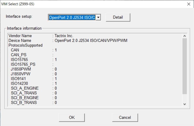

    o_O You have the Tactrix adapter right? Forget about the "orange" adapter. I'm assuming you mean the xHorce MVCI cable, or one of the crappy knockoffs. You need to select the right adapter in Techstream.
    Click on Setup > VIM Select and you should see something like this:
    In the dropdown menu select the OpenPort 2.0 one.
  16. Feb 9, 2019 at 1:40 PM

    My bad, I didn't know Mat got sweet OVTune orange ones! Mine is clear/white. Is the truck on, same as it would be for flashing? Make sure you have PCM flash closed, not sure if that would cause a conflict.

    Wicked! Thanks that did the trick :rasta:
