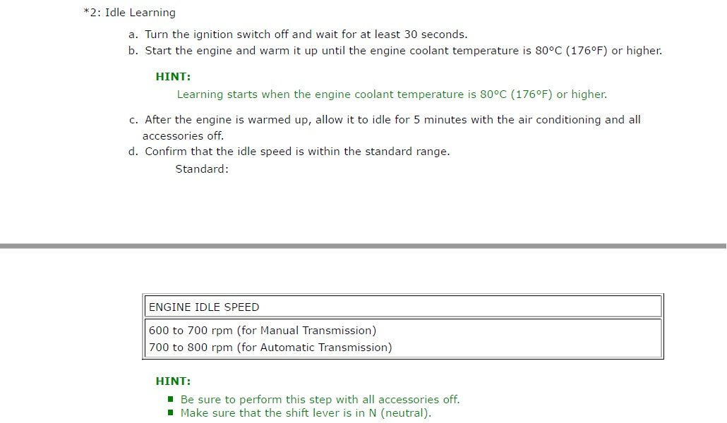

    @Vlady where are you getting this "SOP"?
    Straight from the service manual. See "2* Idle Learning:"

    Correct. You can perform the reset with both techstream or Flash Manager. I only posted that to reference the idle learning procedure after the learned values have been reset. You can usually get away without doing it, but the procedure only take 5 minutes and will prevent any unintended surging at idle.

    It's all good. I had some idle issue a while back and found the info on another thread. Sure enough, it took care of the surge.

    FYI I flashed and did the learning procedure yesterday and always ended up with a 600rpm idle on my auto, stopped 8-9 times.
    Might try again some other time, seems to run fine though.

    Mat has lowered the idle from factory, so no worries there. The idle learn procedure just making sure you get a smooth and consistent idle. Of course, you'll still get a surge when the A/C compressor kicks on, but that is normal.

    Yea I figured, idle was ~600 from what I can recall before the reset. Been smooth as silk with the tune.
