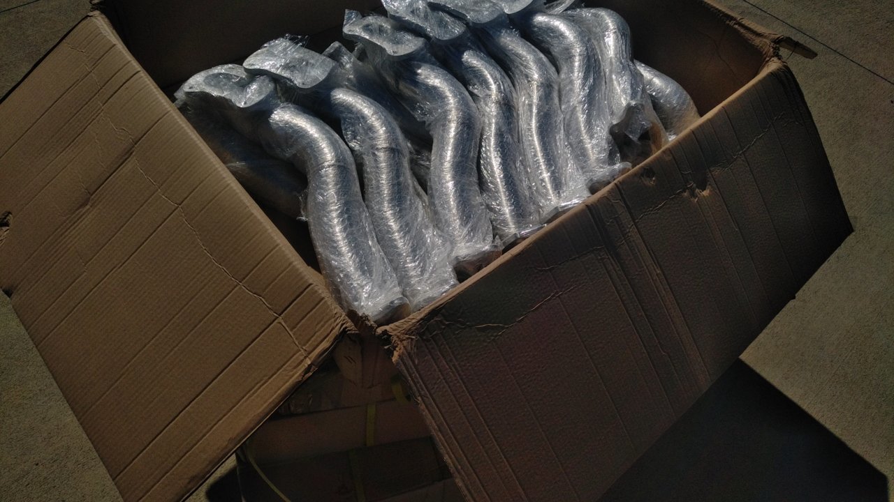

    Dump tube orders will be updated !

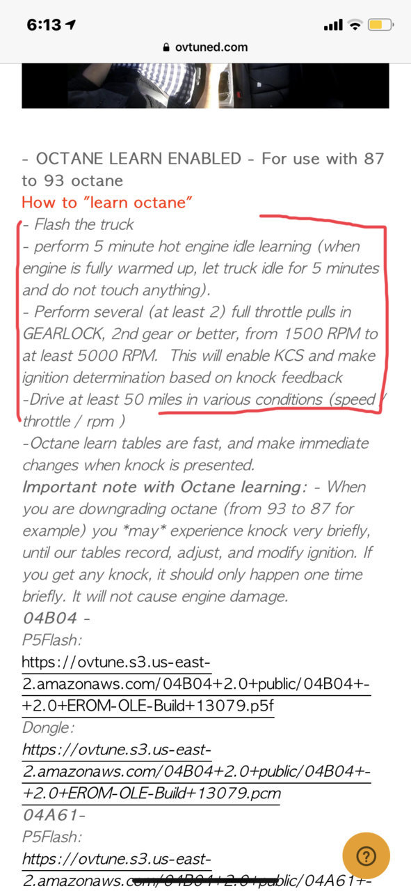

    @OVTune, with the new 2.0 beta being released later this week,
    Should we not "clear the trims" for this next release?
    When was "clearing the trims" necessary? At first install of OVTune?
    @OVTune, will the next 2.0 beta tune have octane learning?
    I take it that "full throttle pulls in Gearlock, 2nd gear or better" (as noted above) are not required unless octane learning is enabled?
    Thank you!
